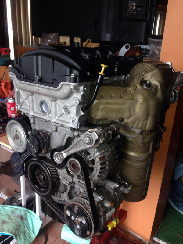

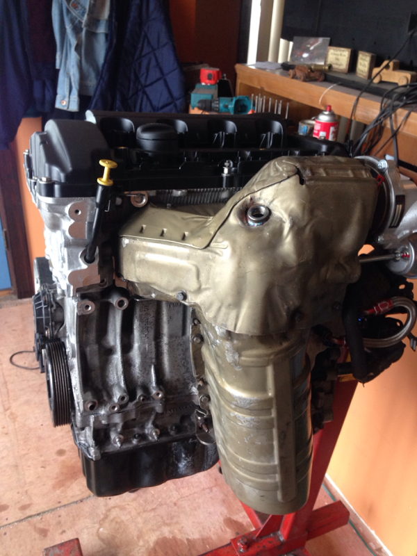

Lmao !!! Thats a good one. I think you might be right. And to make this even alittle more better. Check out my next photo. Take note how ugly those heat shields are next to that nice new turbo. ALL I DID WAS REPLACE TO TURBO !! Thats my story I'm sticking to it.

Posts: 1,029
Ugliest heat shields I've ever seen.

Joined: Jun 2013
Posts: 1,029
bone stock !!

I think it's a pretty good sleeper. Ugly shields and all. Its just a JCW turbo. HONEST !! Trust me !
Hehehehe

Ceramic coated the shields eh? I was thinking of doing the same.... minus the "JCW" turbo
Yeaaaa i coated those awhile ago. Wish it was fresh. But I'm out of coating material.
