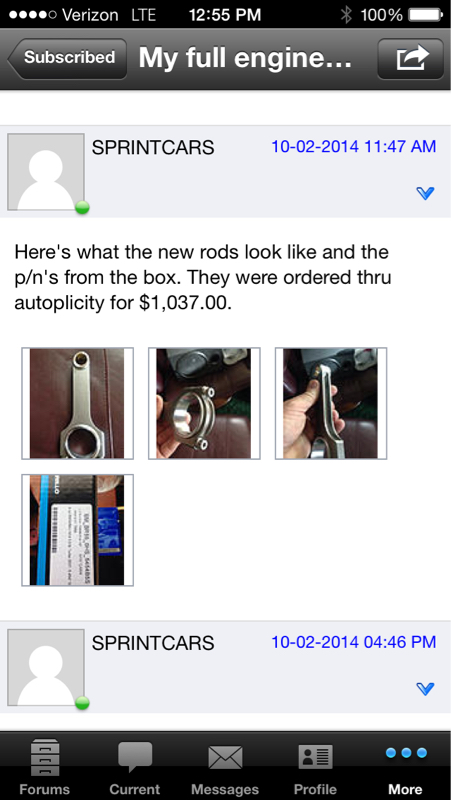

Did you install new rods as well? Brand?
Old Apr 1, 2015 | 09:55 AM
  #303
SPRINTCARS's Avatar
SPRINTCARS
Joined: Jun 2013
Posts: 1,029
Carillo

Can you send me the brand, p/n, etc. I can't read any detail off of the pictures. Thanks.
Old Apr 1, 2015 | 11:35 AM
  #313
SPRINTCARS's Avatar
SPRINTCARS
Joined: Jun 2013
Posts: 1,029
Go to page 5. Second post. You'll be able to expand that. They are 1000-1200 bucks.
Look at pauter. Little cheaper and lighter
