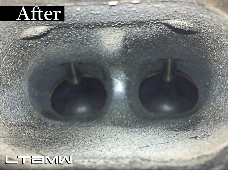

Here's a port job, looks like a golfball.

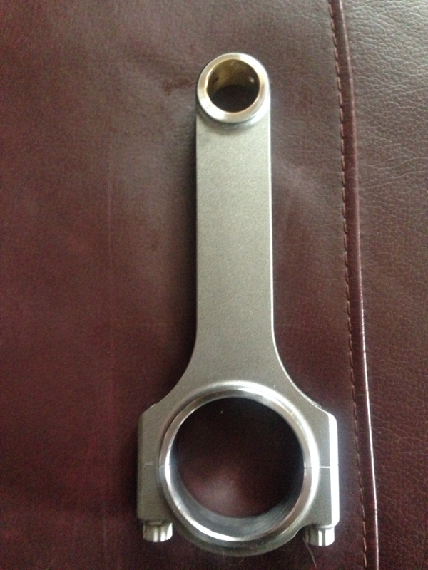

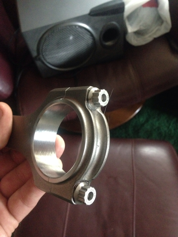

Here's what the new rods look like and the p/n's from the box. They were ordered thru autoplicity for $1,037.00.
