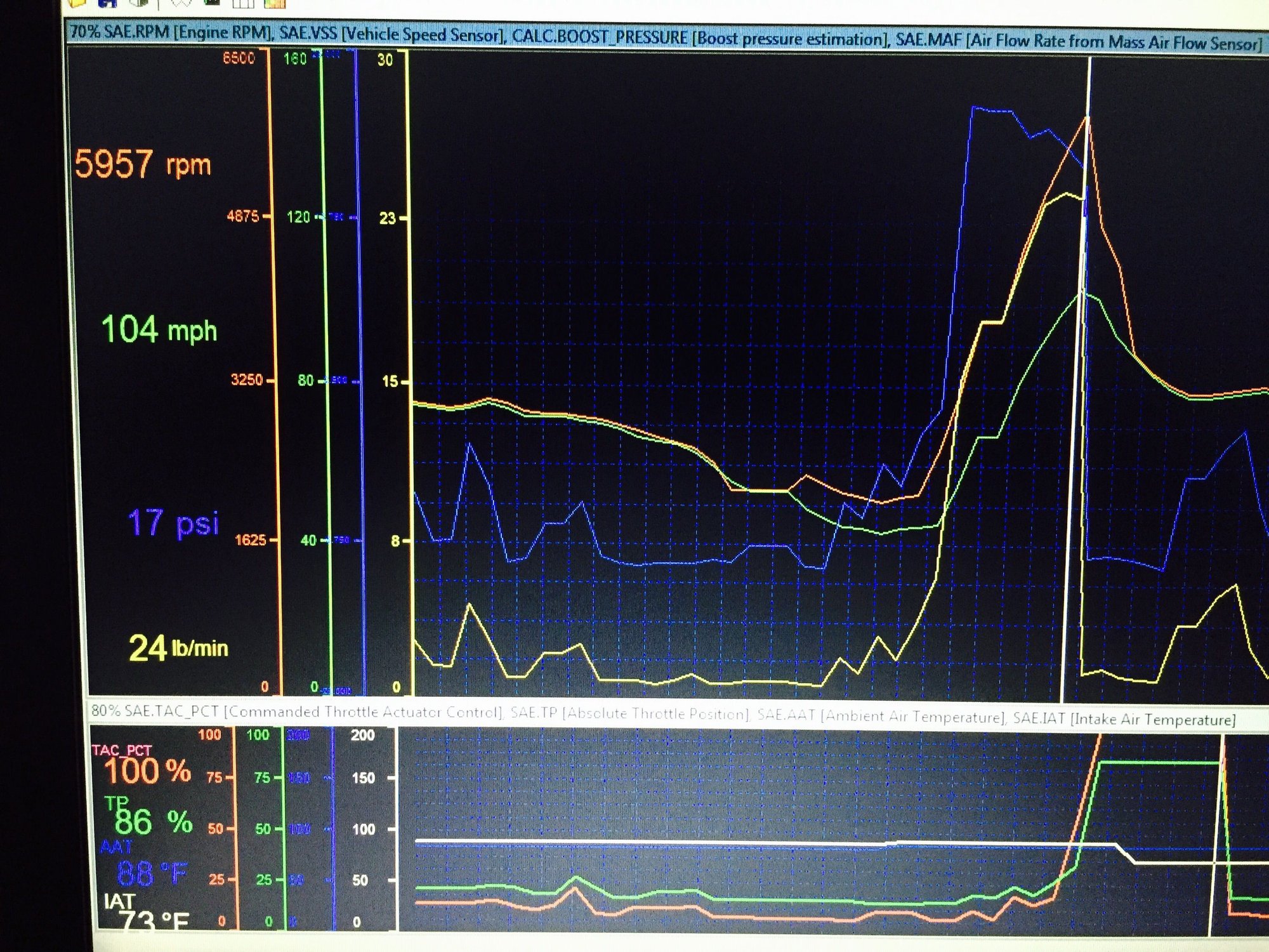

I think the first thing is to test the MAF. Sprintcar showed a flat line at 25 lbs... Now is that the max the MAF can flow or is that the max the turbo can push ? Until we figure that out we can't say the chicken or the egg yet !!
If anyone has a log with higher than 25 please post.
Would anyone with a JMTurbo 45, or oldbrokenwind with his beast turbo have data showing a flat line at 25 we might could say it's the max of the MAF .
One thing as well is Sprintcar has a flat line but his boost never starts to fall, does that mean the turbo is not out of breathe and the MAF IS maxed out ??
Hmmmmm

Well I wanted to post a 4th gear punch showing my stock turbo, manic 2+ .
I found a crack/cut/rip in my stock turbo inlet tube. I'm running M7 AGR intake .
Well I ordered the JCW inlet tube in order to support the Owens that I'm hoping to have in 3-4 weeks.
My MAF seams to be up looking back at some old logs with the factory tube.
Most where 21-23lbs. Now I'm not sure if there was a rip back on those logs but 2-3 weeks ago I changed my go fast bits DV to a stock one as a test. I didn't notice the rip then but was not looking that close for it . Anyway.....
I still think 25lbs is max for the MAF.
Can anyone post a higher MAF log ?
Thanks guys

The most I've seen while logging my own as well as customers vehicles (Stage 3+/Stage 4) is 25 lbs/min. If the MAF is disconnected you will read 40 lbs/min. This would lead me to the conclusion that while the system can read that high our MAF's are not designed to provide a signal in excess of 25 lbs/min.

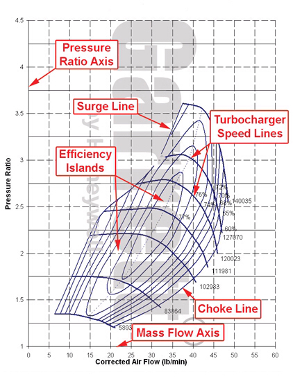

You want it to fall in the center oval towards the right side or just into the next oval. Here's a compressor map so people know what I mean.
Just my opinion.
Just my opinion.

That's just an ordinary graph. That's not the owens. You gotta ask for it. I was just making a point as to were you should be on the graph relative to the horsepower your looking for. And you gotta keep it realistic. What are the cars capable of ? You can get 350 out of them if they are tuned properly and the right head cams and turbo. And other parts of course. Anything at 350 and up, the timer is really gonna have to be standing at the car to tune it. Unfortunately we don't have any tuners who are willing to sell there software so we can get serious with tuning our cars here in the USA. Sure would be nice if a certain tuner would allow that to happen. He's gotten so big now that waiting on tunes is alittle timely. Atleast he responds to emails unlike that CLOWN AT RMW, of course as we heard and seen, he can't tune certain builds because of the way his software is anyway.
