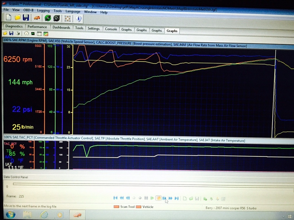

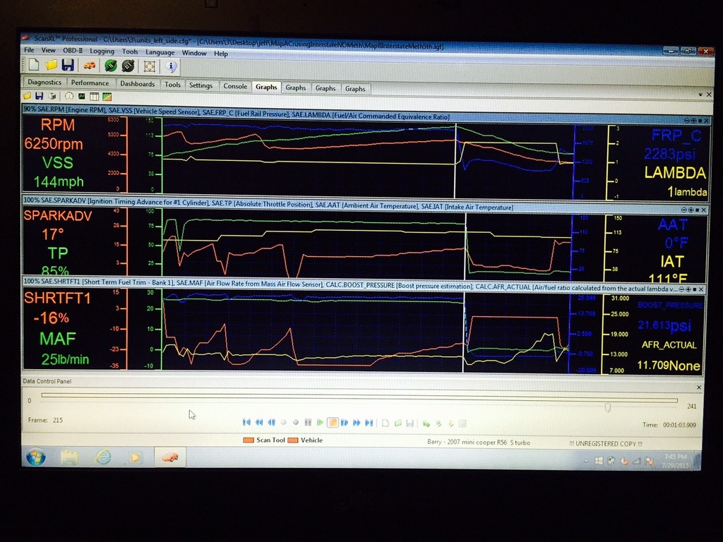

Old Jul 29, 2015 | 08:35 PM
  #537
ridinDirty's Avatar
ridinDirty
Joined: Dec 2013
Posts: 507
From: Vegas
Above looks like a 3rd gear punch by the 3 dips in rpm, the interesting part is the MAF. jumps right up and is a live trend ( not flat lined) till the rpm's get to 5100. Then I'm not sure if the MAF is maxed out when it flat lines due to Jeff's head and cams coming in to play or the turbo running out of breath..... Would be nice is someone could post a trend showing MAF higher than 25 lbs.
Above is the same run just putting the tic mark at the end of the run.
Nice mph on a closed track with safety crew on standby......lol
Note on this one is Jeff was coming down from 35 mph to 25 mph ,IAT was 97 deg , throttle was 17% to 21% open for 36 seconds, at that time IAT had dropped during that 36 seconds to 86 degrees before the foot hit the floor. The run lasted 23 seconds, from 34 mph to 144 mph. IAT started at 86 and finished at 111 deg F. 2 seconds later IAT was 102, would have been nice to see a little bit of a cruise to see how longer the Wagner took to cool down....
I hope some other fellow mini's can post some trends, would be nice to have something to bump to with the same parameters so we can all learn....

That was awesome ridindirty. Thank you so much for posting and the explanations. I'm gonna be doing a data log again since I made a few mods. ( eyes rolling and whistling ) I'll get that cool down for the intercooler so you can see how well it cools down. I think that Wagner cooler was a really good investment tho.
And folks, on a 95 degree day. IAT at 111
I ran he car at Cecil county dragway in Maryland. I left it in normal shifting mode, no sport mode, traction control was still on. The car totally shifted on its own and I only pushed the throttle til it hit the bump. Did push it to the floor Map B ( 22 lbs of boost I think/1.5 bar) let it shift totally on its own. And methanol was on.
Car ran 13.4 @ 104 mph
The first pass straight off the interstate when I got there was 13.5 @ 106 mph.
