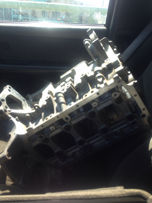

Now to get it on the engine stand and figure out which bearing go where and get those on order. Then figure out what spec for the main studs.

Do you have an engine block riding shotgun? Lol.
