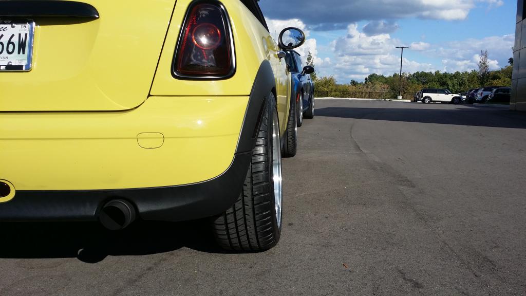

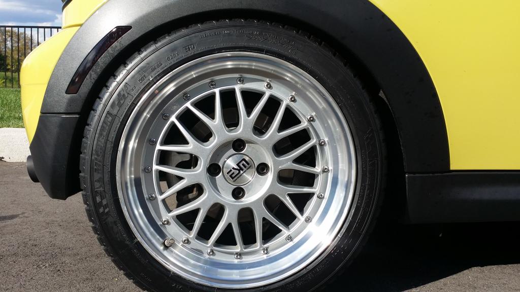

17x8 et35
Picking up some esm 004 this week. Just on NM springs. Looking at either 225/45 or 235/45. Will they fit without rubbing..read through this twice did not see anyone running this.

i got 225/50/16 on tein springs. the front is 100 perfect but the rear gets a little rub here and there. i got 16x8 with 20 offset. r53 hope this helps you out.

I should be good then Thanks for the reply.

17x8 esm004 et+35
Michelin as3 225 45 17
Minor rear inner fender liner line scrub Name:  20140927_170507.jpg
Size:  112.1 KB Name:  20140927_155510.jpg
Size:  92.7 KB Name:  20140927_155458.jpg

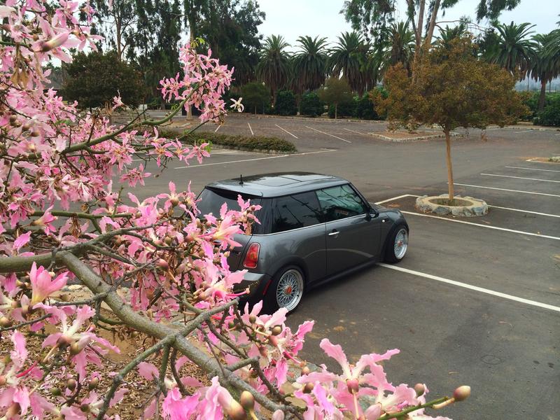

  #875
Villared's Avatar
Villared
Joined: Feb 2014
Posts: 7
From: Riverside CA
16x8.5 +25 offset
Attached Thumbnails Roll call - 8"+ wide wheels-img_4590.jpg   Roll call - 8"+ wide wheels-img_5181.jpg   Roll call - 8"+ wide wheels-img_5183.jpg
