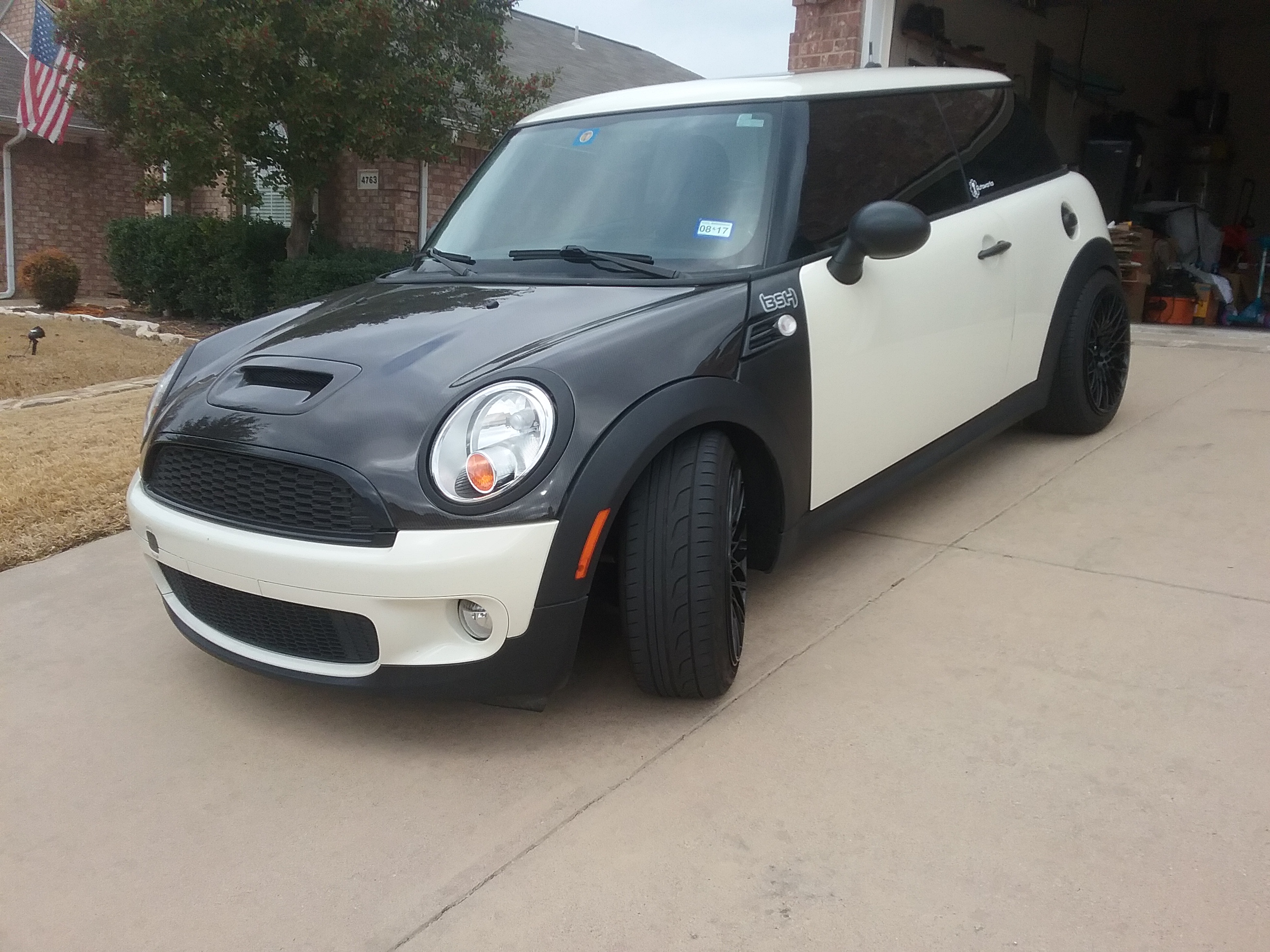

Old Feb 2, 2017 | 07:35 PM
  #933
Jpfugly's Avatar
Jpfugly
Joined: Feb 2016
Posts: 39
17x8 ET30 205/45
Old Feb 6, 2017 | 02:06 PM
  #934
Bnourai's Avatar
Bnourai
Joined: Sep 2016
Posts: 748
Likes: 47
From: TEXAS
will any of you go with 15x8 et35's on r56 2009
reason for asking i am not so happy with 17x8.25's with 215/45/17 tires the back of my car is so high i need it to get as low as i can but still be able to daily drive.
Attached Thumbnails Roll call - 8"+ wide wheels-mini1.jpg   Roll call - 8"+ wide wheels-mini2.jpg
Old Feb 6, 2017 | 05:39 PM
  #935
mini coop's Avatar
mini coop
Joined: Dec 2008
Posts: 1,541
Likes: 52
The 15 inch will not lower the car itself as the goal is to maintain circumference and diameter so that the speedometer and tachometer are accurate. If you decrease the circumference and diameter you will lower the car to the ground but will increase wheel gap - the distance between the top of the tire and the wheel arch. You also effect the speedo and tach as a smaller tire rotates greater per mile or more often. Then you would need lowering springs to lower the wheel arch to the top of the tire. Or you could invest in coil overs that would accomplish the same. A smaller diameter is great for acceleration too as it turns faster due to the smaller circumference. You could lower your car by using the stock size tire - 204/40/17. This will slightly increase wheel gap but it will be at OEM measurements. The 15 inch tire has a greater side wall which will flex more in corners as well. It rides much smoother though than the 17's. I hope that this helps you.
Old Feb 7, 2017 | 04:03 AM
  #936
Bnourai's Avatar
Bnourai
Joined: Sep 2016
Posts: 748
Likes: 47
From: TEXAS
ABSOLUTELY, my car is on EiBach lowering springs and at this point I may have about less than half inch gap from arch to top of my tires, coilovers at this point will be no help but my thought was if I go 15's with coilovers then I may achieve the stance just did not know how it may feel with 15's.I drove a friends r53 with coils and works 17x7.5 and the car is very low and felt great but looks like the 56 is built in a way that the rear end is much higher.
Ben

OK guys please help me archive what is in my mind. I just don't like the way my wheels fill the wheelwell.
What I have in mind is to get as close to struts and fill in all the way to the edge of arch, I have some xxr 17x8.25 et22 running 215x45x17'shoes in the back and 205x45x17 front. But it's just not right nor it came out the way I like them.yes they poke a little but look narrow because of the tire size,like to go as wide as tires I can get, my Megan euros came in today so I need help with correct wheels and et.with coilovers maybe a little negative camber for no rubbing.sorry for bad pics.
Thx
Ben
Attached Thumbnails Roll call - 8"+ wide wheels-20170215_112246.jpg   Roll call - 8"+ wide wheels-20170215_112431.jpg   Roll call - 8"+ wide wheels-20170215_112313.jpg   Roll call - 8"+ wide wheels-20170215_112304.jpg   Roll call - 8"+ wide wheels-20170215_112200.jpg
Old Feb 17, 2017 | 02:12 AM
  #943
Jpfugly's Avatar
Jpfugly
Joined: Feb 2016
Posts: 39
Originally Posted by Bnourai
OK guys please help me archive what is in my mind. I just don't like the way my wheels fill the wheelwell. What I have in mind is to get as close to struts and fill in all the way to the edge of arch, I have some xxr 17x8.25 et22 running 215x45x17'shoes in the back and 205x45x17 front. But it's just not right nor it came out the way I like them.yes they poke a little but look narrow because of the tire size,like to go as wide as tires I can get, my Megan euros came in today so I need help with correct wheels and et.with coilovers maybe a little negative camber for no rubbing.sorry for bad pics. Thx Ben
I saw your post before what is your car currently lowered on? Don't hold me to 100% of the specs but I think the extreme wheel setup that I measured. With out rubbing or trimming. But I don't think you'll find anything off the shelf with those offsets.
Old Feb 17, 2017 | 04:28 AM
  #944
Bnourai's Avatar
Bnourai
Joined: Sep 2016
Posts: 748
Likes: 47
From: TEXAS
Well I am now on EiBach lowering springs right now and will be going on Megan euro II's next week the wheels on my R56 are 17x8.25 et22 and are semi concave they poke out about 29mm from my arch but have managed to keep them from hitting the arch with tire stretching
It occasionally hits the arch in a strong dip.
If I can calculate correctly rim size 8 et40 should take me 15mm closer to struts and retracts by 21mm from the curent 29mm living only 1mm from inside the arch allowing me to lower the car with coilover.
Ben
