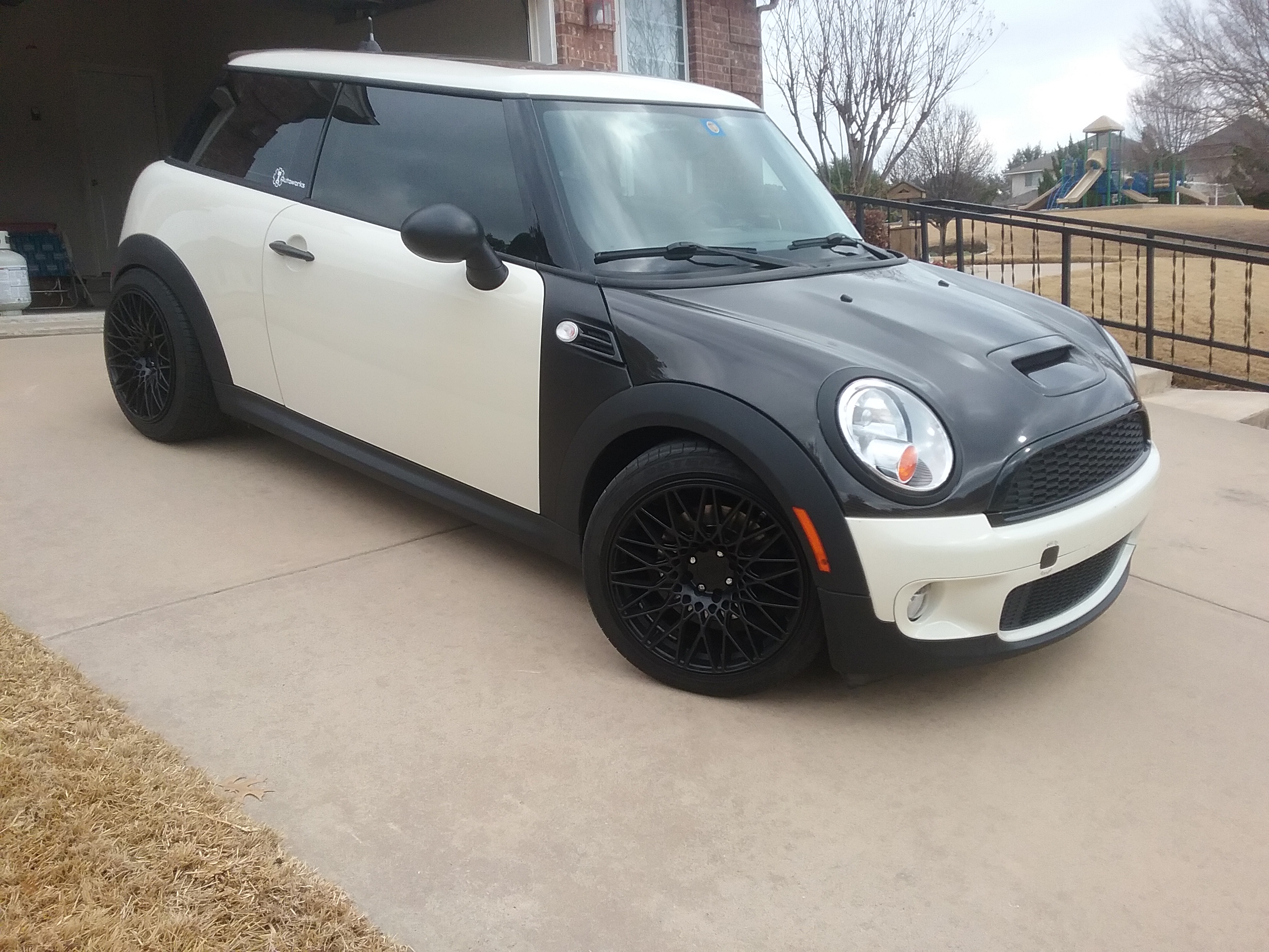

so i went with 17x8.25 et 22 and stretched rear tire 215/45/17 and front 205/45/17 looks great but as its been said i have a rear rubbing a little, so next week i will have the rear camber set since i have adjustable control arms.

That looks really very nice! Congrats!
Do you think about "opening" a little the metal lip under the plastic cover to avoid too much camber change?

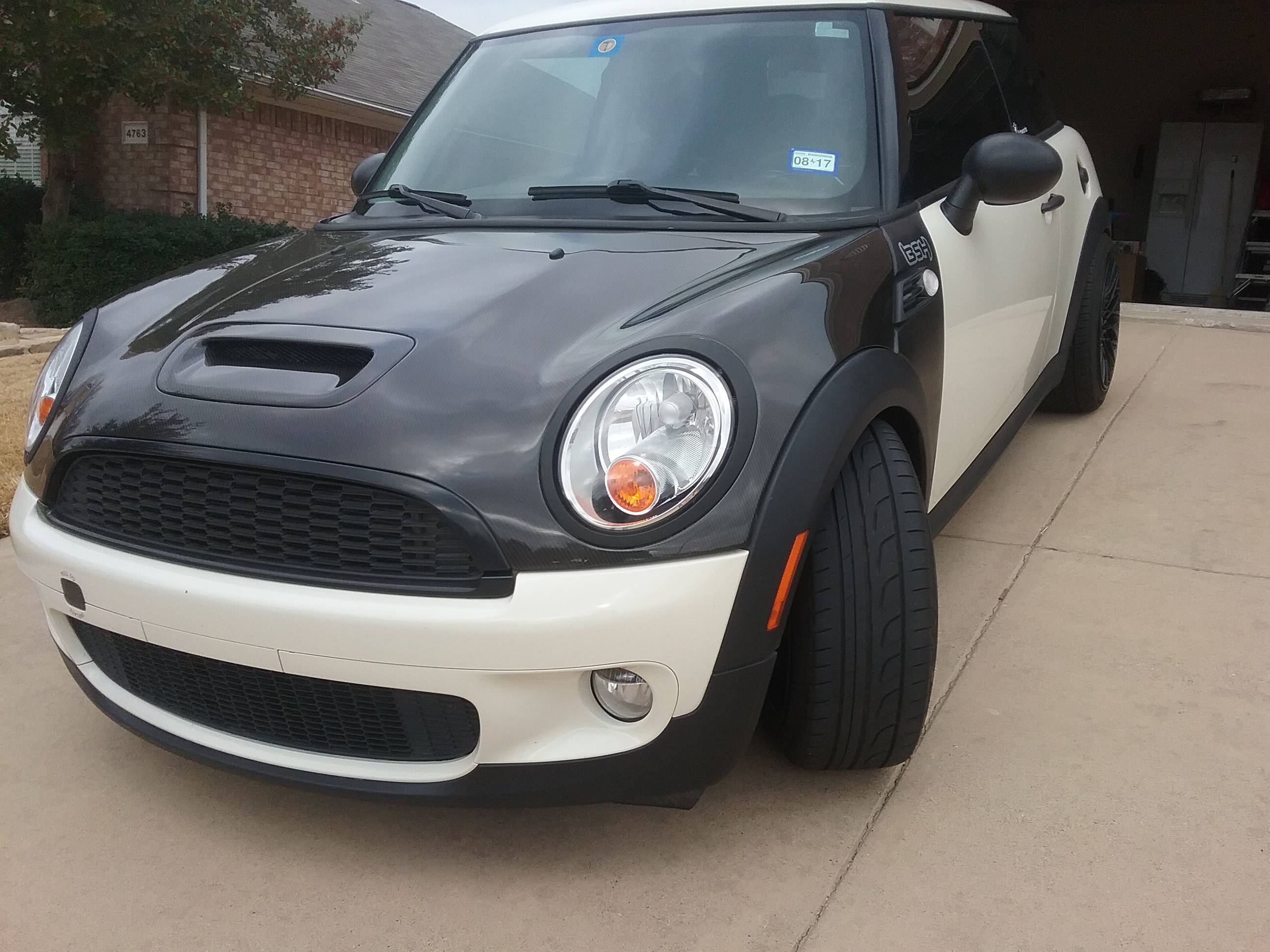

Yes actually as soon as I get my roller in.
Ben
Btw:my JCW 17x7 mint condition will be up for sell if anyone is intrested.

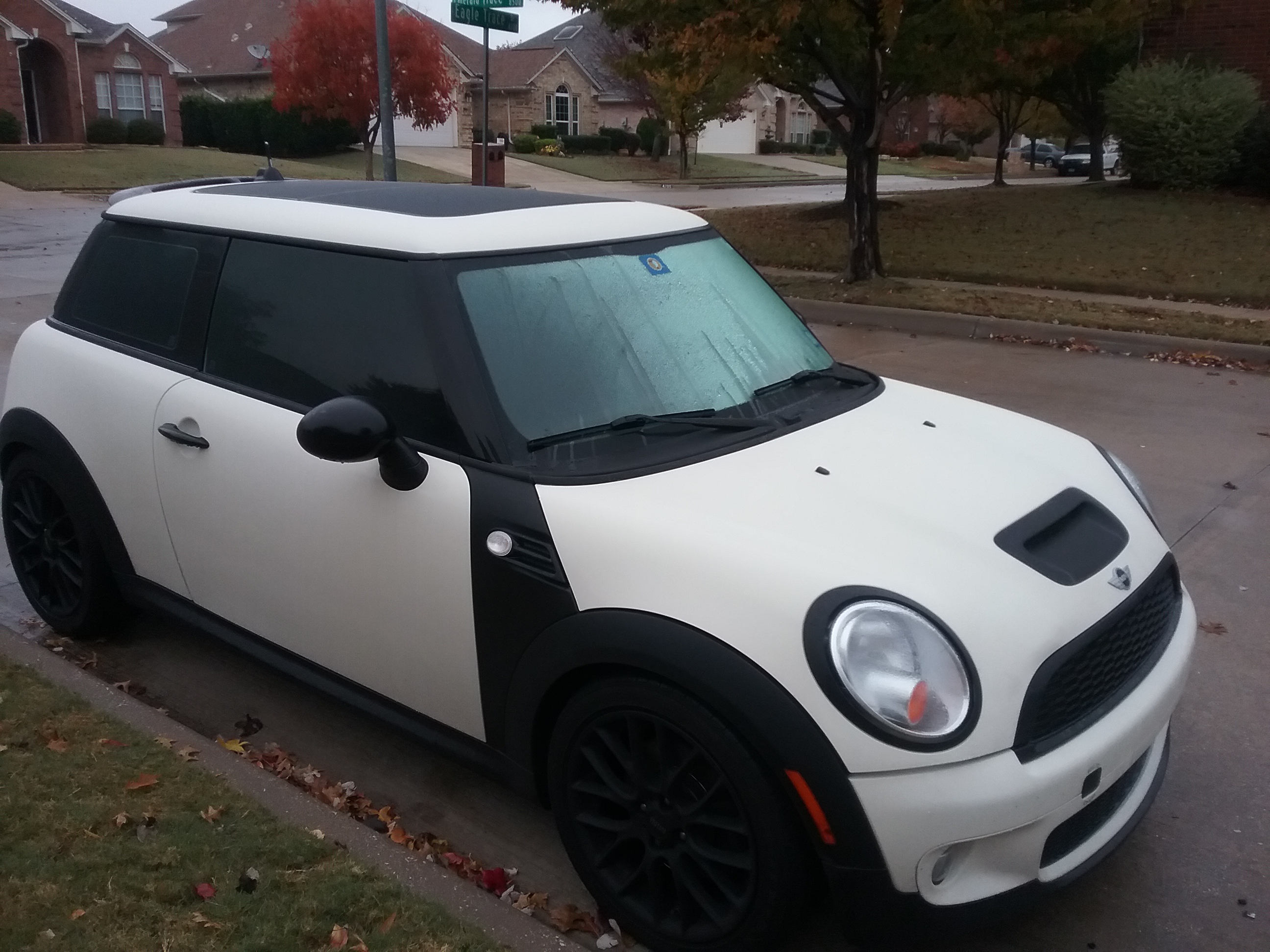

So I had my VIS hood that I was waiting for a free time to add to the car.they make great carbon products.I think that there is too much meet on those tires so I may go with 215/40/17 tires vs 45's and lower the car a little bit more.
Ben
