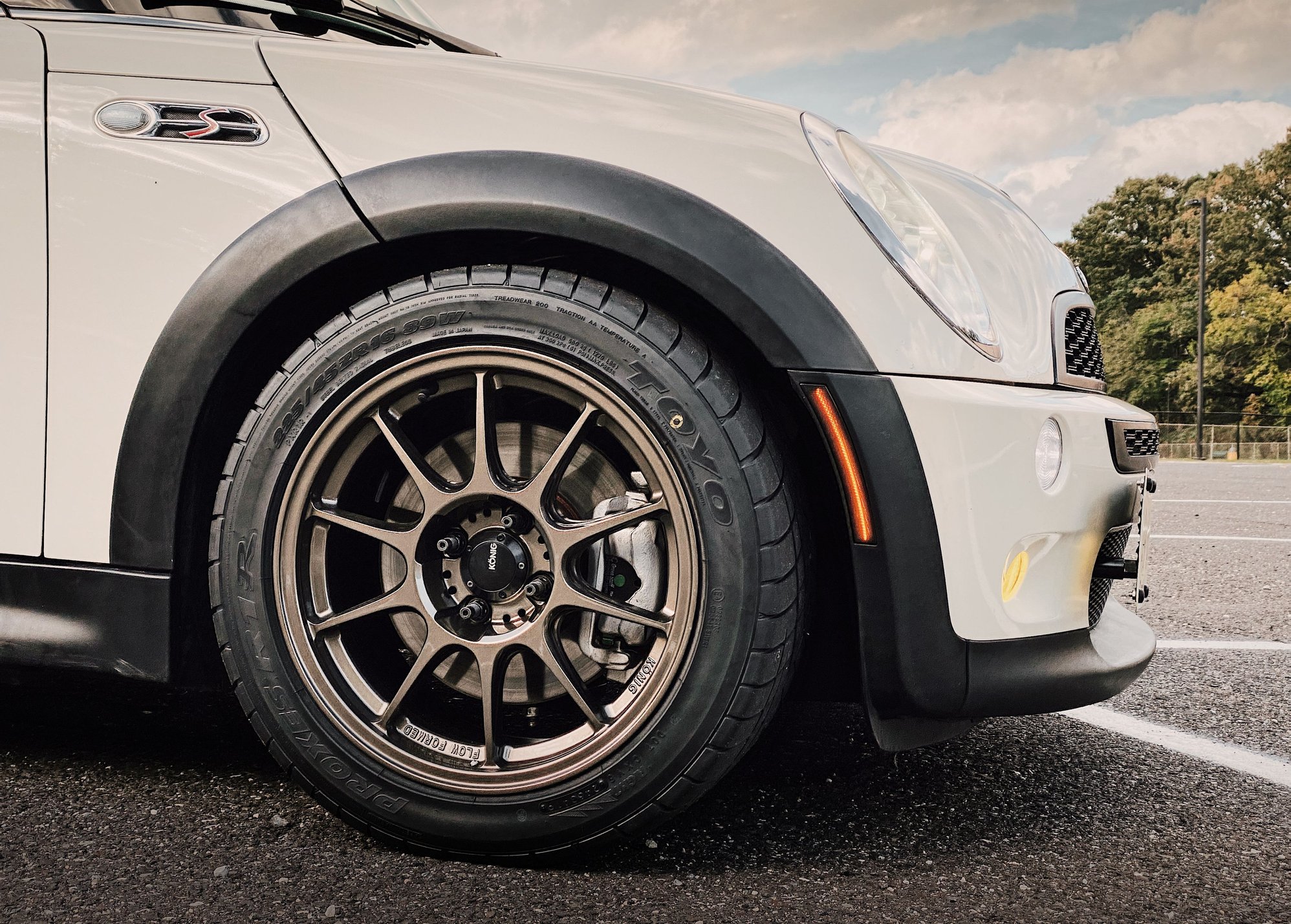

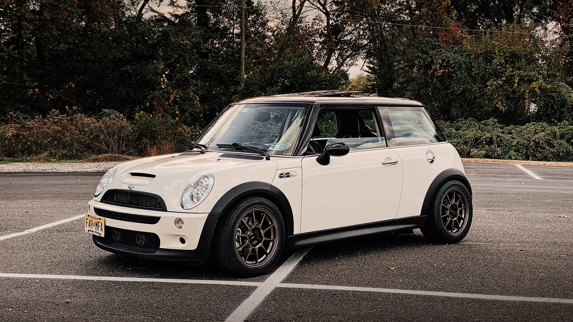

Running 225s on Dekagrams
I've been working on this build since January and just recently planned out my wheel & tire setup:
Wheels:
Konig Dekagram
4x100
16x8
et 35
14.7 lbs each
Hub/Spacers:
R56 hubs
82mm wheel stud conversion (M14x1.25)
3mm front spacers
No rear spacers
Tires:
Toyo R1R
225/45-16
Section width 9.0in
Tread width 8.1in
Suspension:
BC BR series coilovers w/ camber plates - lowered 1.4in from stock height
Swift Springs (7k front, 5k rear)
Adjustable rear control arms - lower arms only
Brakes:
R56/JCW front brakes (294mm rotor)
Stock rear brakes
Trimming:
Plastic fenders arches are trimmed as close to the edge as possible
Fender liner outside edge is trimmed back 1.0in
No sheet metal trimming needed
Rubbing:
None
Alignment:
Factory alignment specs!
More pics in my build thread here if interested.

@JKo Thanks man. Yes, without any spacer my tire just barely skims the paint on my BC strut body. I could probably get away with a 2mm spacer.. if I could find one.
And yeah my 225/45s do work but the measurements are very precise. So much so that your 34 offset instead of my 35 might mean you don’t need a spacer in the front, depending on your strut body diameter and spring perch location.
To be honest I couldn’t find any R53s running this size without rubbing or wide fender arches when I was planning mine out, but the math worked so I took a shot.
Also, I paid special attention to the actual section width of the particular 225s I choose. The Toyo R1R tend to have a rather square shoulder, meaning the section width of mine may very well be a few mm narrower than some other 225s.
Not sure if you’re still running -1 camber all around like in your post above. You’d likely have to add some camber in the rear. I’m at -1.9 in the rear currently and it just sneaks by the trimmed fender arches.
I’d be stoked to have a 225 brother though! So happy hunting!
Trag
P.S. This is my current strut body clearance afforded by my 3mm spacer.

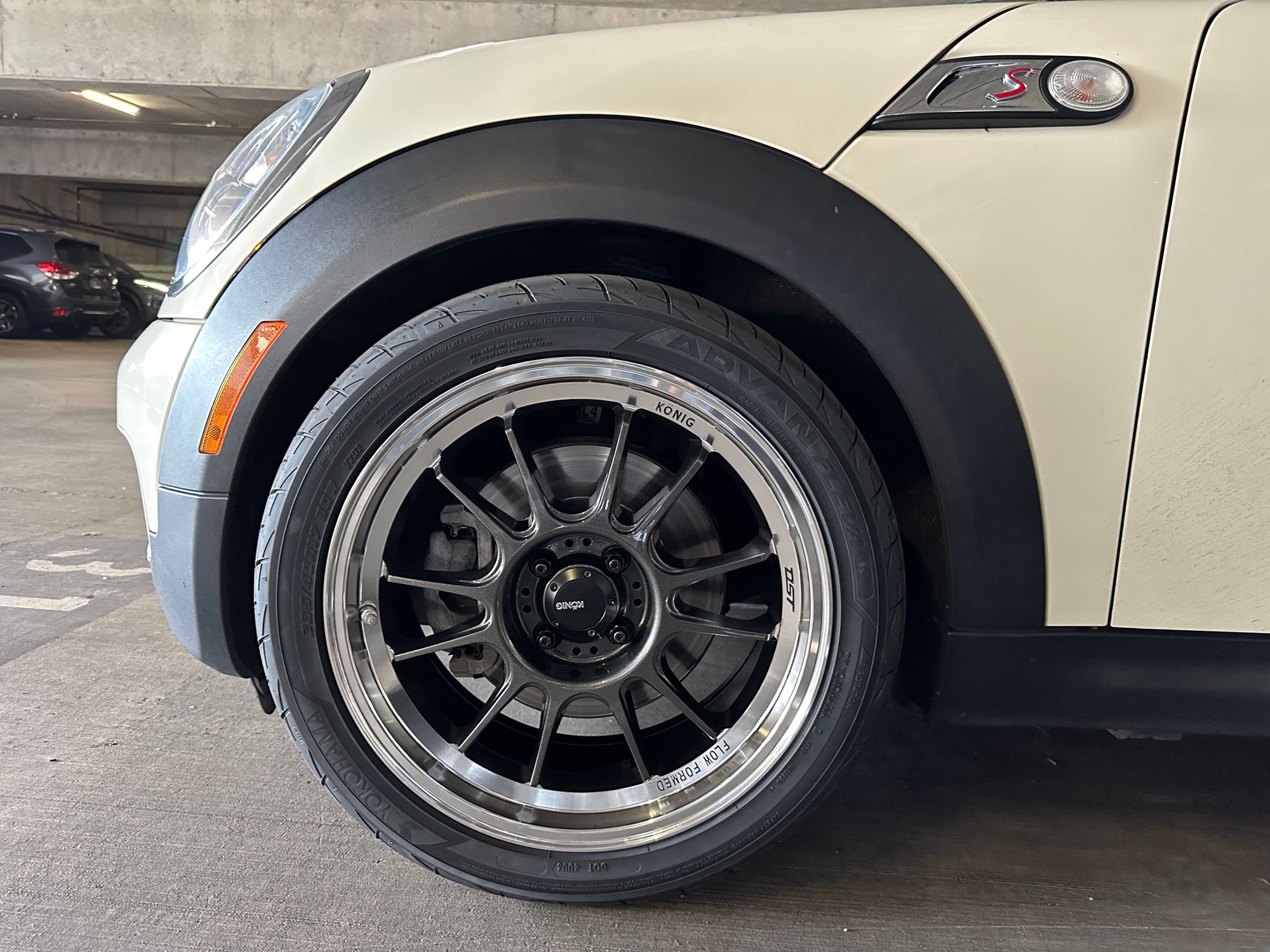

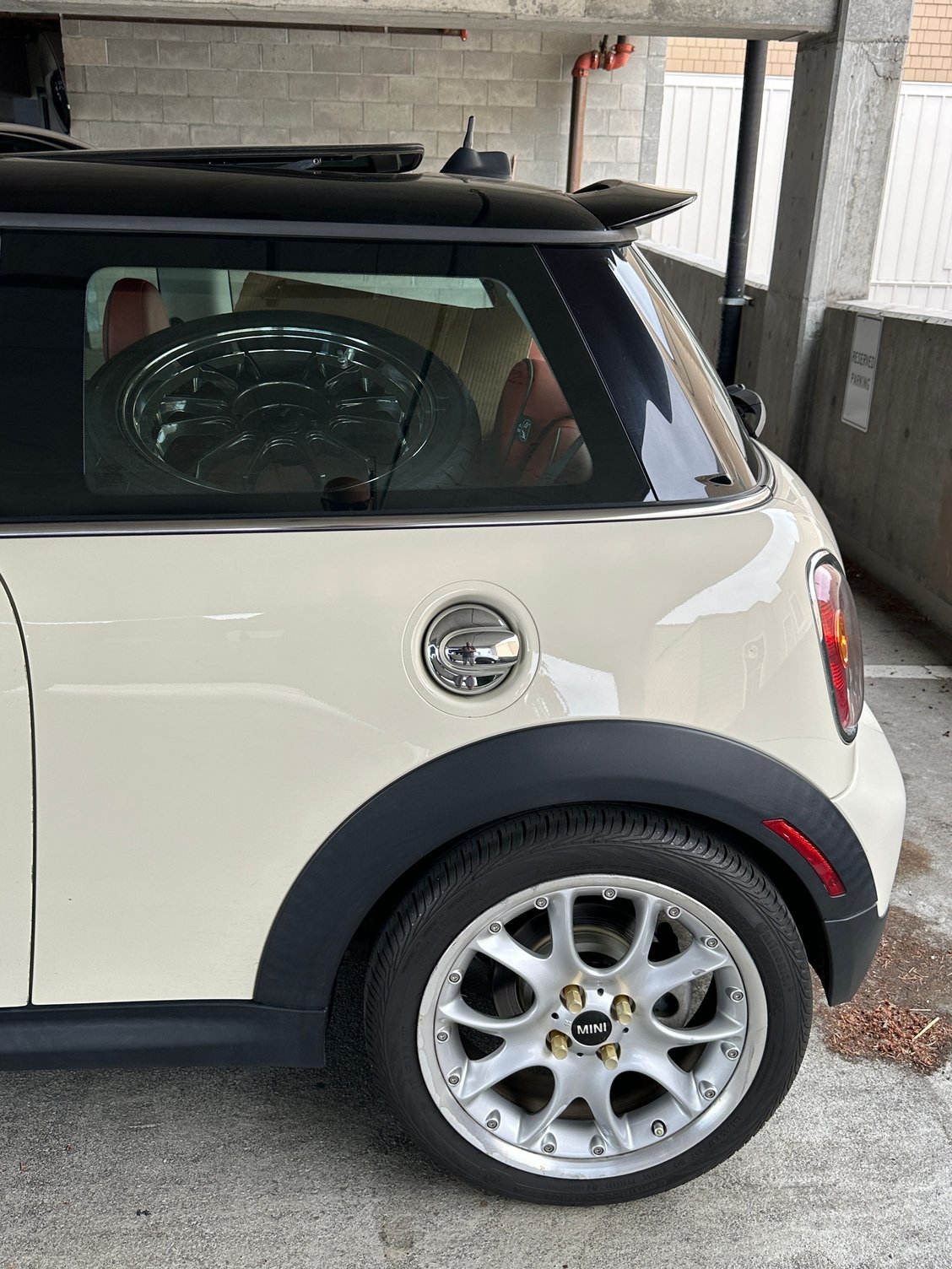

Konig Hypergram 17x8 with 235/40 17 tires
Much thanks to all the information provided here. Also have to thank Good-Win Racing and the local Portland Miata community.
Picked up a barely used set of Konig Hypergrams from a local Miata owner. Sourced all the goodies to mount these up given my preferences:
- 14 x 1.5 stud conversion
- 14 x 1.5 open ended lug nuts
- 15mm spacers all four corners
- 57.1 to 56.1 hub centric rings for the spacers to hubs
- 73.1 to 57.1 hub centric rings for wheels to spacers
The above setup results in more grip and a wider stance (obviously), with the tires just protruding the fender flares by about 3mm front and rear. Spent a lot of time researching on here and other forums, as well as playing with different options on willtheyfit.com to get proper offset.
Ride quality is greatly improved from the narrow OEM R98 wheels with run flat tires. I can drive over a manhole now and don’t wince.
Note that I am on stock suspension. Planning on BC Racing coilovers eventually.

Originally Posted by Kopasz
17x8+45 with 235/40-17 and 15mm spacers?
Looks good at stock ride height. My guess is that you’ll get rubbing when lowered. That a LOT of tire for a Mini.
Yeah, drop will only be about an inch. Not interested in rolling or cutting fenders. I looked in to the VAD Designs fenders but I decided not to go that wide. I can also decrease the spacer size if I want to go lower.
Yes, it’s a lot of tire—I wanted the grip. Had planned to go wider but decided it wasn’t worth the cost for the wider fender flares.

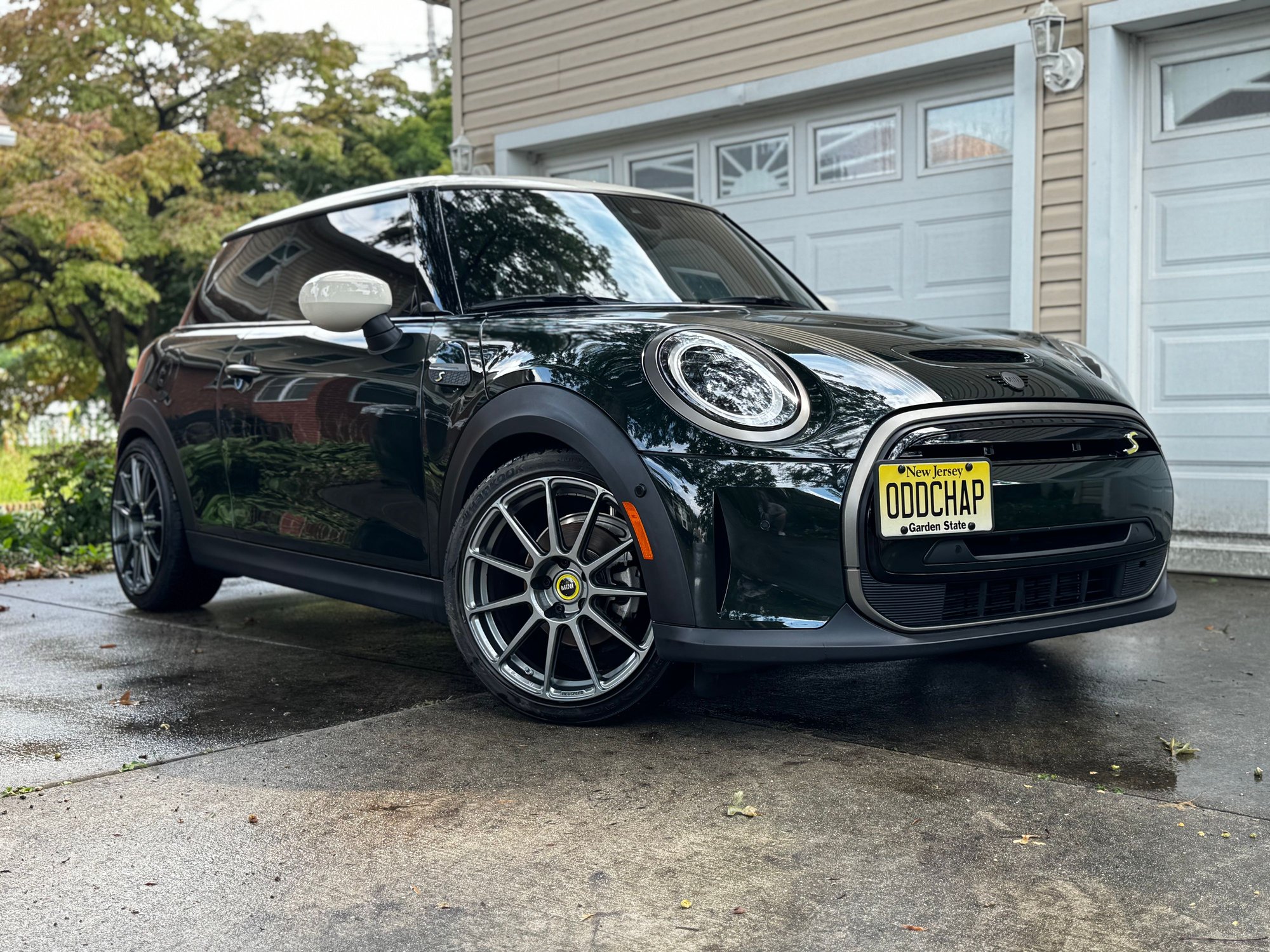

This is my 2023 SE dropped about 1". Wheels are Neuspeed RSe11Rs with 225/40/18 wheels. No rubbing issues on the fenders or the KW struts.
