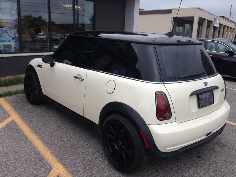

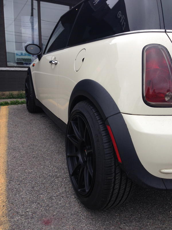

Just had the new wheel set mounted
XXR 527 17x8.25 ET25
Michelin Primacy MXM4 215/45R17
still on stock suspension. on the ride home, found some rubbing issues front and rear. anyone have some suggestions for fixing this problem? ill be buying coilovers soon enough, but id like to stop the rubbing as soon as possible
