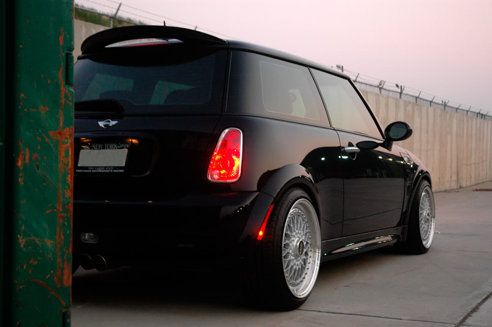

I'm running on a set of 17's, although with this wheel type, due to the different widths run, some would be more likely to tuck than others.
Rally is running 16's and they are much better for tucking. I think the only way to properly tuck 17's if you wanted to run some RS's would be to roll the fenders a bit.

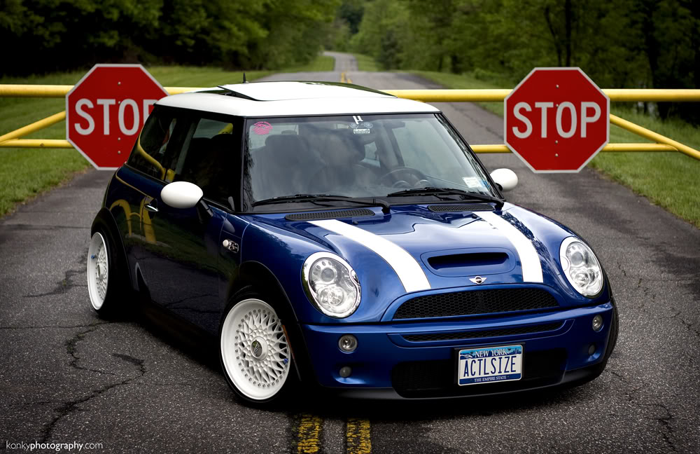

Hardly ever on NAM anymore but just stumbled across this thread...
Here's mine:
BBS RS
5x130
F: 16x8 ET38-18mm adapter = ET20
R: 16x9 ET50-25mm adapter = ET25
205/40 Falken 512s all the way around.

i like the color combo , looks painful to clean tho!
