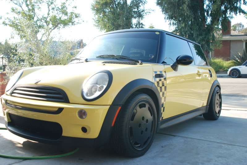

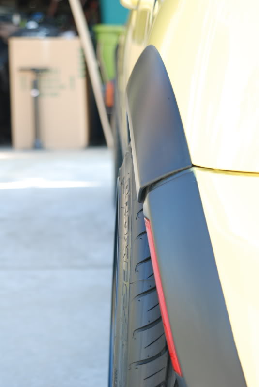

  #114
xnotfunkylex's Avatar
xnotfunkylex
Posts: 1,485
From: Orange County. CA
Wheel/Model: Porsche 928/944 Turbo (7-Slots) (5x130 conversion also)
Offset: 35 F, 28 R
Wheel Size: 16x7 F, 16x8 R
Tire Size: 205/45/16 on all fours
Suspension: V-Maxx Coilovers (much lower now )
Camber Settings: Whatever happened after the lowering
Rubbing: Definitely! (still need to trim the arches )

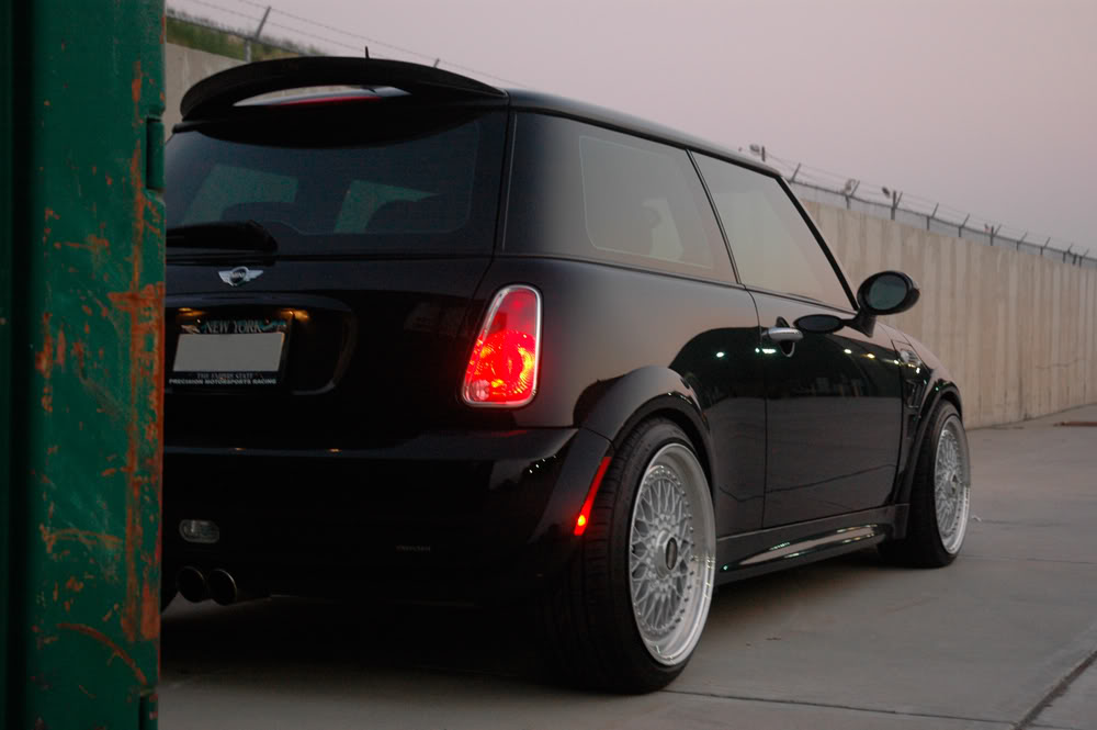

Old May 7, 2009 | 01:28 PM
  #122
M3This's Avatar
M3This
Joined: May 2007
Posts: 367
From: Las Vegas
18x8 +32 w/ 215/35/18

Old May 7, 2009 | 02:21 PM
  #125
M3This's Avatar
M3This
Joined: May 2007
Posts: 367
From: Las Vegas
its a factory JCW Challenge car lip
