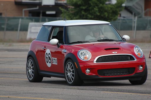

Wheel/Model: Team Dynamics Pro Race 1.2 (Hi Power Silver)
Offset: 38
Wheel Size: 17x8
Tire Size: 235/40/17
Suspension: Stock
Camber Settings: Stock
Rubbing: None
2007 Cooper S
Track functional and track fast!

Ficcion^^....have you looked up under your car to see how much inside clearance you have in the rear? I'm looking at a new set of wheels with slightly more backspacing than the wheels you have now and i would love to hear if your wheels are close to rubbing on the struts(and other parts) or not. How much room do you have on the inside? Thanks

With stock suspension there is about a "pinky" finger width in the rear (from strut and suspension arm) and front (from strut). I would say there is roughly 5-7mm to work with on the inside still.
Remember this is a 235/40/17 Bridgestone RE-01R. Other tires will be different (wider or narrower) even though the same size is printed on the sidewall.
With a set of H&R springs I get slight rubbing on the outside plastic of the wheel well under hard cornering, but nothing that matters much.
I have racked my brain thinking of a legitimate way to get a 17x9 on there but that is an extra 12.7 mm per side! With the correct offset you could do it but the tire would stick out and hit the fender plastic on compression I think? Who knows, the stock suspension is so frickin high anyway maybe it wouldn't compress down that far to begin with...?

How much room is there between the suspension parts and the actual wheel itself? My tires won't be an issue as I'll probably run slightly stretched tires again.

probably 10-12 mm
