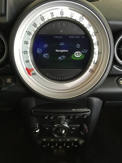

Another success. Just got everything back together today.
Big thanks to ahorvath, he was quick to answer my many pm's.

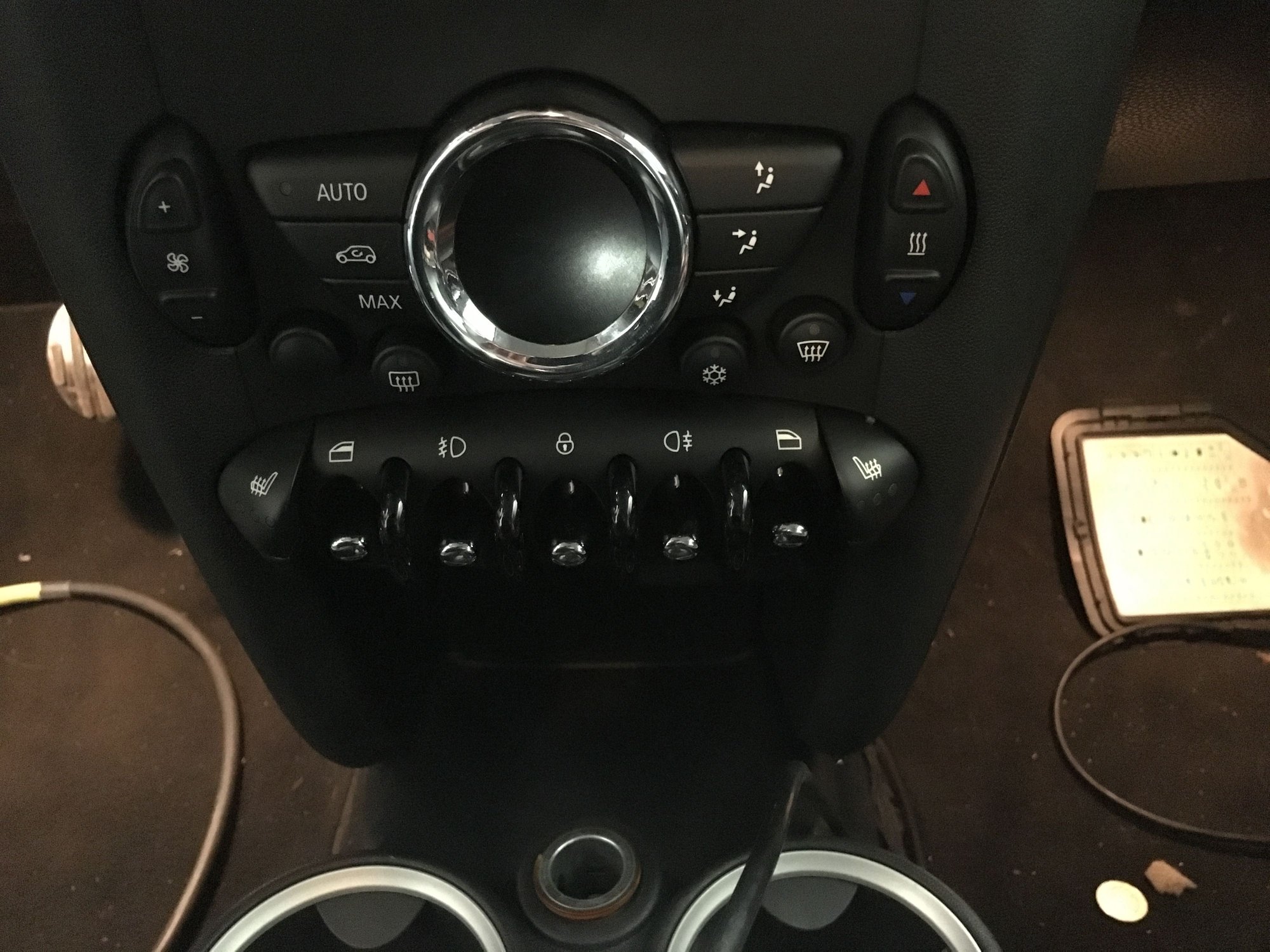

Retrofit on my wife's MCS 2008

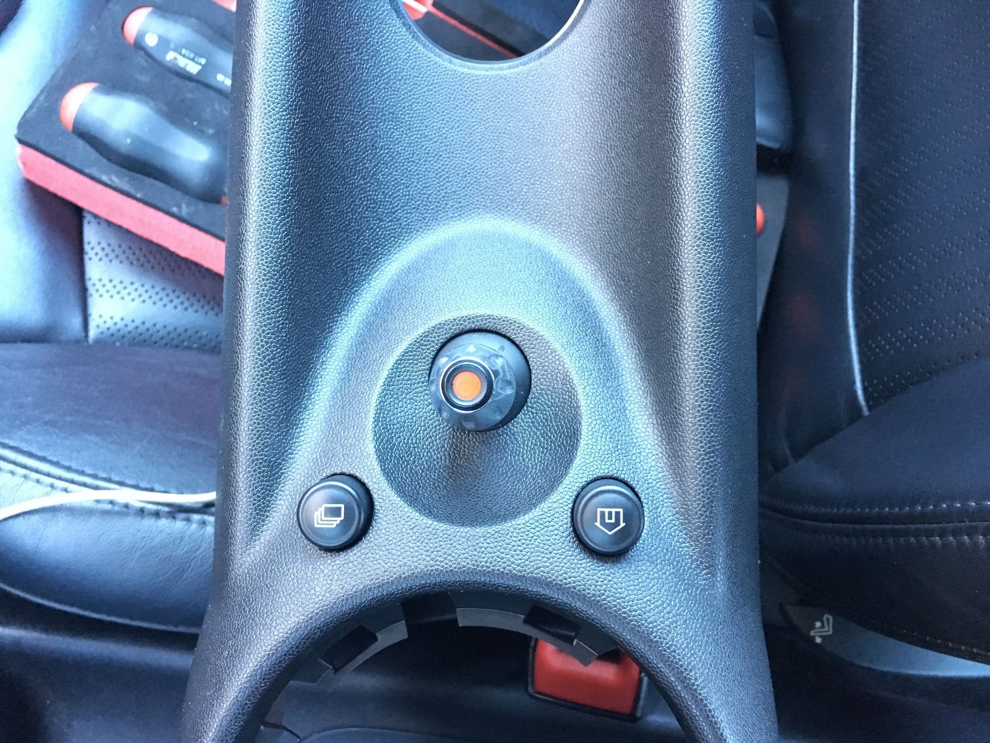

New handbrake console with navigation
Navigation controller
Controller fitted
Handbrake console fitted
Time to change VO I'm using an original ICOM Next.
IHKA from an MCS LCI. I've retrofitted the heated seats and the sport button.
Deutronic 1600DB charger

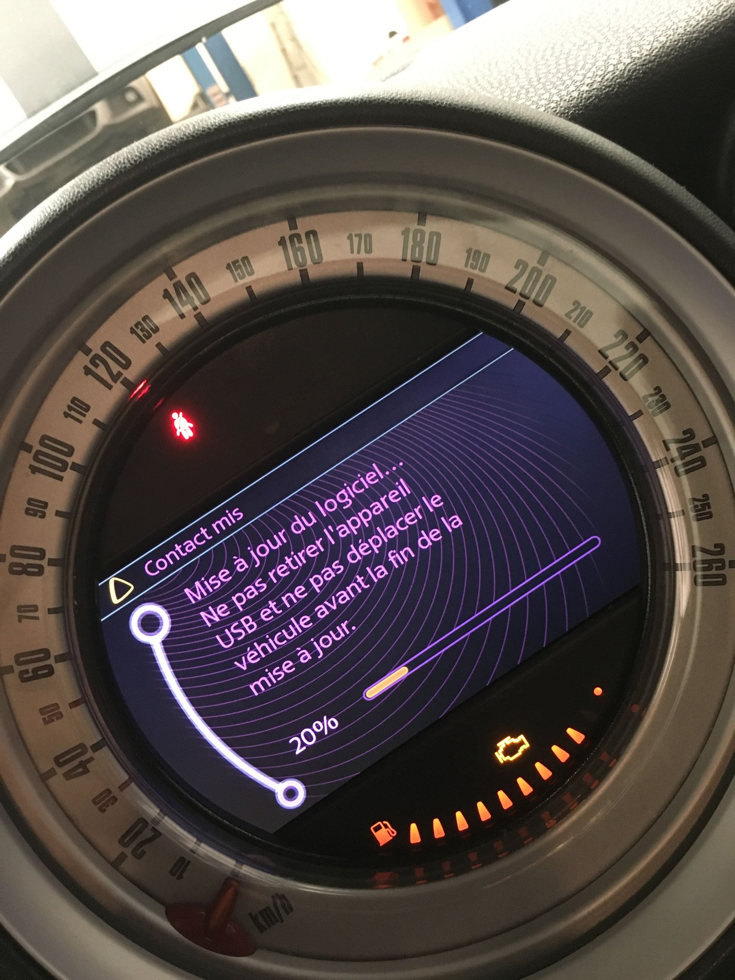

Using winkfp to flash the gateway right order is 62, 63, A0
All working !
Time to update the combox software
Bluetooth streaming from my iPhone
iPhone connected by Aplle's with wire to have the album artworks
