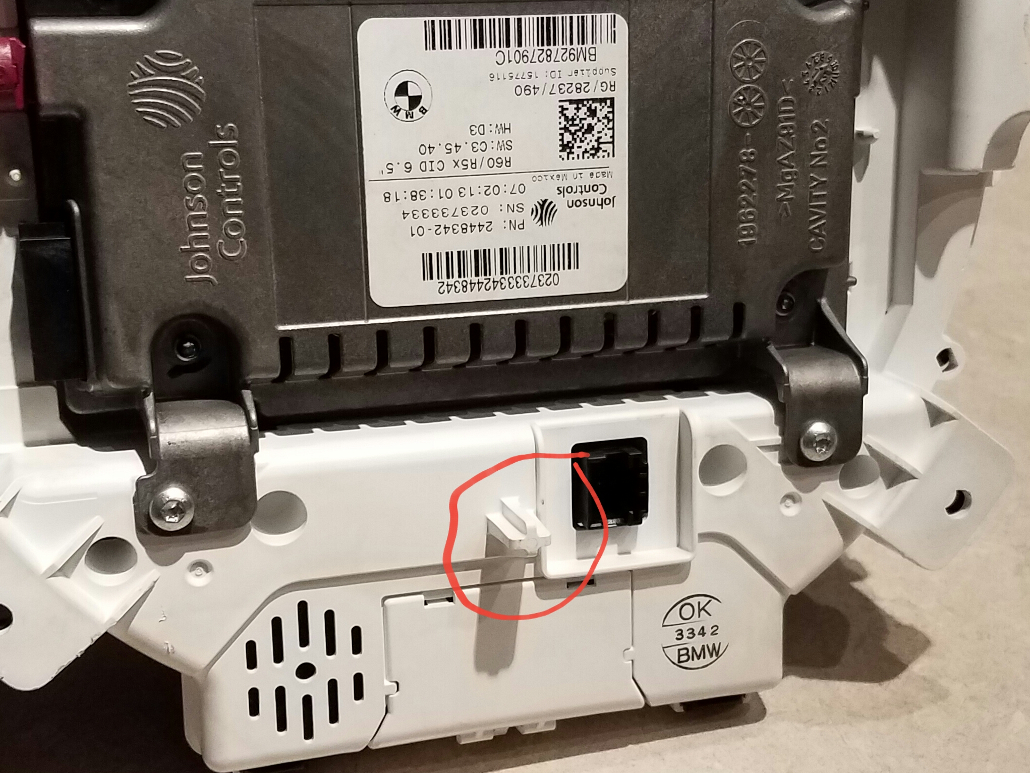

When installing the New spedo with nav screen did you guys have to drill a little hole in the dash so the plastic piece on the back of the spedo will sit in, so the spedo will sit flat on the dash?
**FOR REFERENCE**
Follow this link and you will see a small hole on the bracket where that stub goes in to.
http://www.allmagautoparts.com/produ...43-51169206834
This is the radio bracket for vehicles with factory Navi.

Originally Posted by ALLMAGAutoParts
**FOR REFERENCE**
- Chris
If there are any other differences, he should buy the carrier. Otherwise just cut off the stub.

I just drilled a little hole. It was small. And I do not see any structural issues a drill and a small of a hole. I just didn't know if there was already a spot on some dash. And mine was just the odd ball that didn't have it.
