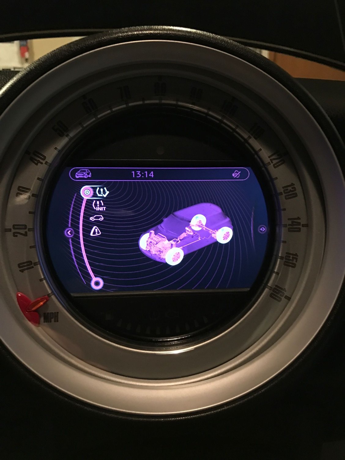

Finishing the process of installing a CCC into my 2009 MCS (got a decent deal from my local junkyard; otherwise might have gone the newer CIC route instead). I will post some more information about my install later, but just realized that this unmarked black thing on the CID (video display) ground wire had broken. The screen is still functional without it connected, so I'm just trying to figure out if I can simply bypass it with a solid ground wire or find a replacement electrical part from Radio Shack or Digikey. Anyone know what it is/ does?
And as a teaser for my retrofit project, here is the view from my front-facing camera:
