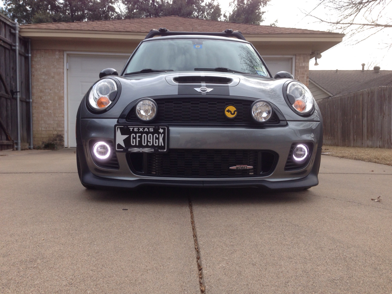

Old Jan 27, 2014 | 12:06 PM
  #572
MikewithaMini's Avatar
MikewithaMini
Joined: Jul 2012
Posts: 777
From: Richardson, TX
I like!
Old Jan 27, 2014 | 12:18 PM
  #573
SuperGreg's Avatar
SuperGreg
Joined: Jul 2008
Posts: 1,733
From: Chandler, AZ
Originally Posted by MikewithaMini
I like!
very nice!!
Old Jan 27, 2014 | 12:30 PM
  #574
MikewithaMini
Joined: Jul 2012
Posts: 777
Originally Posted by SuperGreg
very nice!!
Thanks Greg! I'm now debating extending the stripe, leaving it as is, or , taking it off and getting what I've been told are "Corvette Stripes." Two hashmarks just above the wheels at an angle on both sides, then leave the back, which matches the front all the way to the diffuser. Whaddya think?
Sorry - off topic.

Old Jan 27, 2014 | 12:41 PM
  #575
KilmerPT's Avatar
KilmerPT
Joined: Nov 2012
Posts: 645
I like!
Looks great!
