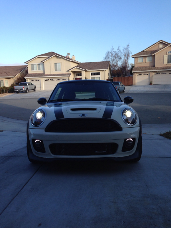

I finally got a day off work so I installed my LED DRLs last night. I took the bumper off as I fitted my Helix FMIC as well. It took me way longer than I planned for but that was because the pipes were really stuck on the stock intercooler, and it took a very long time to get them loose. Then it took me several tries to get the FMIC on because of the new radiator support bar (I did not have this on my MCS). I really thought I was F-ed when I couldn't get it to fit at first lol.
But after many trials and tribulations, the good news is that everything worked correctly on the first try.
Man I love these DRLs!

It seems I did something wrong with my install or putting the car back together because now my right turn signal isn't working? The left turn signal works and will only turn off if I make a left turn or hit the stalk to the go left again. Can anyone give me any suggestions as to where to start to troubleshoot this? Everything else seems to work okay such brake lights and when I turn the alarm on/off both sides light up. Thanks!

I fixed it! Finally!! And you're not going to believe what was causing all the problems. lol. At first, I checked again that I crimped the correct grey wire on socket x14261. As the photo below says and many others mentioning it. It's the one on the top and it's black/black, the x14260 is on the bottom and is black/grey for comparison.
After, checking and re-plugging the sockets and battery, I tested again and got the right-turn signal working. I cleaned up everything and went for a test drive again. Unfortunately this time, I got the right-turn signal working, but then the DRL ring was not and the headlights would automatically turn on even when the stalk was in the "off" position as soon as I put the key in the ignition! Just my luck huh?
So I open it up again and unplug and re-plug the sockets and everything now seemed to be working again, and while it was all working I decided to just tighten the footwell module down while it was all working correctly. However, every time I would move the footwell module ever so slightly, the lights would go back to the same malfunctions as before. So I'm thinking perhaps the wires are somehow getting crossed and shorting (I don't really know what to call it) when I would fasten the footwell module.
It turns out the sockets and wires are pretty sensitive to how they were originally wound up. What I mean is the way they were coiled sort of or twisted from factory. When I was having the malfunctions, it was because I didn't twist the wires back the way they were, and they were too "loose" and somehow I believe that was the root of my issues.
I figured this out as I would push the wires and make them more taut on socket x14259 (yes the one on the front of the footwell module and I'd get the same effect of it being normal working and then abnormal--go figure). Making them too taut gave me lightbulb failure warning on just about every one of them. lol. So there is a sweet spot apparently.
I don't know why and I cannot explain it as I am not an electrician, but that is how I fixed it. lol. Took several tries, and if all goes to hell again tomorrow morning I am just going to walk to work.
On the bright side, I've gotten really good at taking off the wiper arms and accessing the bulkhead, and getting to the footwell module in about 5-8 minutes. I only hope I don't have to keep doing it so I can enjoy these LEDs instead of hate them.
