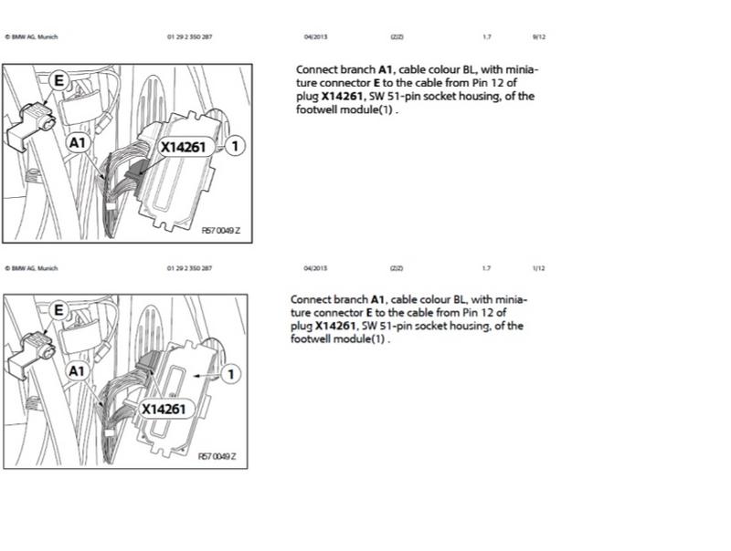

Originally Posted by Angryriican66
The directions say pin 12 of the 51 pin connector, this is wrong! It is the 12 pin wire of the 53 pin connector you need to tap into. For reference the correct wire is grey
I need help with which pin connector do I find pin 12 for Connecting the blue wire. I located the pin 12 of one of the connectors (the one at the lower end of the control unit) and that wire appears more purple than gray and a faint yellow line on it. Is that it? The second pin connector (on the top of the control unit) I cannot get in close enough to locate the 12th pin since most of the wires are covered with plastic cover which does not appear to come off. So my question is which pin 12 connector is it? I have also read the pin connector in the instructions in pointing to the wrong one (top vs bottom one). I have read the wire should be gray?

The instructions were very frustrating and contained errors for this part of the installation.
I tried to in my post #420 on this thread to get a detailed explanation of the connection to include photos of the actual parts--Note the color and size of the actual wire.
Thanks. Post #420 is helpful. I will need to try again tomorrow. It appears that after disconnecting the top 31 pin connector I can slide the plastic sleeve cover off. That was not apparent from my first attempt. Hopefully I will find the top connector pin #12 is gray. If so I will connect to it and cross my fingers.
Also, I noticed two versions of the instructions with the same 04/2013 date on them. The only difference is the footwell image on page 9/12 showing the pin connector X14261 changed ( I attached screen prints of both.) I find it odd that the instructions still show the main harness wires coming from the below but my wires (and the photos in this post) show the main wires from the top. If the instruction were correct this would be an easy install!

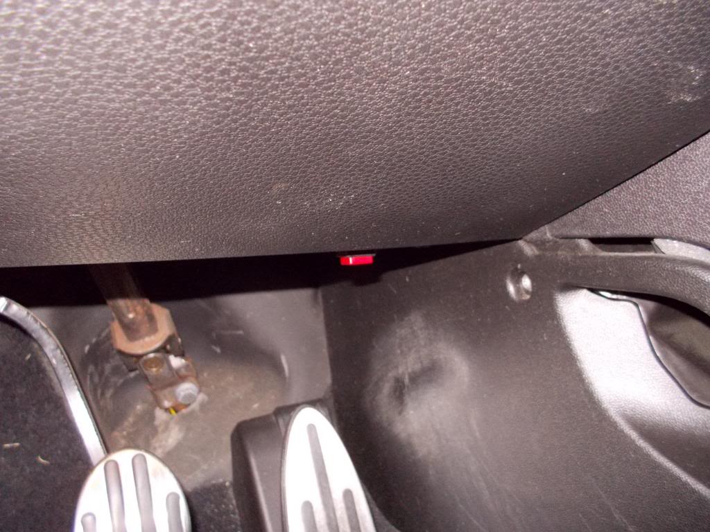

I've competed the cutout switch installation for Louise and it works as I expected. Here's a video and a couple of photos showing where I installed the switch. Simply install a single pole single throw (SPST) switch between the blue control wire and the switched power source. DONE!
