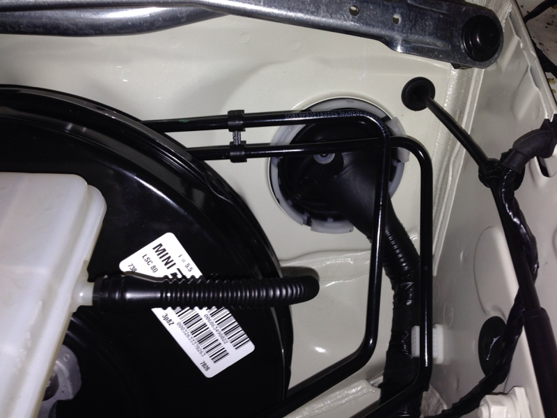

Originally Posted by white3
Why are people removing their wipers to install this- its not necessary, unless something has changed in the process since I did it.
I took them off so I could get more work space. I couldn't remove the cover for the grommet because I couldn't reach it properly. The spray can lid technique didn't quite work for me.

How did you snake the blue wire into the cabin without removing the plastic covering over the rubbery piece that you cut to feed the wire into the cabin? I had to remove my wipers to get that plastic covering off.
I did not remove the wipers or wiper cover. As suggested by someone else, you can prop up the plastic wiper area cover with spray paint caps and reach in (if you have smallish wrists) and undo the covering over the feedthrough.
Without taking the wiper apron off, isn't it a real challenge to snake a single wire through the outer firewall grommet around the brake booster to the inner firewall grommet? I installed extra driving lights with wiring taking the same route. I'm not a big guy but it was trick with the apron off. Will have to try your method though.
It was a tight fitting squeezing my hand in to unlatch the cover over the grommet/passthrough. Did get some scrapes on the hand. But I couldn't get the wiper off so I had no choice.
Once the covering was removed I snipped the end off one of the spare ***** and used a ziptie to help feed the wire through.
