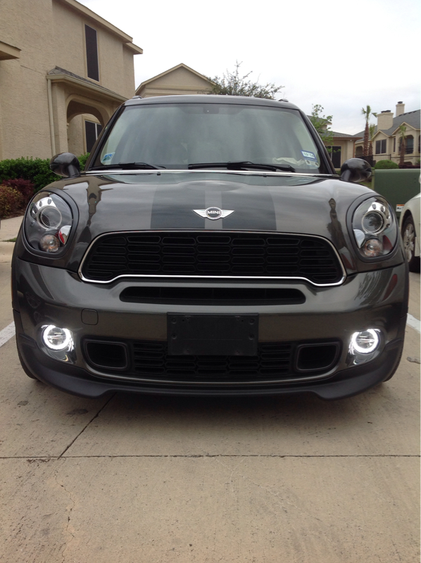

Finally I had mine installed today by German Auto Center here in Austin, TX

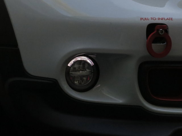

Just installed this week along with a few other bits.

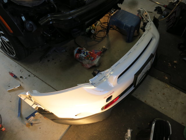

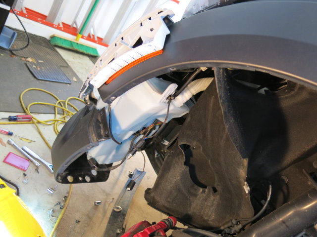

I ordered my DRL earlier this year and finally installed them in my CM today. I ended up removing the bumper--not as difficult as I thought. This forum post was extremely helpful. Thank you! I thought I could sneak my hand in but the windshield wiper fluid reservoir blocked me. Also, on the CM removing the headlights would not have provided sufficient access to the driver side fog light. Luckily the bumper is not attached to fluid reservoir. Removed the first three wheel well trim expanding rivet which I needed to gain access to the screw fastener holding the bumper on. I am glad I ordered replacement rivets #2 228 710 replacements before I started--it was difficult to find the plastic piece as I punched them out. As for the blue wire--since the CM is larger--I did not have to remove the windshield wiper cowl to access the firewall grommet. I am thrilled with how they look and how much brighter they are. Also, I was surprised on how light and cheap plastic the OEM fog lights, these feel solid and much.
