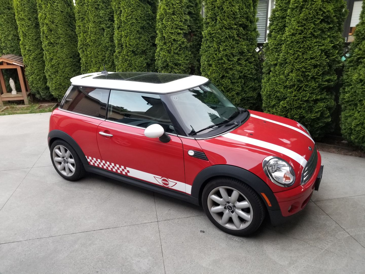

Added 10 HP on my Justa today
I decided to add some HP on my Justa in a form of vinyl decals. 5HP per side LOL!
Attached Thumbnails What did you do to your mini today?-resized_20180509_201340_5254.jpeg
That's some sick boosting

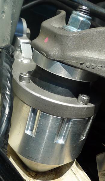

I didn't get as much done as I had hoped this week, but I had other irons in the fire and couldn't commit full time, but I'm happy I guess to get this stuff taken care of --- haven't had much time at all this year due to intense work schedule and going back out this coming week, but all signs are pointing to a slowdown on that front and I'd be thankful for the extra free time.
The motor mount was extremely easy and I was very pleased with the fact that after installation it tracked more straight and true, before it had a slight pull to the right but I suspected mushroom towers and didn't think that the mount would equate in that picture but it seems that it did --- my towers are slightly shroomed and I have some Craven STD's on the way and will rectify that problem soon enough...
...the WMW mount is quite beautiful and gives a sense of well-being as well:

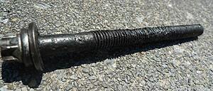

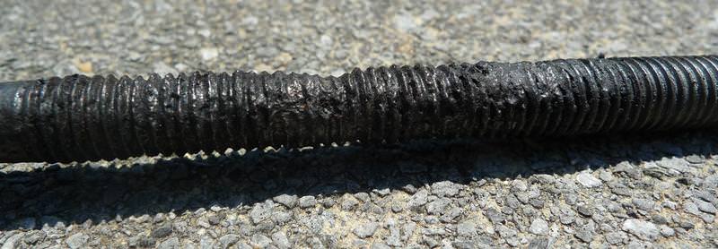

However, the old E12 bolt was a scary sight --- I had been forewarned of the possibilty of a corroded bolt thanks to reading here on NAM and was well-prepared with a new bolt on standby ready to go.
Research pays off and saves time!
Seriously spooky looking bolt:

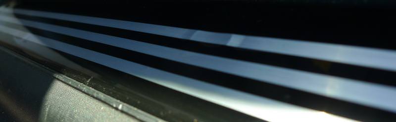

On the cosmetic tip I installed some JCW door sills because I dig the black and I also dig the Mk.1 lowercase logo:
However, I failed to properly research and as such got a poor result --- it took a while to get all the old foam tape off and prep the surface, and I encountered those 4 little square tabs that didn't seem to sit quite right, and mistakenly I just sorta hammered down a bit and they seemed flush, but bubble pockets came anyway:
I should have read this thread first:
https://www.northamericanmotoring.co...p-install.html
Then I would have known to sand it all down, and in fact I had the thought but then decided not to. I've ordered another set and will prep proper next time, and just keep the old ones for spares.
I was slightly disappointed that the JCW versions were flimsy plastic as compared to the stiff aluminium S sills which are much more robust in construction,
oh well.

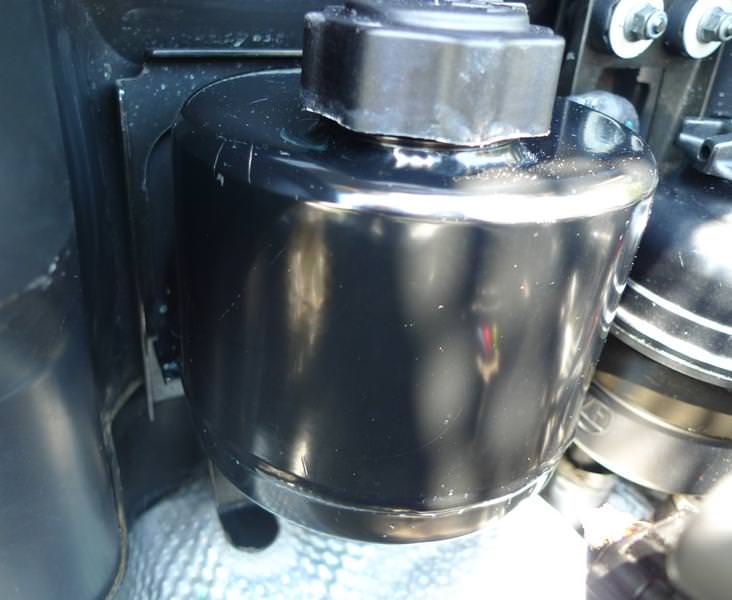

Got an aluminium coolant tank put on and I thought this'd be the easiest job, but I had problems with bleeding after refill and it took me a few times to get all the air out. I drained all the old coolant and replaced with Zerex G-48 which is easily available at O'Reilly, it was a bit pricey though and I might just go back to the green stuff like the previous owner used as it seemed okay.

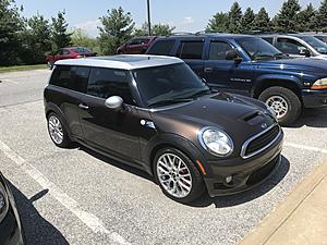

Quick iphone pic from work of my "new" MINI.
