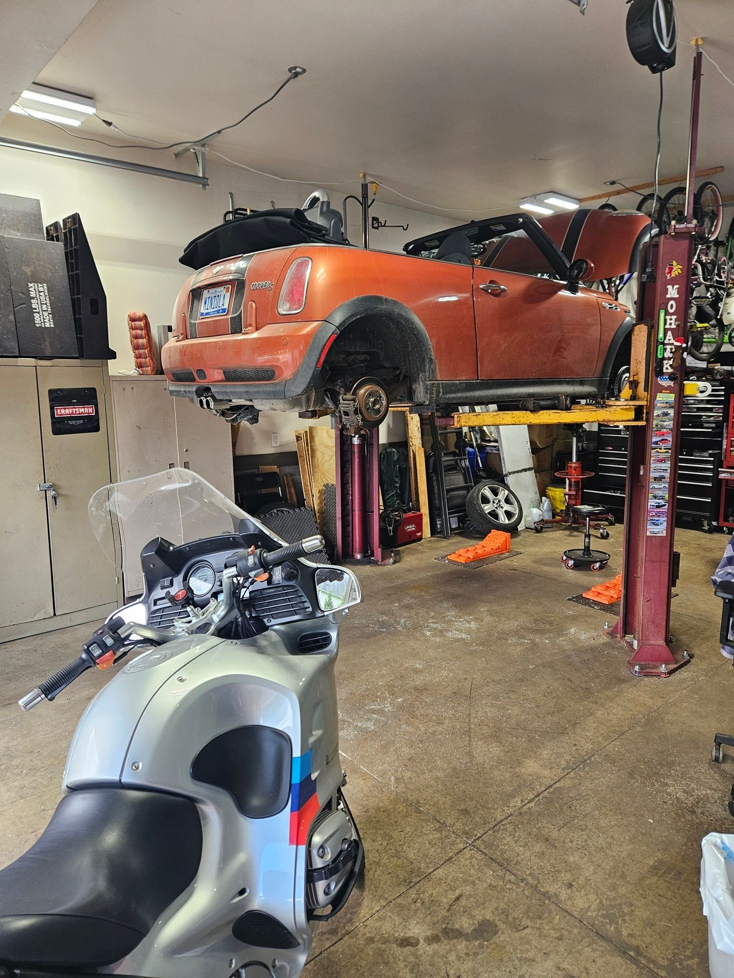

I've finished a number of other projects to finally make some time to get the Mini ready for this summer. She's on the lift, for starters:
I have to tackle the following items from a small fender-bender the kids had a while back:
  • hood replacement (I have a color-matched used one, with the stripes, too!)
  • new radiator
  • new AC condenser - and get the AC working, finally!
  • radiator support replacement (I found a good used one)
Then, there are some other items I've been wanting to tackle, too:
  • Bilstein B6 shocks for the rear (I already have them for the front)
  • New rear shock upper and lower spring pads (I'm going with Mini OE)
  • New rear upper spring plates (also Mini OE)
  • New upper shock bushings (I went with the polyurethane Problem Solving Bushings kit)
  • New front wheel bearings (the left front is definitely louder than normal, and I might as well replace both as they've never been done)
  • New front brake dust shields (I noticed mine are rusting in pieces)
Lastly, in the engine bay I'll take care of:
  • New coolant reservoir
  • Replace the oil-filter-housing to heat exchanger gaskets (I'm looking to address oil leaks)
  • Replace the oil-filter-housing to block gasket (ditto)
  • Replace the oil pressure sensor (ditto, since I'm in there anyway)
  • Replace the valve cover gasket (ditto)
I think I've spelled it all out here as a means of keeping my to-do list straight! It's going to be a busy couple weeks of evenings and weekends.

Today, I removed the front wheel hubs and brake dust shields, the front bumper cover and reinforcement beam and the hood. I removed the headlights, washer nozzles, wiring and hoses, as well, in preparation for swapping them over to the replacement hood.
The right front bearing felt "chunky" when I turned it by hand - certainly more so than the left front's bearing.
I also adjusted the muffler hangers in the rear to try and tuck the tailpipes closer to the bottom of the bumper cover. The tailpipes were hanging too low after I had replaced the exhaust some time ago with a used take-off system I picked up.

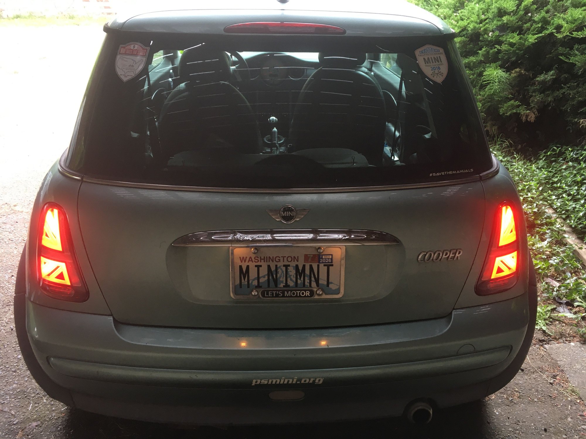

Replaced the old and failed "egg yolk" lights on MINIMNT with new Union Jack ones from VLAND. While I really like the egg yolk lights the OEM ones had completely failed to the point of dimming the light output. It was difficult to get the OEM lights out as they had been in there 20+ years. The spring clips are very springy, the space is tight and the weather stripping had turned into adhesive but eventually I was able to push the old ones out. I had to run to the hardware store to get the correct nuts for the mounting studs- the M6 ones on the OEM lights were too big as the VLAND studs are M5. Two flange stop nuts and two washers took care of that.
Here you can see just how faded the OEM ones were.
Half installed with the hazard flashers on. The VLAND ones can do either the full "T" when signaling or just animation on the horizontal line. The vertical line does not light up red when braking when the turn signals are animated so I'm not sure yet how I want to use these. In other words, when signaling there is no brake light on that side no matter which signal version you are using. I will be asking VLAND if the vertical can light up with the animated signal.
As this is a pre-facelift car I will be running the backup light to at least one side and may find a way to make the other one a fog light.
I usually shy away from aftermarket lights due to the poor quality but these are totally worth it IMHO.

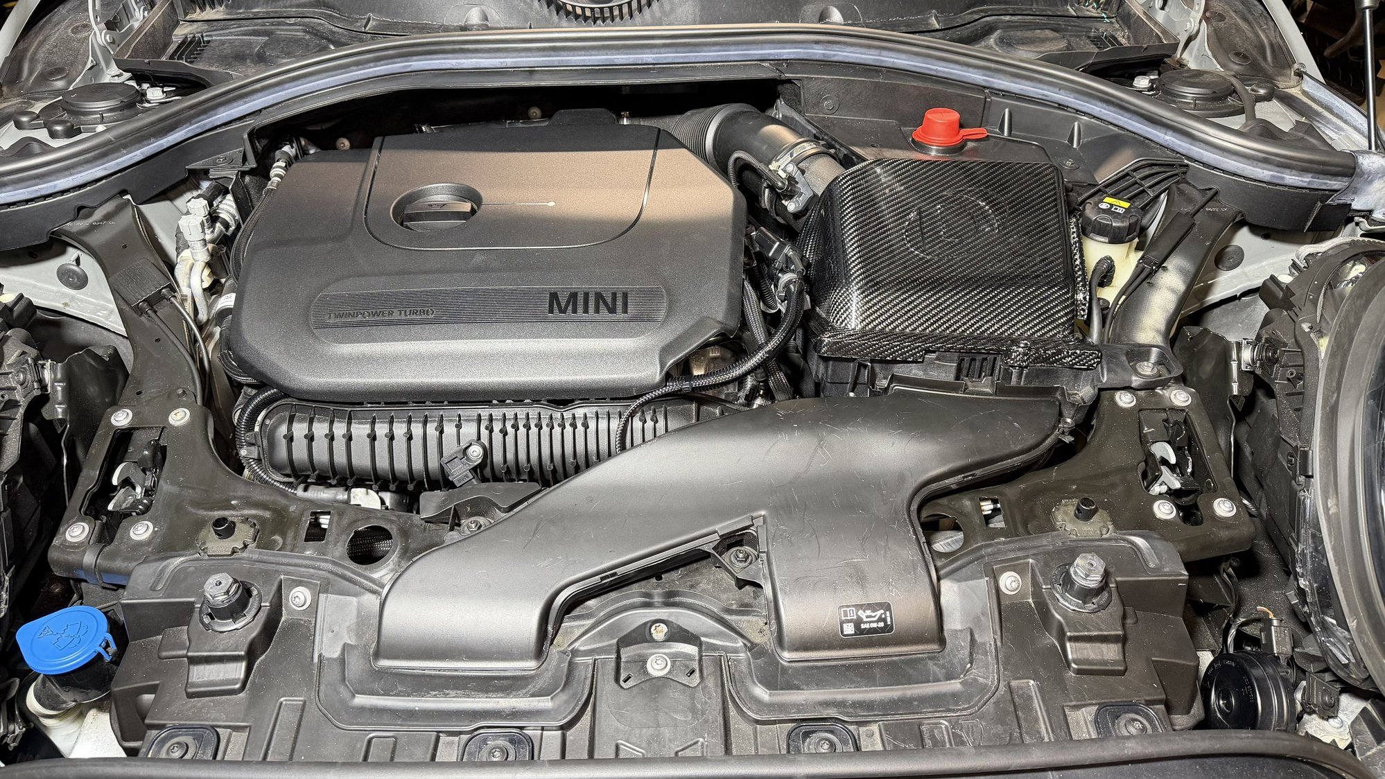

Found this interesting…. I opened up my airbox this morning to swap out the air filter, and found that the airbox has a small valve on the back side. Is this just a JCW thing? I don’t remember hearing this valve being mentioned before. It was all junked and sticky, so I pulled it out and cleaned it up so it moved pretty freely. Is this a noise release valve? Thoughts?
