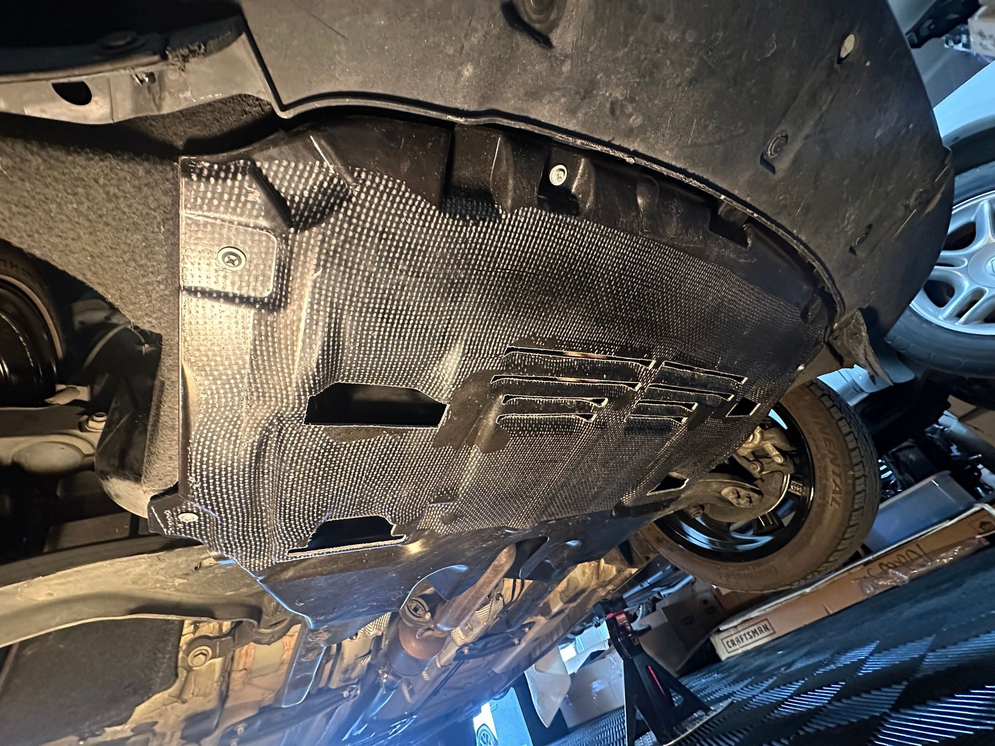

Full Lower Engine Cover
Finally got around to installing the Mini full lower engine cover. Removed the stock short belt cover/protector. Bought it and the additional hardware from Mini Parts Direct, and was an easy install.

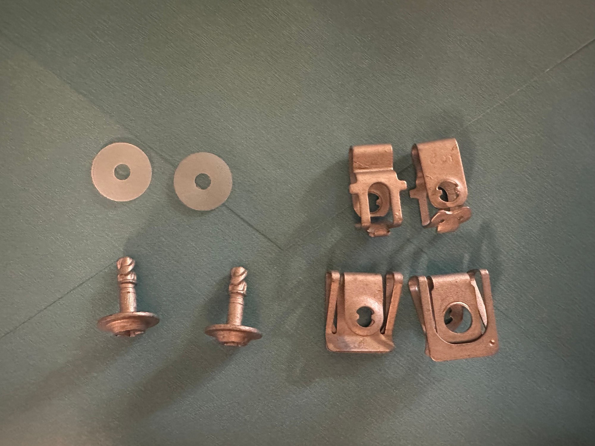

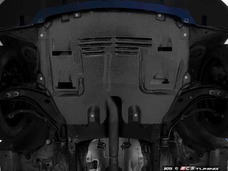

@Velcross
Still learning about MINI and the new to us (my wife's car) R59. When I changed the oil and filter a few months back, I noticed there wasn't a full lower engine cover, only ine off to the side to protect the belts. The lower front coolant hose looks low enought to possiblly scrape on something, so I looked into a full cover, and bought one new off ebay that stated it would fit. Before I received it, @njaremka informed me that it wouldn't fit. I received a full refund. ESC Tuning, sells this lower cover, as does a few other places, and you can even buy it from a MINI Dealer. Not knowing what It came with I ordered all of the fasteners, but that's OK I have spares just in case.
These are the items I purchased.
Amount and type of hardware I actually needed:
Actual Cover, showing all fasteners. I really only needed the front 2 quick release screws, 2 plastic washers, and 2 fender liner u-nuts, and 2 frame hole clips.
Look under your MINI to see what you currently have in the way of hardware, as you may or may not need all that I purchased. Now I have peace of mind, but realize I have to remove the cover to change the oil, as there are not any holes for this.

Since you remove that panel every oil change, it's good to have some spare clips and fasteners.

Any idea if that panel will do anything for drag/gas mileage?

There’s no measurable gas mileage difference that I think you could get. I got it to protect the underside from debris.

In my experience, it added a point or two in fuel mileage improvement on my old R55 Clubman.

Yep my old R56 MINI Cooper was one of the first car to test this, once the GP2 came out we ordered the part and tested it in our shop.
Thats the old install shots on my blue R56 MINI Cooper S. We also testes it on a white R56 MINI Cooper.
https://www.northamericanmotoring.co...y-pan-kit.html

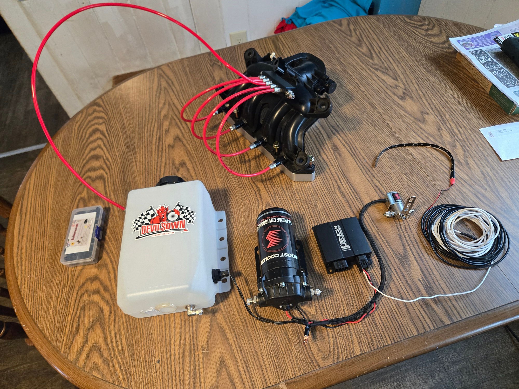

Hoping to install my Direct Port Meth Kit in my R60 today + tomorrow (Its raining at the moment)! Just finished putting together the wiring, hoses, tank, nozzles, and fittings.
Im going a slightly different route than what I originally wanted. I wanted a sleek inline 5 port block but then I found that the ports will get unequal flow...so I came up with this idea:
instead of having a inline 5 port block with one inlet on one side, why not split the line with the "T" Fitting and then use a 7 port block, having the flow coming in both ends - giving equal flow across the board.
The 2 outer ports on each side will go to the intake manifold, while the center port will lead to the 5th nozzle...its just more fittings and what not to accomplish. I really wish there was a 5 port showerhead block out there but I can only find 4 or 6 ports...maybe in the future Ill get a 6 port and block one port off to clean up the design.
This is the look I wanted but with a 5th line coming out of the opposing end:
Most of this will now be hidden behind the bulkhead. In my head I thought I would be able to have the "T" Fitting poke out of the bulkhead, have the lines go around the intake box on both sides, then have the distribution block mounted on the front face of the intake box....unfortunately there was more room in my head than reality. So now I will have it all behind the bulkhead, having each of the nozzle lines come through and go to there intended places. I hope it looks as nice as Im picturing it....in the future if this does work out, I will be replacing all the nylon hose with AN4 lines and fittings to spice up the look more....I didnt want hardlines because I didnt trust myself to bend them as nicely as Prometh shows and I couldnt justify another $300 in lines after spending the insane amount I did building this kit....I basically bought double what is shown here due to things not fitting or working originally - so I basically have an future kit aside from another tank, pump, and controller for my R56.
Off to do some work!
