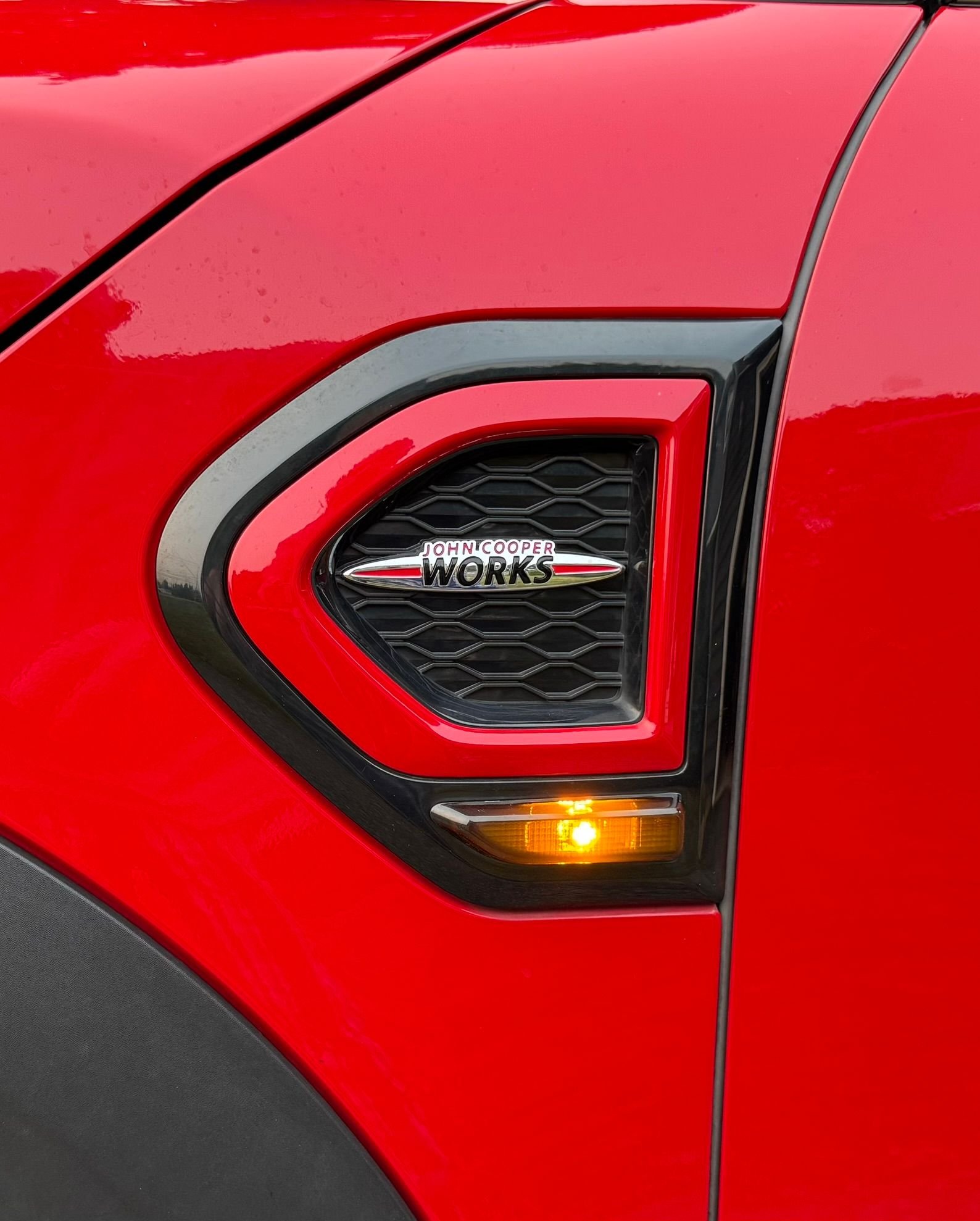

Oil and filter change.
Then, swapped out my side markers for some smoke versions, and added LED bulbs

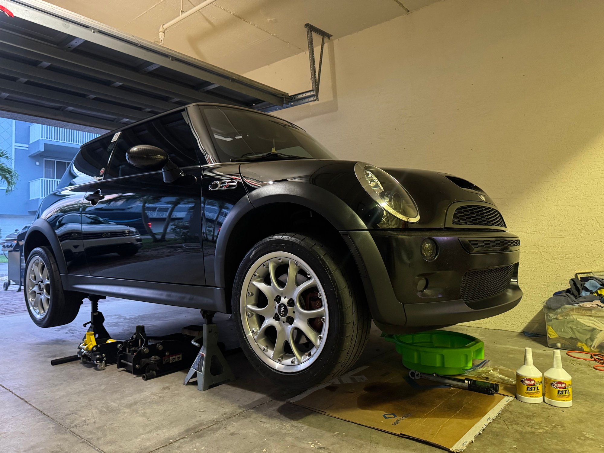

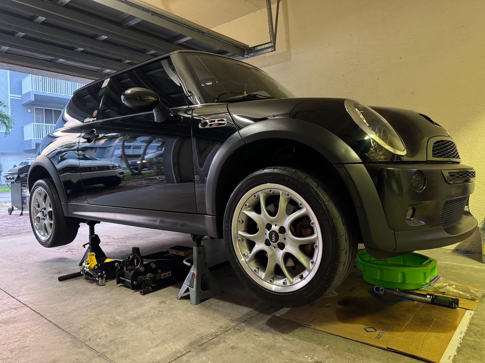

What could I possibly be getting ready to do?
Been 30,000 and it’s time. And yes she is clean pre working on her.
Got up early this morning, can’t sleep anyway, started the coffee and went down and popped both plugs. Come up make my coffee and headed back down. Pumped fluid back in, cleaned everything up and back on the ground in an half hour. Just enough time for the coffee to cool down, easy peasy.
Next time I’ll just do it with an oil change, and just kill 2 birds with one stone, but it was time.

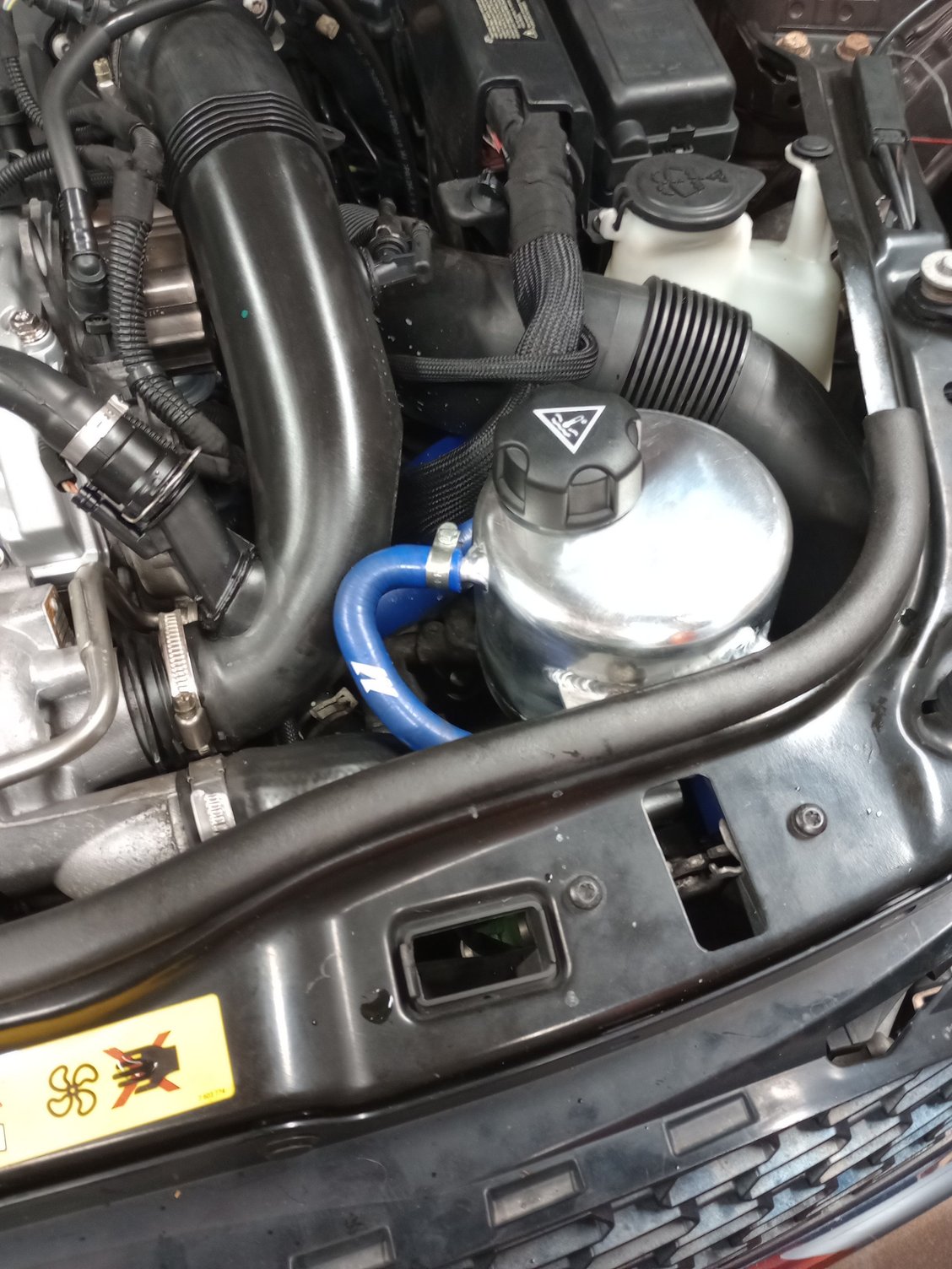

Oil change and expansion tank replacement on the Recluse. When I was installing the valve cover last week, I bumped the small hose enough to snap the outlet nipple off. Fortunately there was enough left to still connect the hose and drive. Decided to 'upgrade' to one of those aluminum expansion tanks.
snapped nipple
snapped nipple
Looks good enough
Looks good enough
sight glass to check level
Oil change was due anyhow, so perfect time to swap out. Install smooth, looks good. Can't see that there will be any issues, and I won't have to worry about this happening again. Personally, prefer the aluminum look over the ugly yellowing plastic. I actually wanted to relocate this to alleviate the issue of having to remove for filter service, but where the heck would it go.
hose is tight, but it clears.
you can see the level, was worried about the positioning but it works.

@spaktacular - Nice placement and it's awesome to also note how clean you've kept your engine.
My philosophy - "If it's dirty on the ouside ; one can only imagine how dirty it must be on the inside".

I do 98% of my own repairs, and it just sucks working on a filthy engine. Of course some dirt/grime can't be avoided.

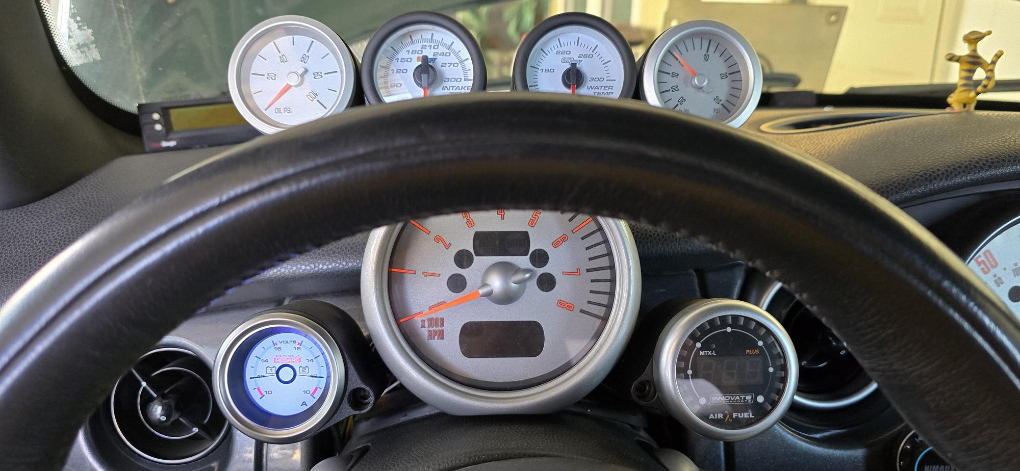

Moar gauges!!!!
Battery 13V, water pump 12.7V@8A.
Gauge beeps and red-screens the backlighting if the voltage at either drops too low.

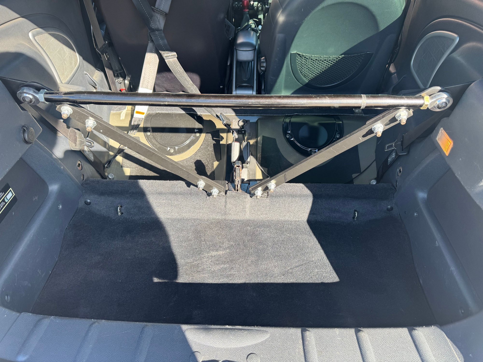

Originally Posted by Jason Cornelius
Just another beach day, got my spot.

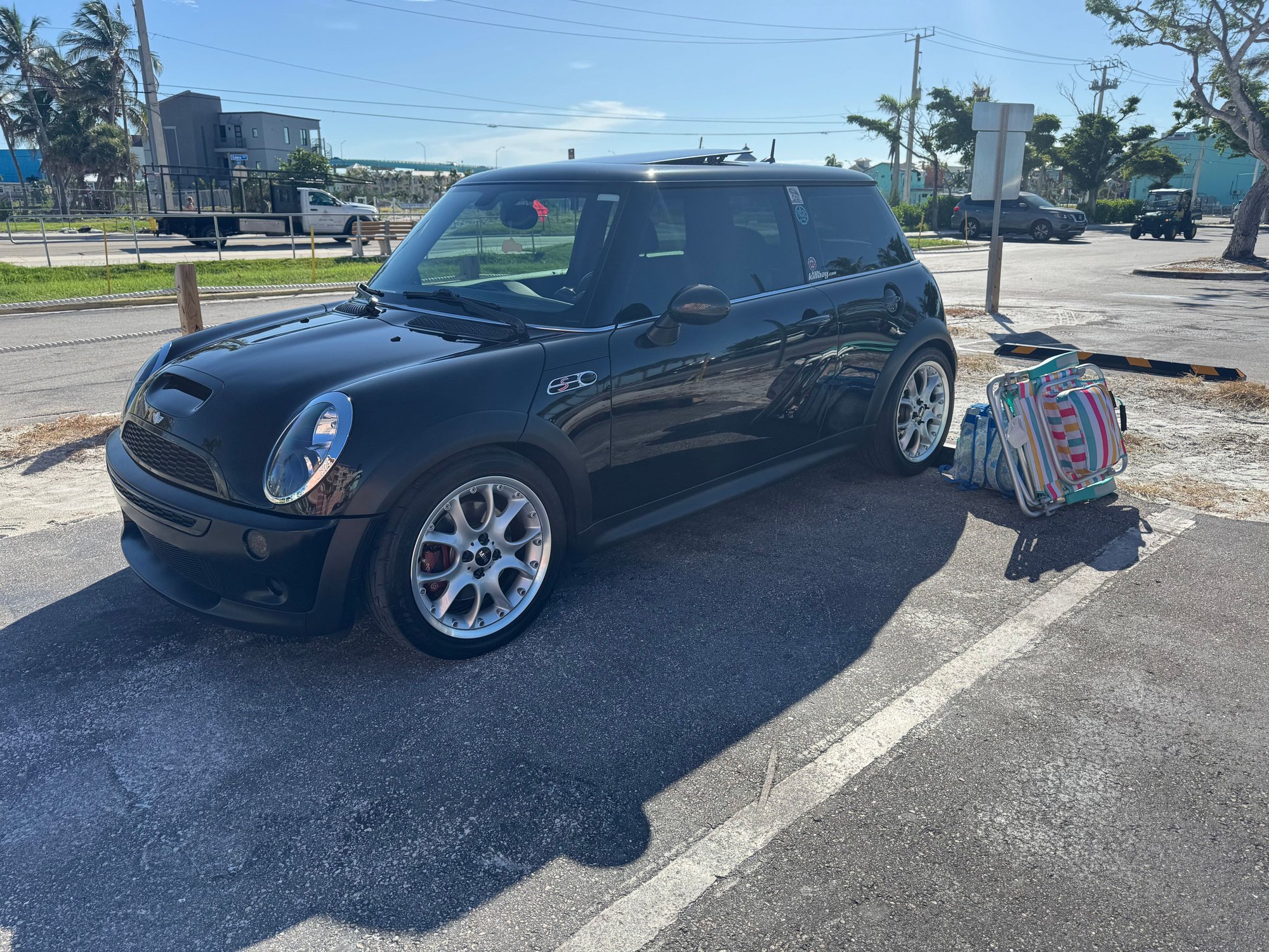

Is that M7 rear brace? Can you give review of this brace please? I'm thinking about getting it!
I’m pretty sure it’s a first version M7. I bought it used off FB and that is what I was told. It has been in my R55s and currently in my r53. It greatly reduced the body roll the clubman tends to have, which kept that thing a bit flatter in and out of turns. The R53 on the other hand, I never really had that issue, I think the cabrio braces did more with stiffing the front, but not why we are here. The R53, to me, feels like a better built, non squeaky, rattly mess, like the R55s, but she has had all these braces within the first month of ownership. As you can see though it gets in the way, but I can still pack the car for 2 for a day at the beach so I make it work.

Is that an Aliexpress tank?

I bought on Ebay, but it's likely the same thing. Have had no issues with it, about 2000 miles in now.

I have the same tank. Solid, works well, cold level settles in nicely around the height of the welded seam near the bottom with my car. Wish it had two sightglasses. Had to grind a bit off the power steering pump mounting bracket to ensure the hose didn't rub, because sillycone hoses are thicker....

Different location on the Gen II cars, and of course there is no power steering pump to deal with
