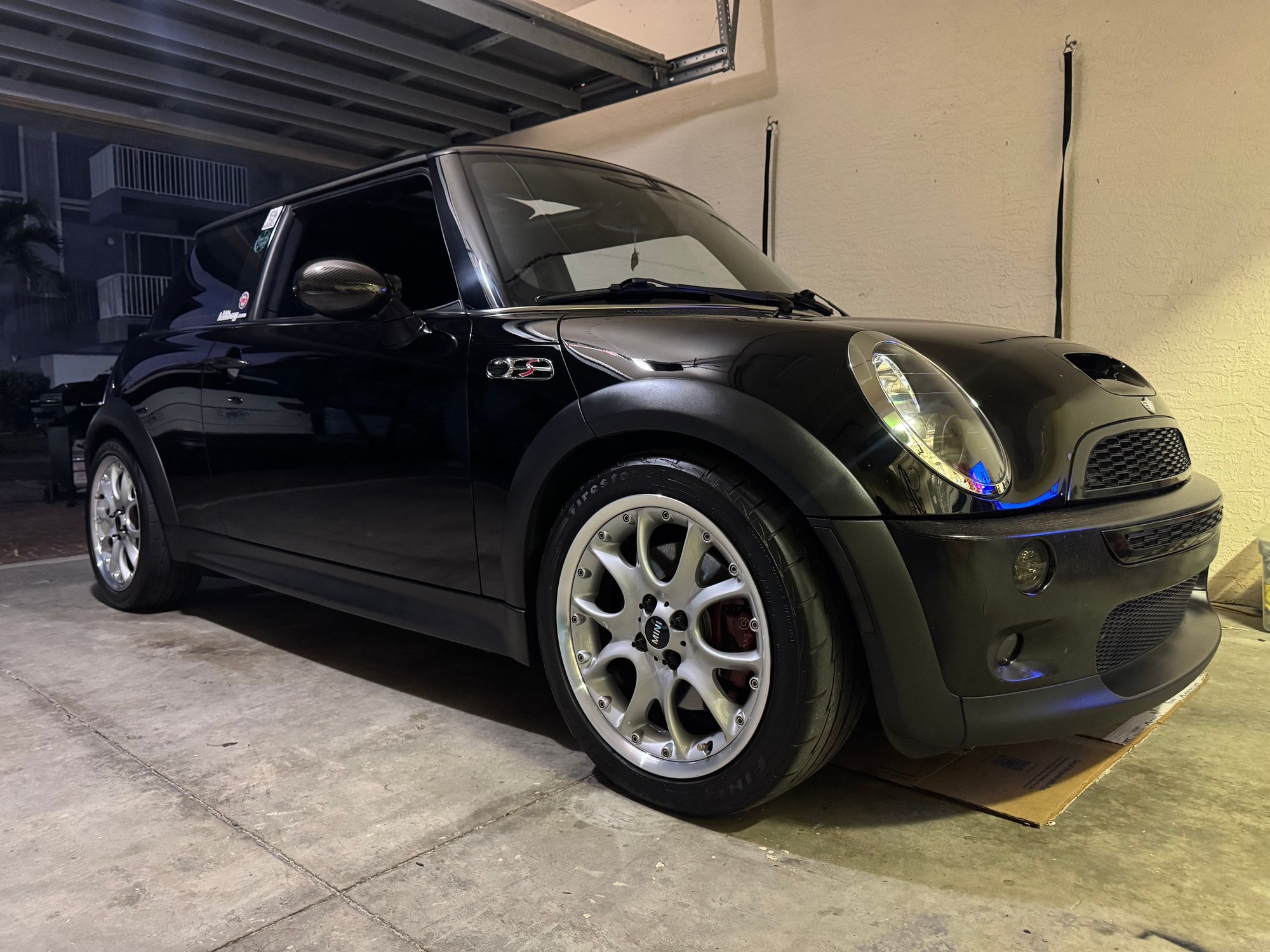

Took the wife out to lunch today in Santa Barbara, took the long way home and found a nice spot to take some pics. The long drive gave the suspension time to settle out.
Great pics
Im bias, but really nice car
Looks fantastic!!

Ditto, looks good with the lower grill trim painted black.

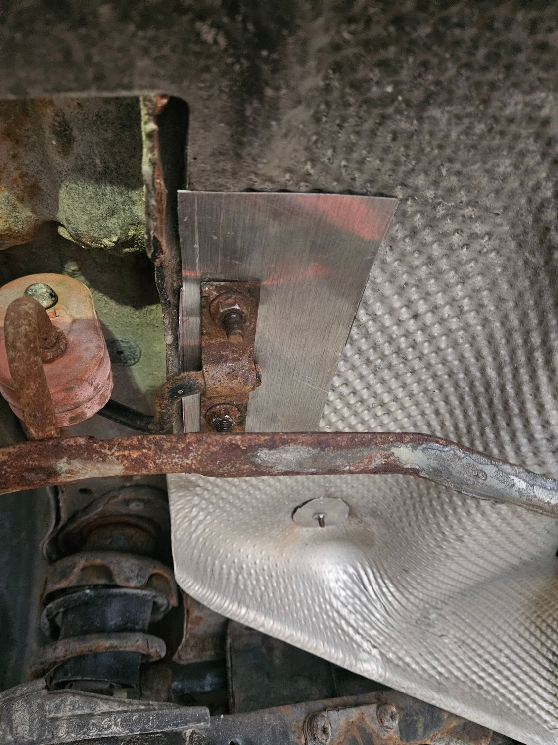

Right CV axle replaced and exhaust work
I finished replacing the passenger/right CV axle today. I used a Duralast 10661N from Autozone for the lifetime warranty. I did notice that the Duralast's outer CV boot had more pleats (6 vs 4) than on the one I removed (I'm not sure if it was OE). The boot on the inner joint had cracked and was weeping grease on the failed axle. The grease was liquified, too.
Then, I reattached the rear exhaust heat shields (after removing the Sports-Link hitch). I used large aluminum washers that I punched out of sheet to cover the areas that corroded through, and then made a large plate for under the exhaust hangers.
I used an aluminum pop rivet on each side of the battery box to join the heat shield halves there, and then the large aluminum washer. A stainless, metric push nut holds everything in place on the original studs from the body.
I also replaced the rear bumper cover with a color-matched one I retrieved from a parts car earlier in the summer. All the parking sensors are now hot orange, again 🧡.

The last repair was to cut about a 1/2" of length out of the joint I made when I replaced the mufflers a couple of years ago. I could never get the exhaust adjusted right to keep it from making contact with the reinforcement brace under the car at the back of the exhaust tunnel on the convertible body. Removing that little bit of length allowed the center pipe to shift up enough to provide some clearance - the background noise in the cabin is much quieter driving down the road now 🙂

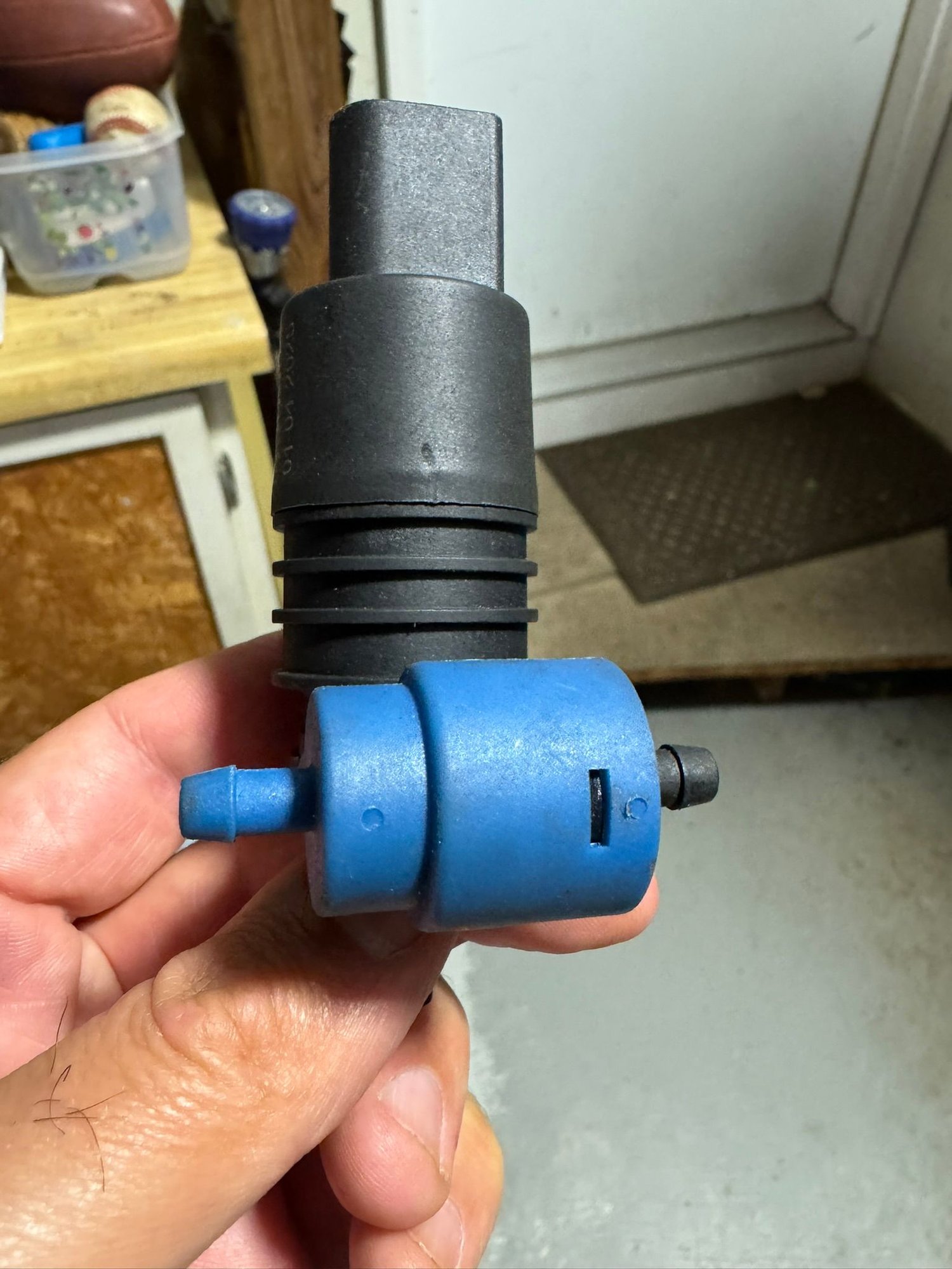

Yesterday, replaced my windshield washer pump. The old one was leaking, and wouldn't hold fluid in the tank for more than a day or two. Bought a new Bremen pump from ECS, and the nozzles were the wrong shape, which wouldn't allow the hoses to clip on. Fail. The pump I received didn't even look like the pictures in the listing.
Found online that Napa had a pump that looked like it was compatible. Purchased that one, and when it came in found it had all the same markings and manufacturer codes as the OEM pump, with the exception of any BMW identifiers. If any 3rd gen owners need a new washer pump, here you go:
https://www.napaonline.com/en/p/ECHWWP124

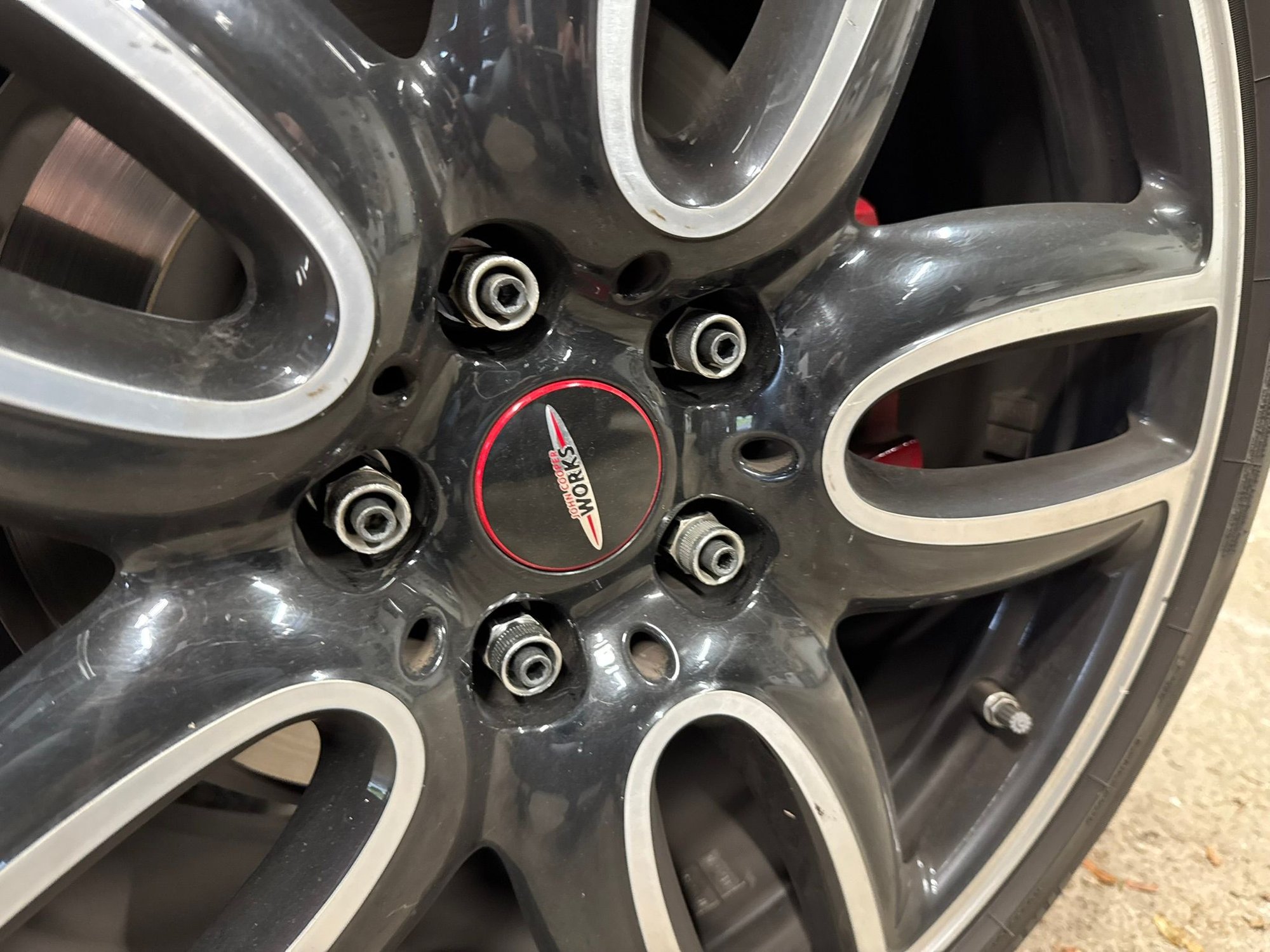

Also yesterday, I swapped out my lug bolts for lug studs. Went with a 14mm x 12mm conversion so I could use 12x1.5 lug nuts. Studs are long enough for me to run the 15mm spacers required for my winter setup, too.
This is the stud kit I used:
https://motorsporthardware.com/produ...-of-lugs=5-Lug

Hello,
https://www.ecstuning.com/b-bremmen-...27388349~oem~/
Was that the washer pump?

That is what I ordered.
Here is what I received, inside a Bremmen labeled box:
Clearly, not what was pictured in the listing. And, due to the shape of the hose connections, the hoses would not clip onto that pump. I was authorized to return it, but at my cost for shipping. At $14, I'm calling it a loss.

Thanks, when we get it back we will inspect to OEM and figure it out my guess is the wrong one came into that stock.
It went to the landfill
