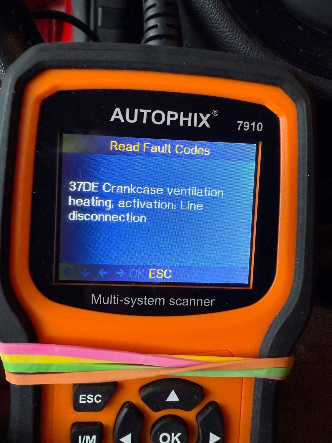

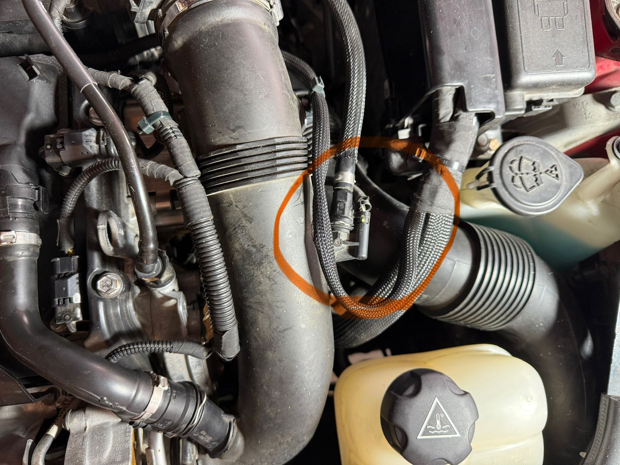

Changed the starter, small space for every set of hands
Despite watching several videos that indicated starter removal was possible from underneath, that possibility had completely eluded me. I eventually removed the air intake off the rear of the engine. It was the only was I could facilitate the removal and replacement
But, now I need to track down the source of a code. I need to locate the cause of the CEL 37DE crankcase ventilation heating, activation line disconnection. I have checked and rechecked connections and will attempt to do so again today.
I’ve searched the web and several forums. Nothing I found was 100% definitive. Any available insight into this from anyone in the know, is appreciated.
Happy Sunday
Old Oct 26, 2025 | 04:46 PM
  #23755
Velcross's Avatar
Velcross
Joined: Jan 2025
Posts: 96
Likes: 58
From: Canada
HMMMM
I dug a lot deeper and was able to correct the issue.
I made the incorrect assumption that I had reconnected everything correctly. After I spent the afternoon reading up on this, everything pointed to a connection that was not seated as it should have been. That was indeed correct. I pushed and correctly seated the two wire connector circled in orange and code 37DE went away. Cleared the code, ran it a few cycles and checked with scanner.
All good now.
So simple and so easy to overlook.
Big thanks to everyone that had posted about this across every forum. I learned from all of you and saved myself quite a few $$$ by not having to take it in for a diagnosis.

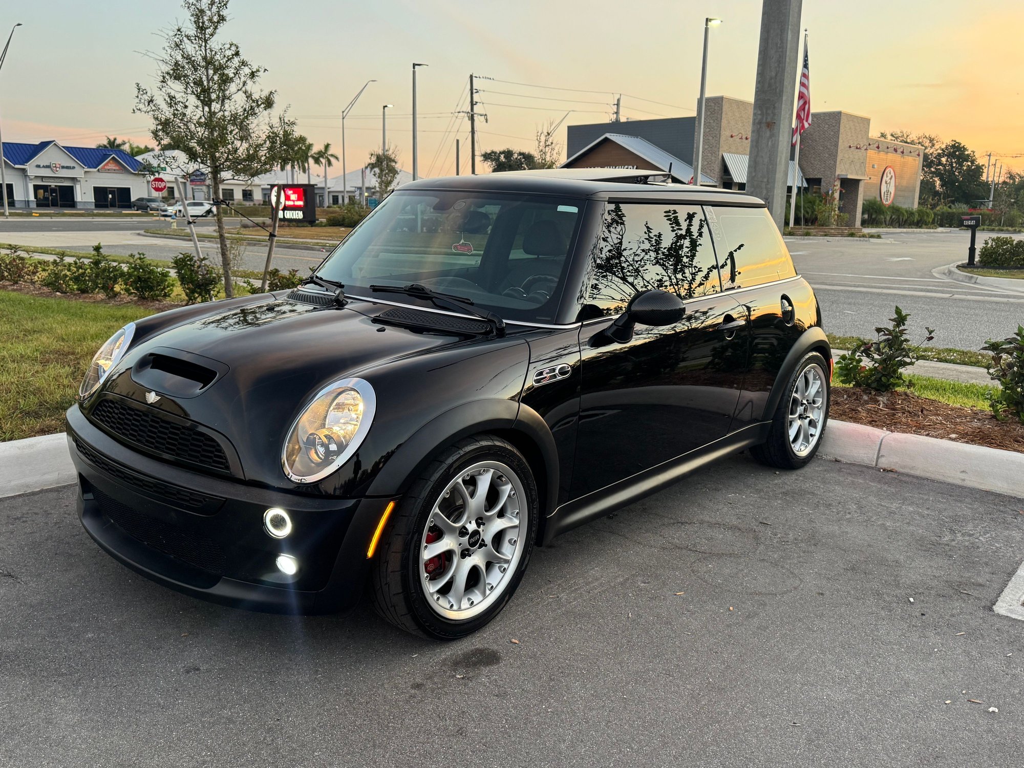

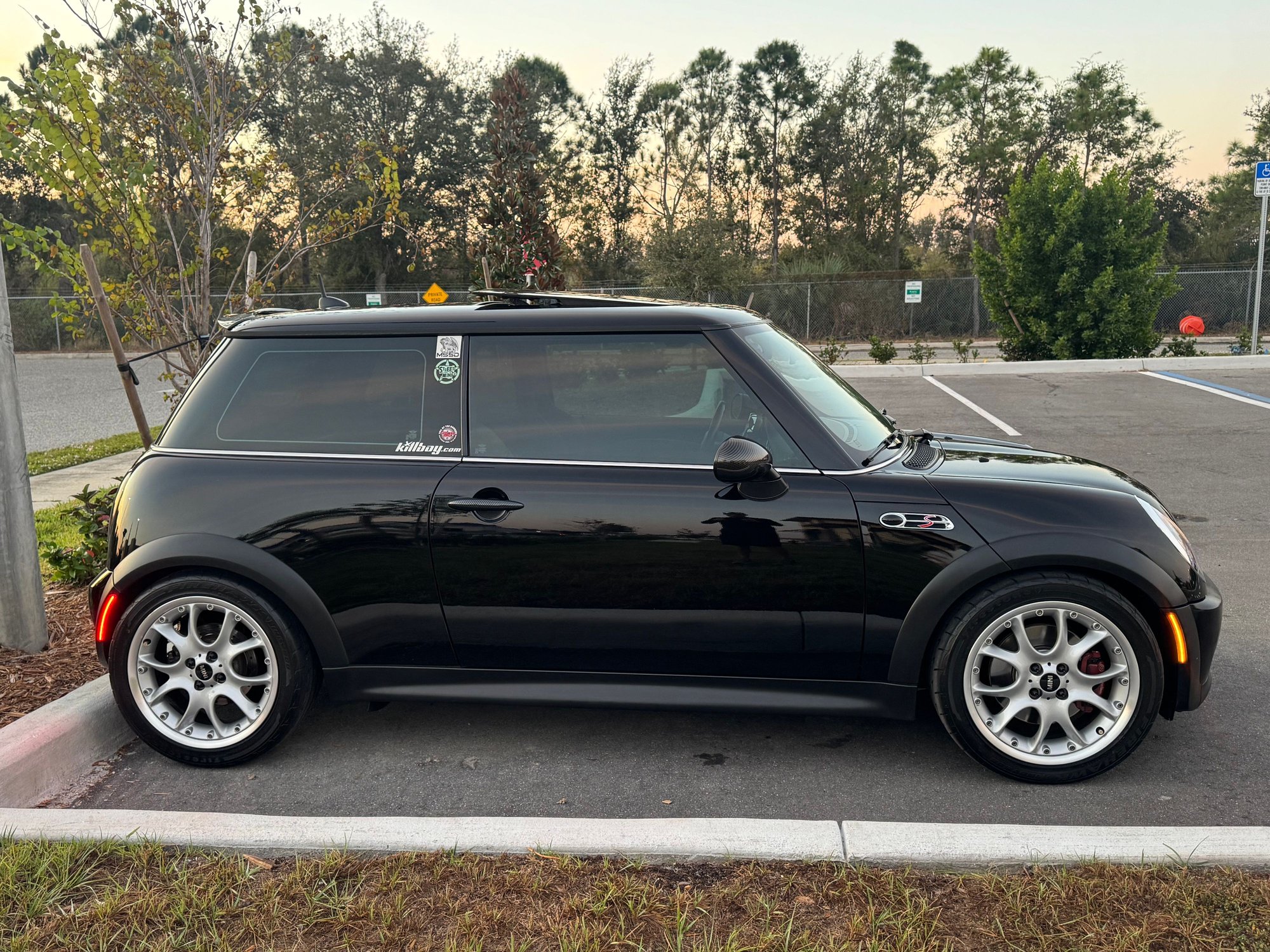

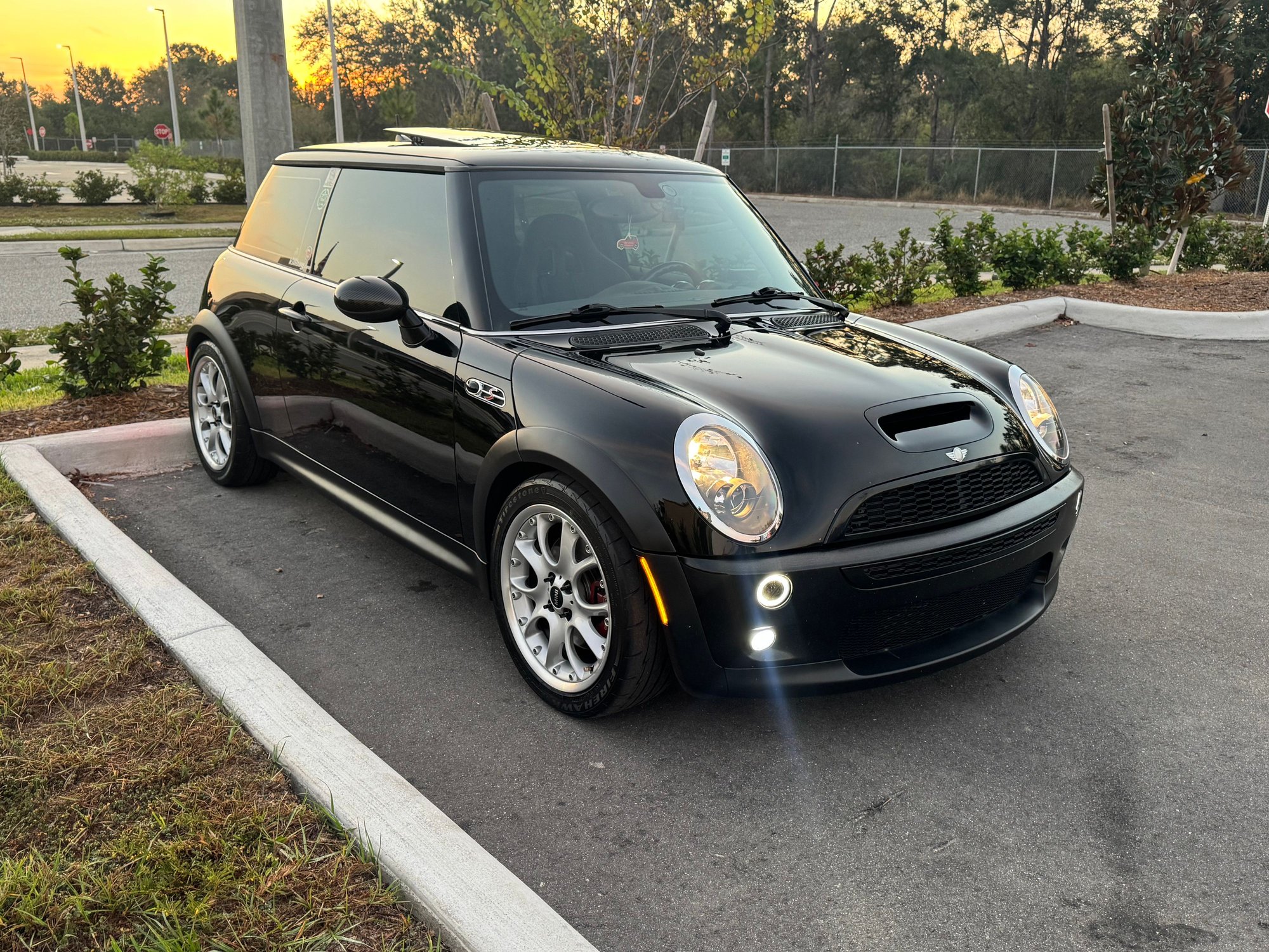

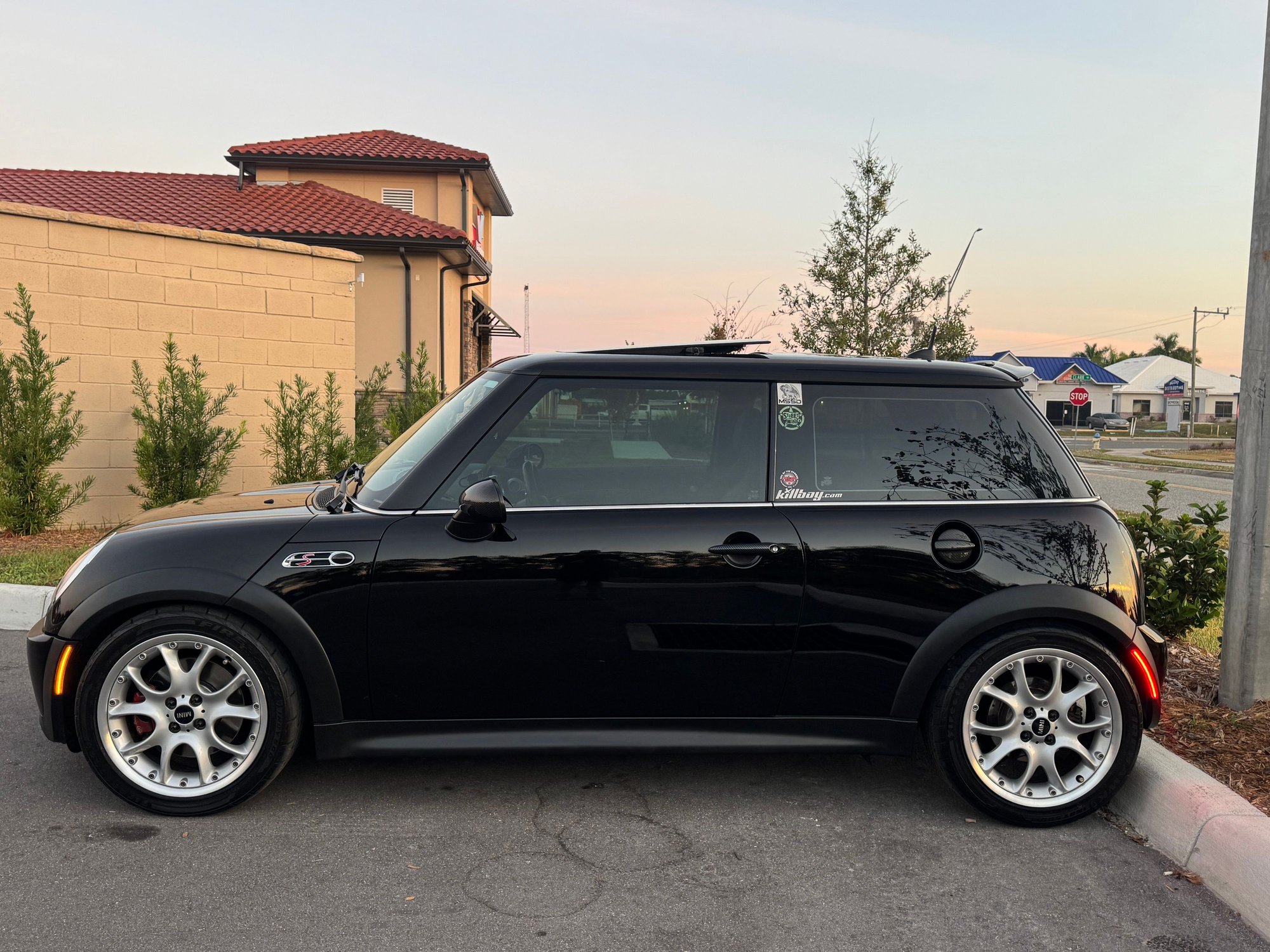

I Got The Power -
Back!
Not today buy Yesterday - After blowing my CAT about a month or so ago; I finally acquired an OEM manifold and CAT purchased from one of our kindred Mini contributors here on NAM.
If you'd ever had your CAT come apart internally; I don't have to tell you what an annoyance that unsettling and obstreperous constant noise it makes rattling around inside the canister.
Not to mention the havoc it plays with performance and gas mileage..(and more). Anyway....
After a weeks wait I received my "new to me" low mileage CAT from our friend (@2out2sea), here on NAM...
 Looks pretty good to me.
A quick rust inhibitor bath with Ospho...
Then on-to a 25 min drive down to the valley to my go-to place to work on my Mini - Walmart parking lot...
I finally managed to extract my original 22y/o manifold/CAT. My Mini is pretty much free of rust. Even though I'd PB Blasted - every nut and bolt was effortlessly removed and without incident
Top: My original - Below:
Top: My original - Below: "new to me" replacement
Needless to say it was a long 6 hour day for a first timer, rolling around under and stretched over the engine of my Mini to finally get this thing taken care of once (hopefully), and for all.
On a final note: It is amazing to me how I'd had almost forgotten how much power my Mini has while driving around with that failed clanking CAT for the last 200+ miles.
I must say; The one noticeable difference (since before the CAT failure) is the sound.
It is much more, yet pleasant - "throatier" sound than I recall. Sounds a bit more subtly performance. Without the overly obnoxious, nuisance "racer boy" wannabe sound...(just one old man's opinion).
With that accomplished, said and done...the only question remains....Where to now to my next adventure?
