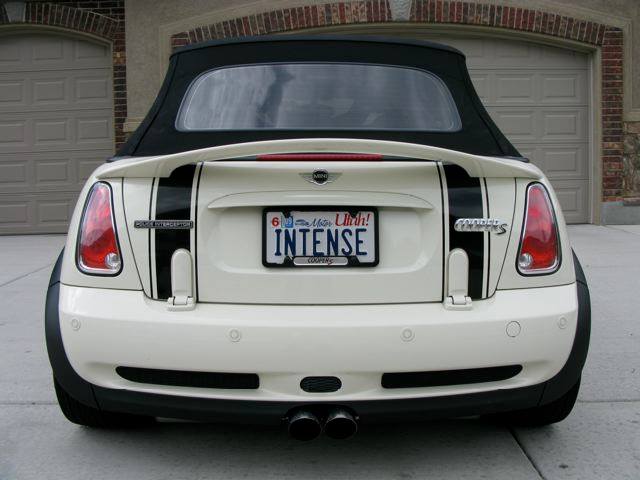

I've worked and enjoyed fabricating with fiberglass for nearly half of my life as well as in my former career. I absolutely detest all these aftermarket body "add-ons" made of PUR these days.
This is a project I've been looking forward to doing for quite some time now.
While not necessarily "today" - I designed and fabricated my lower "duckbill" rear hatch spoiler in the beginning of February.
Because of the colder temperatures; I waited 3weeks to ensure that all the chemical products have fully cured.
Today was a beautiful sunny 61°. I took the opportunity to finally install it.
I didn't document all of the process. This is not a "how to" as it is more of an experiment...(in which I may elaborate upon in a future post).
I initially started off by cutting and shaping a piece of foamcore to the curve underneath the back window of the hatch.
My intentions were aimed at creating a simple duckbill design. Having been somewhat satisfied - I moved on to fiberglass.
A few hours of lay-up, sanding, prep & paint...
I mounted the finished duckbill to the back hatch of my Mini.
12 hours labor, $70 materials (pro rated) and 3weeks total cure time during the process.
I'll lay the vinyl stripes in a couple of weeks when the weather stabilizes and the spoiler has a chance to acclimate.
Aesthetically, I think it would look nicer if it was made wider to go the full width of the hatch. I was fortunate enough to get a West Coast Mini mid hatch wing, which was one of about three designs available back in the day. Mine mimics the top spoiler, and was my favorite out of the styles available, though they were really designed for the convertible, which lack a spoiler.
Attached Thumbnails What did you do to your mini today?-6d9514a5-a7dc-4985-bd19-a732f859f630.jpeg   What did you do to your mini today?-e39c1467-19a3-4d93-9555-b9c259ffafad.jpeg
Nope. I made a conscience decision not to. I am thoroughly happy with my results.

Great work, as always. Looks factory. How is it attached to the hatch? Does this change the airflow such that the rear window will stay cleaner?
Thanks.
2wo hidden mechanical attachment points and a few strategically placed strips of 3M VHB double sided.
Observing from the rearview; the exhaust vapor from below is diverted and dissapated away from the hatch. Sadly, No- the duckbill does nothing as a deterrent to the accumulation of dirt against the rear hatch.
