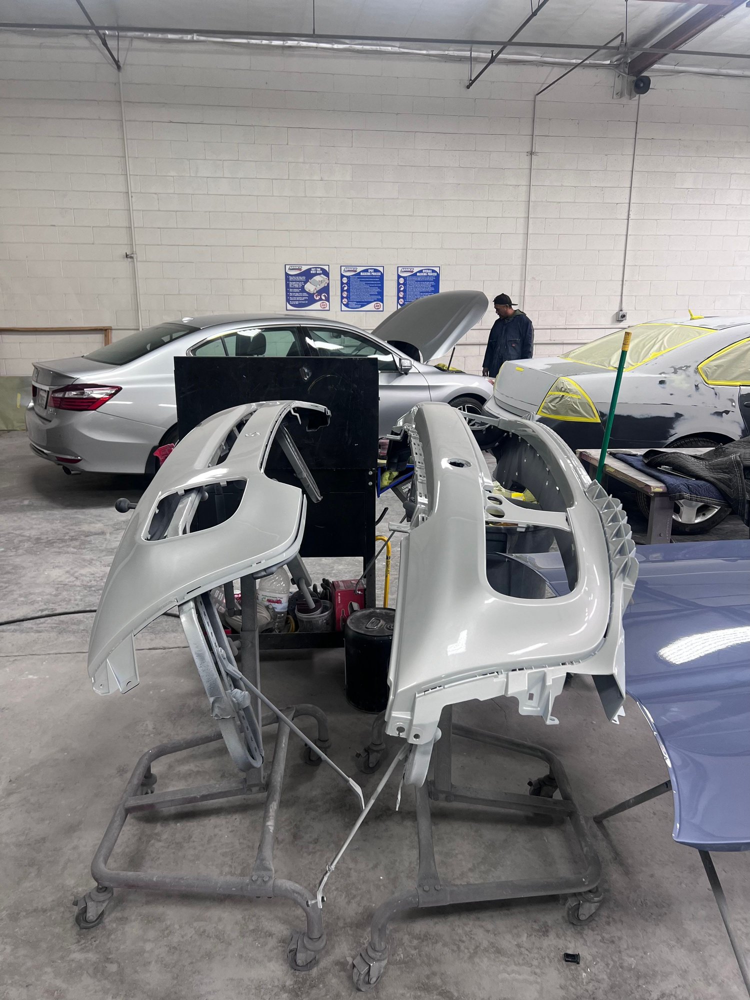

Got my JCW pieces back from the body shop and will hopefully finish installing everything in the next day or two.

Thanks, I'm still waiting for customer service rep to get back to me about missing pieces from the JCW Aero Kit. The description says it includes the brake duct kit but it was missing.

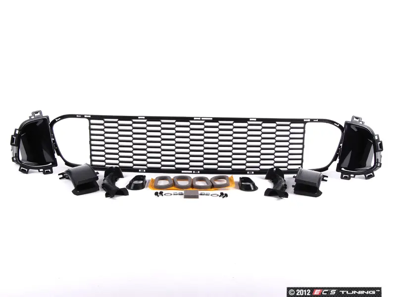

Hello,
Thats our ECS kit?
https://www.ecstuning.com/b-ecs-part...192154643~ecs/
If so the brake ducts are included as you can see, but they are not like the old full brake duct kit that now nla. They are just the front portion as seen in the pics.
The full brake duct that goes to the wheel well is NLA from MINI and the suppliers never made that connection kit. What you do is trim the wheel well fabric like the old JCW brake kit MINI used to sell. Maybe i bit larger. You just dont have that short brake hard plastic section.
You can see the additional ducts here. https://www.ecstuning.com/b-genuine-...t/51192153998/
https://www.northamericanmotoring.co...-bumper-2.html
Install PDF of the old NLA to help you if you want to mod to make your own set up.
https://www.northamericanmotoring.co...-air-duct.html

If you have an LCI Cooper S front bumper with the brake ducts already, then you only need the front brake ducts:
https://www.ecstuning.com/b-genuine-...t/51747283343/
https://www.ecstuning.com/b-genuine-...t/51747283344/
The trim pieces that come with the kit fit into the bumper grill, the ducts linked here clip to the back of the trim pieces, then your existing rear duct sections are reused.

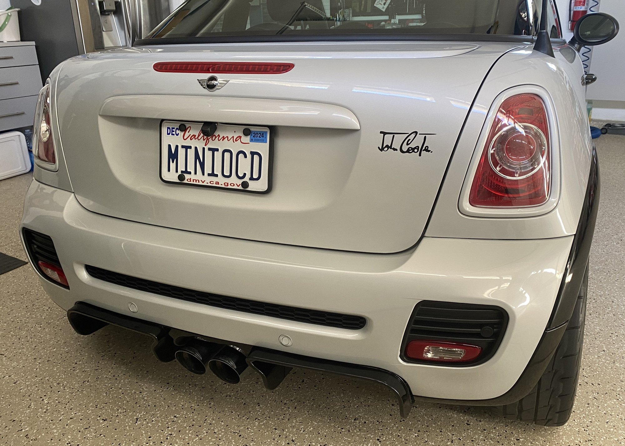

Finished putting everything together and installed Aeroforce gauge instead of the digital cluster. Painted the grill-headlight-taillight trim same as body color.
