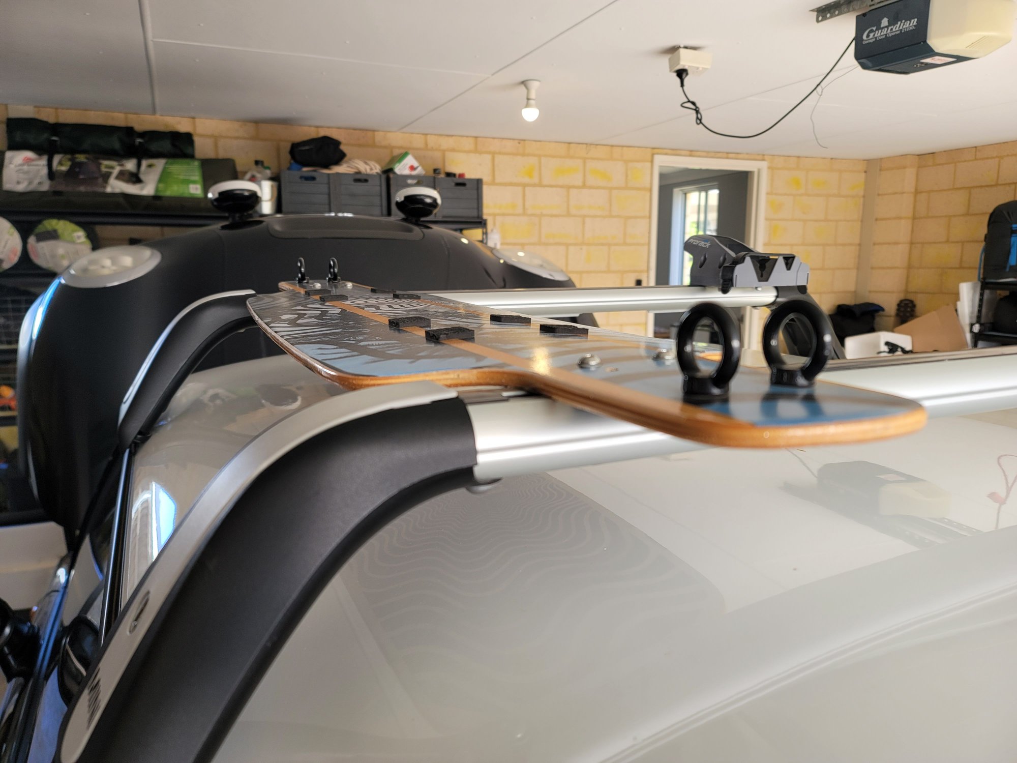

Thought I'd add a few more photos including my r56 roof gutters and roof rack. I have fishing rod holders on the roof rack as well as a longboard skateboard that I use to strap down my Maxtrax Mini recovery tracks (I go camping in my mini & it tends to get bogged easily).

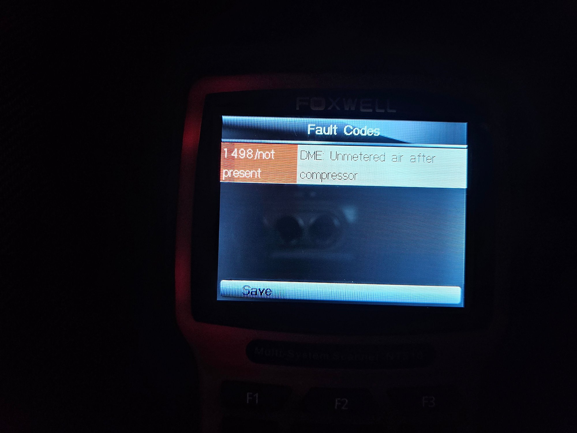

I finished a bunch of work on our R52S yesterday: oil & filter change, rear turn signal and front DRL bulb replacements, swapped on the Winter tires, and tackled a P1498 error (Unmetered Air after the compressor/supercharger).
I do have a question on P1498: I found that the fitting at the end of the vacuum line that connects to the nipple off of the supercharger-to-intercooler pipe had loosened and the hose slipped off. I used 3.5mm I.D. silicone tubing to fit the vacuum line back to the nipple. HOWEVER, I cannot get P1498 to clear/erase, even though when I read the DTC with my Foxwell NT510 it reads as "1498 - no present". Using both the Foxwell and another OBD2 scanner, neither of them successfully clear the code - they error out. The Foxwell reports back with some sort of ECU communication error.
Anyone have insight into what is happening? I worry there might be another cause for the 1498 code that I have to resolve (I'm going to check the integrity of the air filter-to-throttle body hose, next, as I've read here that a break in the "weld seam" of that part could lead to this code, as well. BUT, if there was another source, then I would think that the code shouldn't show as "not present".

I had the same code pop up back when I'd installed my boost gauge. Same situation = vac leak from the line connection under the right horn. I also have the Foxwell 510 elite. I don't have my notes on hand, but if I recall, the fault code went away by itself after a couple of engine cycles/drives.
That's good to know.
​​​​It's weird that you can't just clear it and clear the warning light.

Oh, wait - Is your SES light still on on the tach?
My SES light went out but the fault code remained in the computer and finally disappeared after a drive or 2wo.
Not related - But I had a similar thing happen with a stupid 5E "steering angle implausible" fault. Nothing I tried would immediately clear the fault. It cleared by itself one day.
Yeah, the SES is still lit, though the 1498 code is read, but with a status "not present". The EML light is no longer lit, though. And I can't clear it (1498) with the diagnostic computers.

BTW, here's a video I took of the location of that nipple on the underside of the right horn of the supercharger to the intercooler. My daughter drove the Mini to work today (about 90miles roundtrip) and although the SES is still lit, she said it ran great.
https://rumble.com/v5tntmh-mini-r52s...3z9pe&mc=av2lu

Yeah - it's weird how well these cars will run; even with a mystery fault code still looming around in the ecu.
Btw: I used the same blue silicone tubing running all the way to my boost gauge. I used the black version to sheath the copper tubing to my oil pressure gauge. 'Stuff is awesome
That may be one of the ones that needs the adaptations reset in the DME to get it to clear out. I had to do that on our R53 after getting a fuel trim fault for the downstream O2 sensor.

P1498 successfully cleared with an NT510, but after some drives and after the fix
Interesting. I'll have to give that a try. I found a video about clearing adaptations on an R56 - that's about the closest I could find with something that may apply to how to perform that with my Foxwell NT510 (non-Elite). I'll give it a go and report back here.
Update: I couldn't find a path to reset adaptations with this NT510 on our R52S, but, I went through the Read Codes and then Erase Codes step again on the Engine ECU and it worked this time!
I was unable to get to this point before, when I tried clearing the code right after I finished the repair of the vacuum line.
I don't know why those steps didn't work before when I tried them (and, I tried with both the NT510 and an Acton OBD2 tool).
My daughter is heading out for a drive now, and we'll see if it successfully stays cleared 🤞

Hey @khnitz , Thanks for posting the steps you took to clear the fault code with the Foxwell. I've just started rooting through all the "hidden" menu's within my 510 Elite. I was always afraid that I'd mess something up since I don't understand what some 'commands' are for/will do.

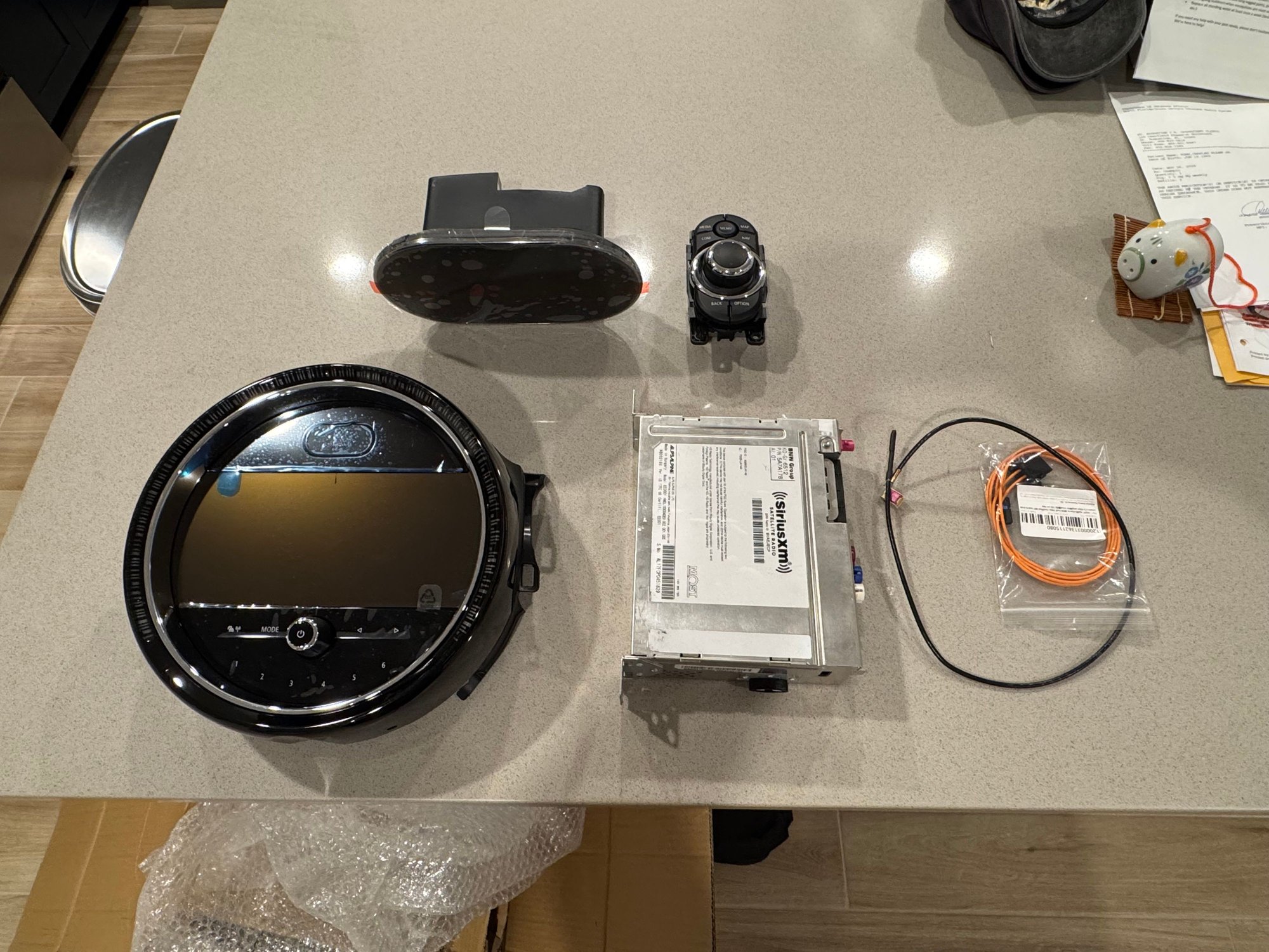

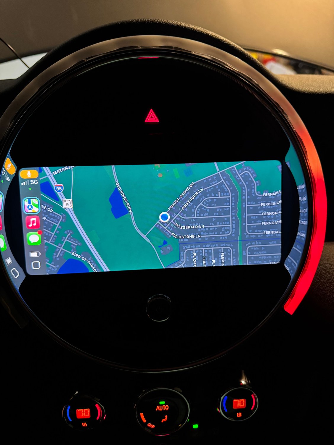

I decided to install a brand new digital gauge display and the new 2023 8.8” Infotainment system in my F56 JCW yesterday. I got everything installed and connected including a new GPS antenna and WiFi antenna used for wireless CarPlay. This is what I received when I purchased brand new components for my install.
The only additional item needing to be ordered was the GPS antenna which was not too hard to source. Once installed this is how everything looks

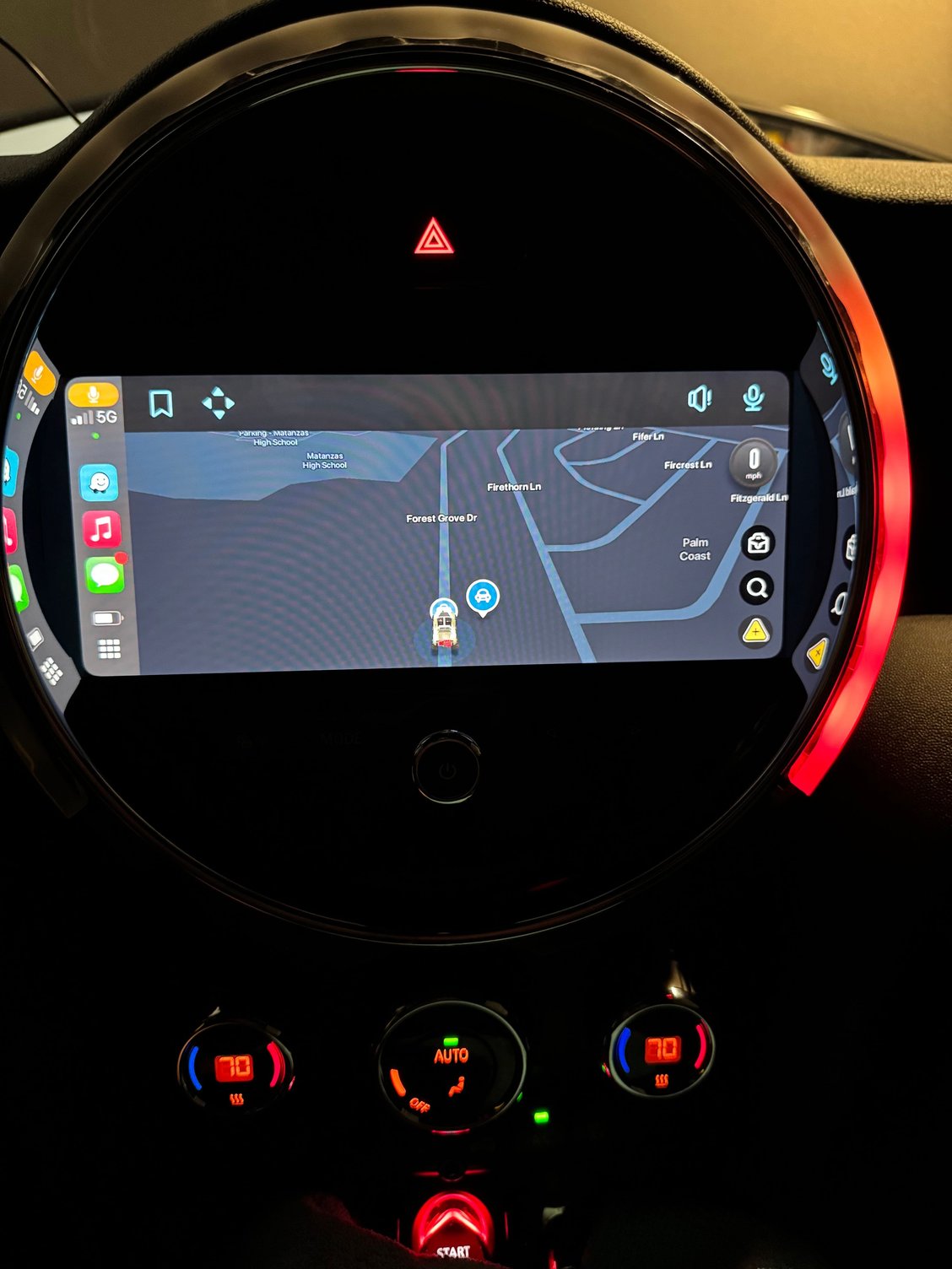

CarPlay activated displaying Apple’s Map app.
CarPlay with the Waze app displayed. This will be the navigation I will primarily be using in my car. The digital gauge display looks like this with errors on it because I still need to have everything coded to complete this upgrade which will be happening today
So far I love the refreshed updated display that I now have with this upgrade and soon everything will be complete. For me this will be one of my most used and favorite upgrade for my JCW

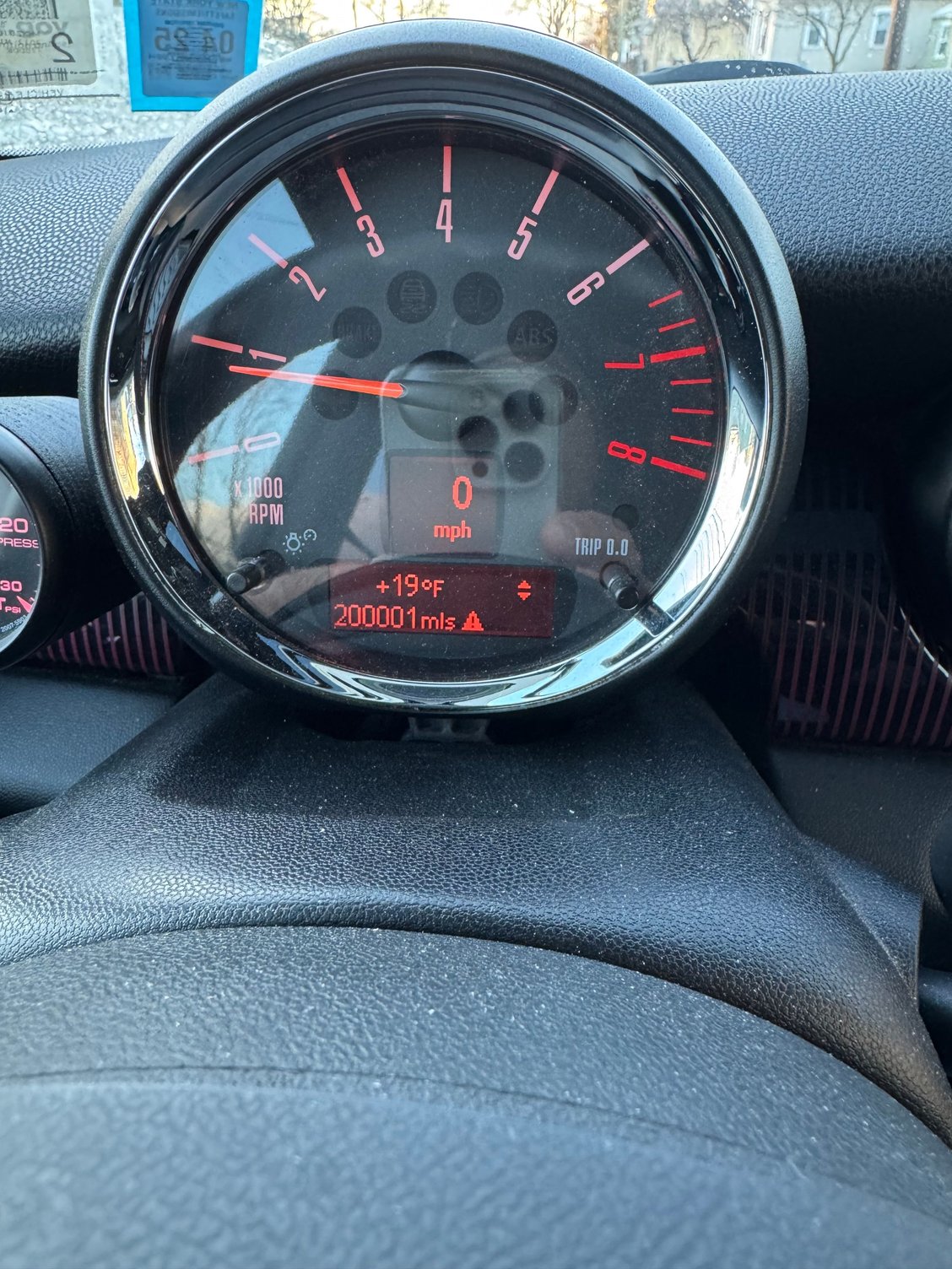

Oil and filter day for me. Oh, and my Clubman is now part of the 200k club
