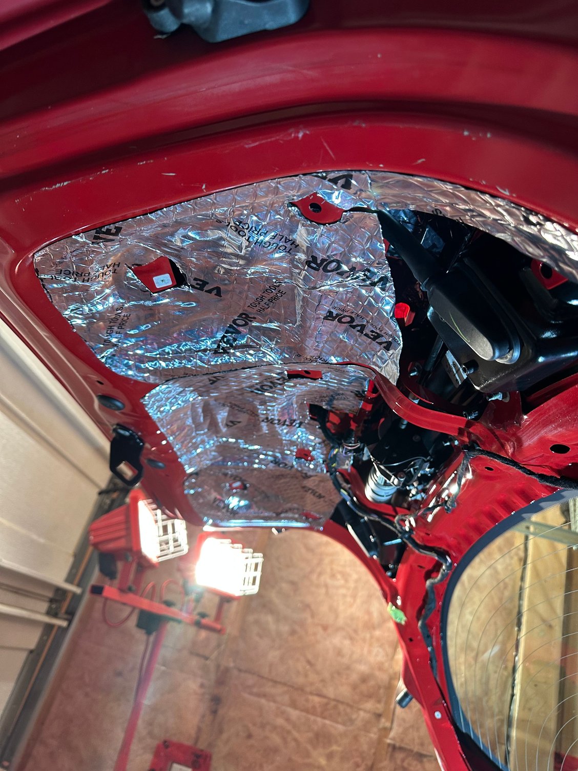

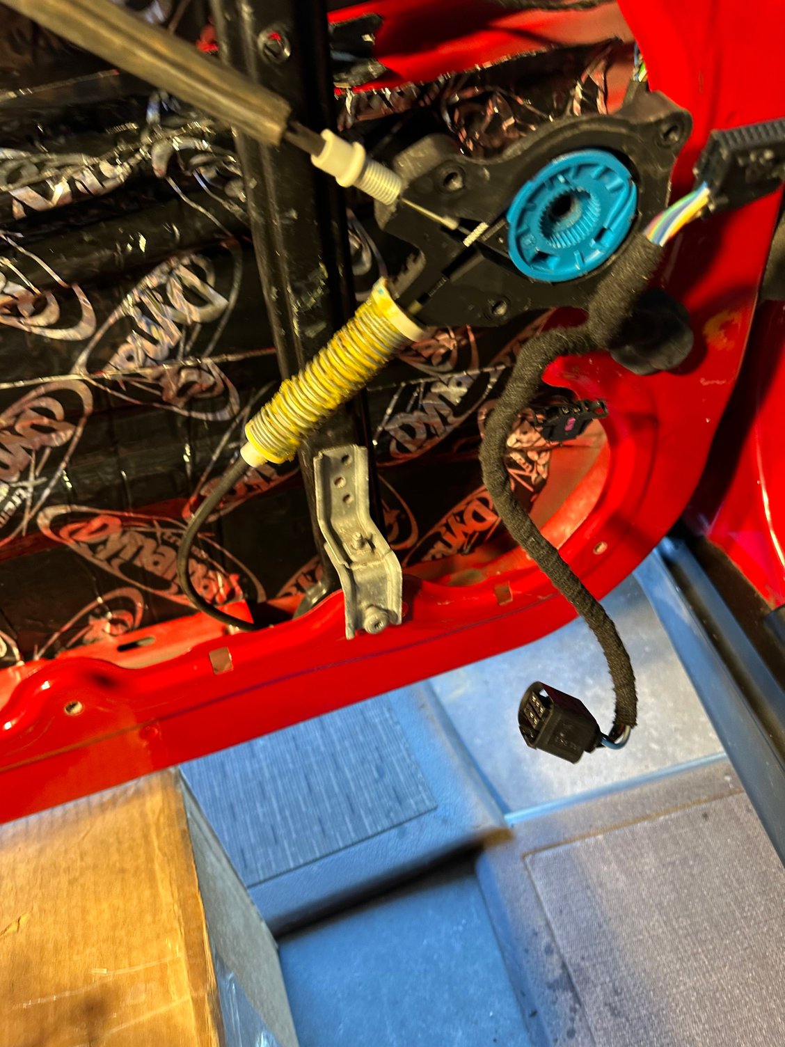

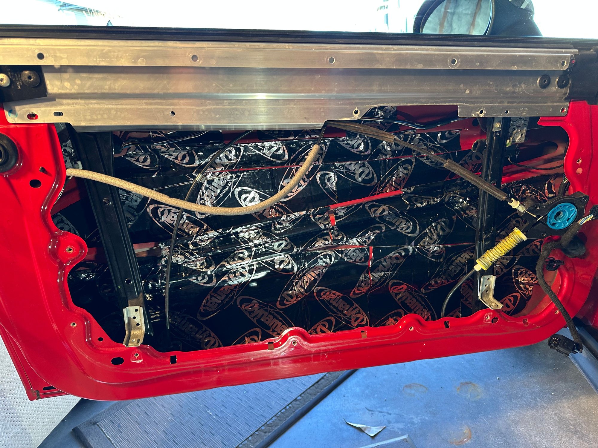

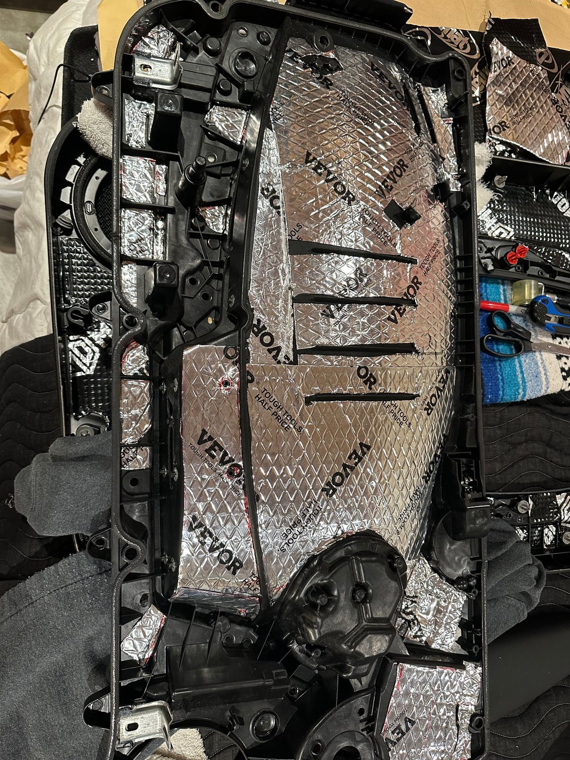

Completed the dynamat install on doors and hatch today (R58)
the entire car has been completed.
it’s a big job. While the doors were open, I also replaced the black rubbet gaskets between door handle and car door.
I took it for a spin. WOW noticeable difference
For thr doors I applied deadener to door skin and the the back side of door panels. (Same for hatch door)
All 3 doors are crazy heavy and sound amazingly solid when you close them.

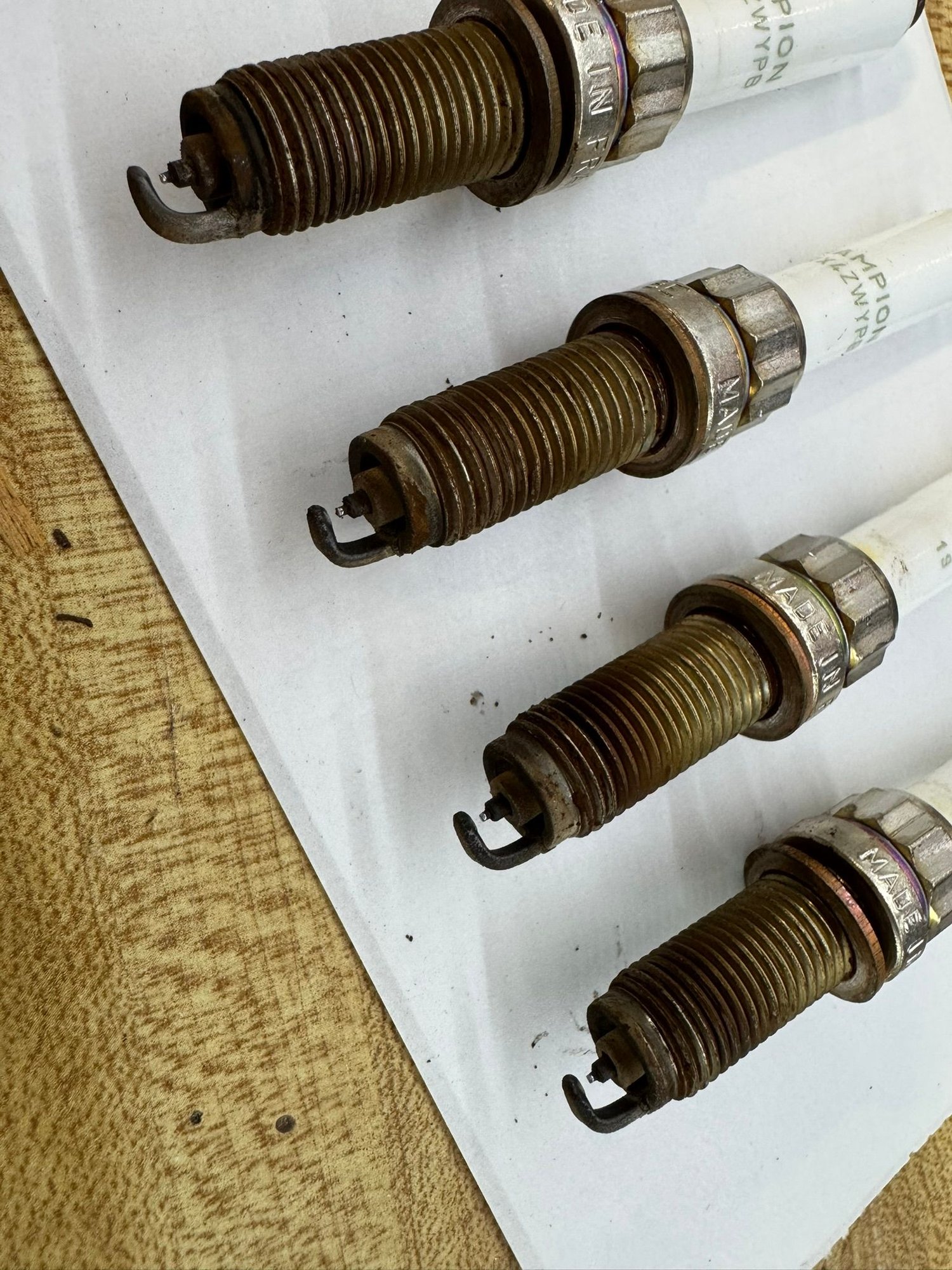

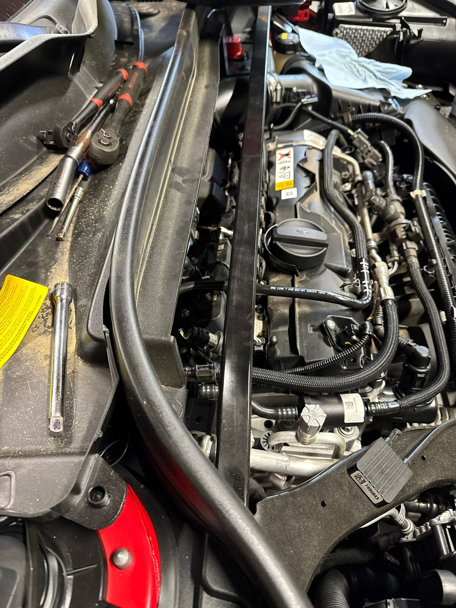

Performed first maintenance task on the new F60!!
Changed out the spark plugs yesterday. Old plugs were Champions, so I assume they were the originals. CarFax never listed a spark plug service, so my assumption is probably correct. Can't believe how difficult it is to access in the F60 engine bay. If I hadn't purchased the swivel plug socket, this never would have been completed yesterday.
With the new plugs, car seems to run a bunch more smooth.

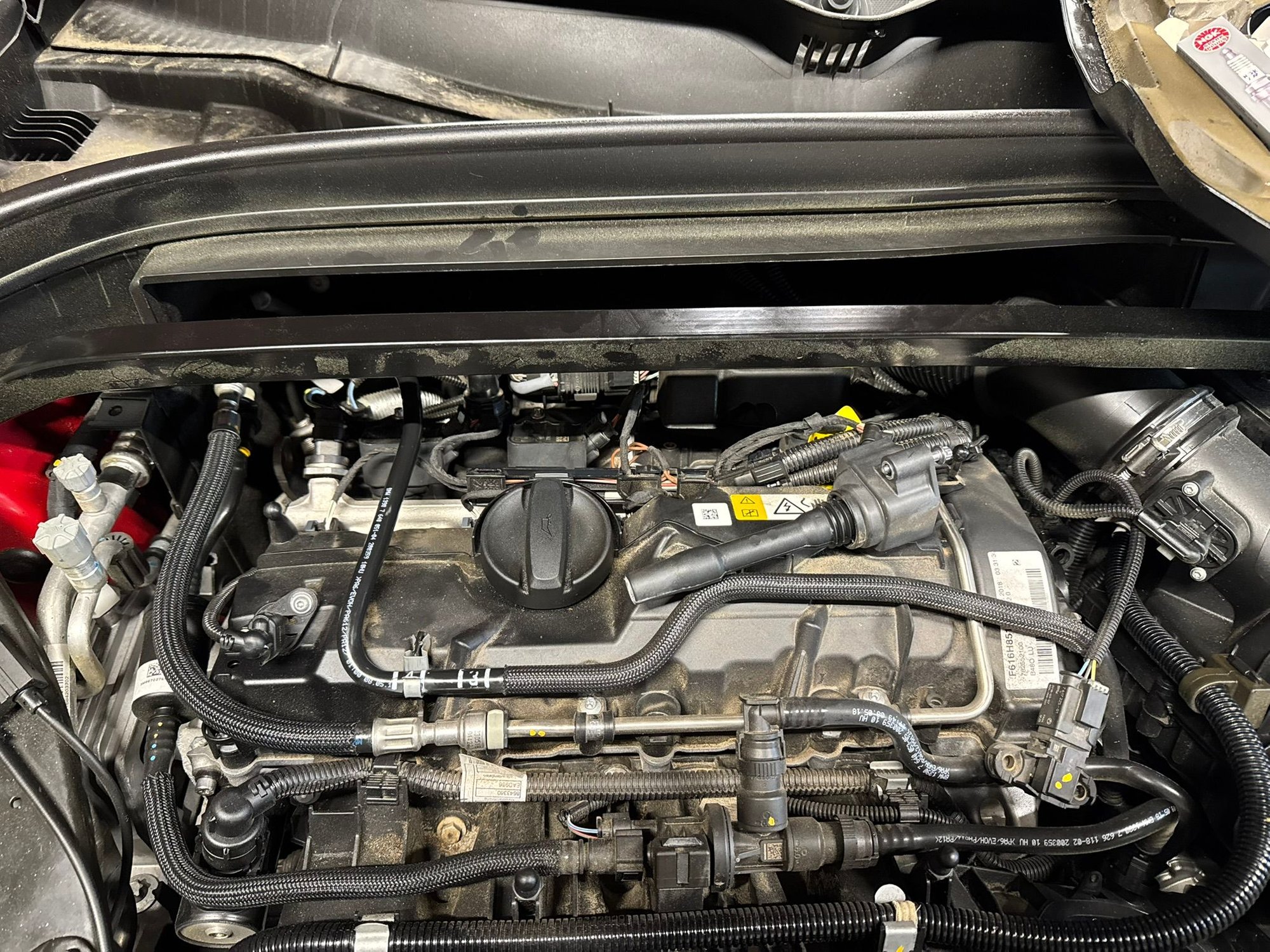

Service in progress...
Coils are under the cross bar, almost under the cowling.  Had to snake the plug socket and extension between the two.
Original plugs?  Likely.  A little grungy, but appear to be normal looking.

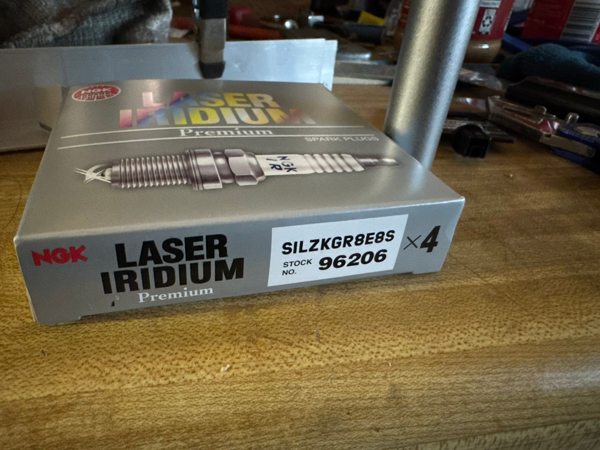

New plugs: NGK 96206.  OEM spec for the BMW B58 engines.  Should be good enough for my B48.

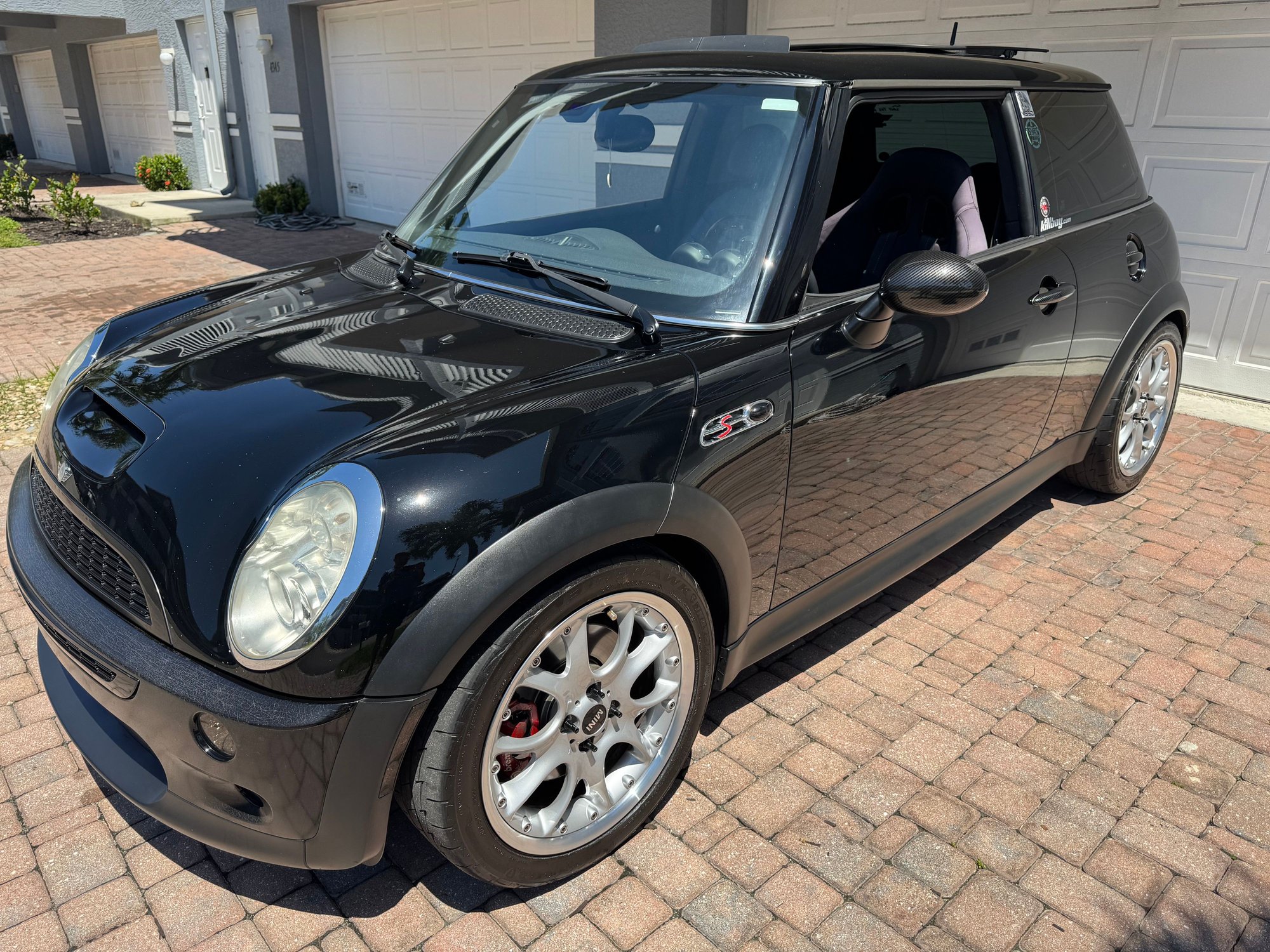

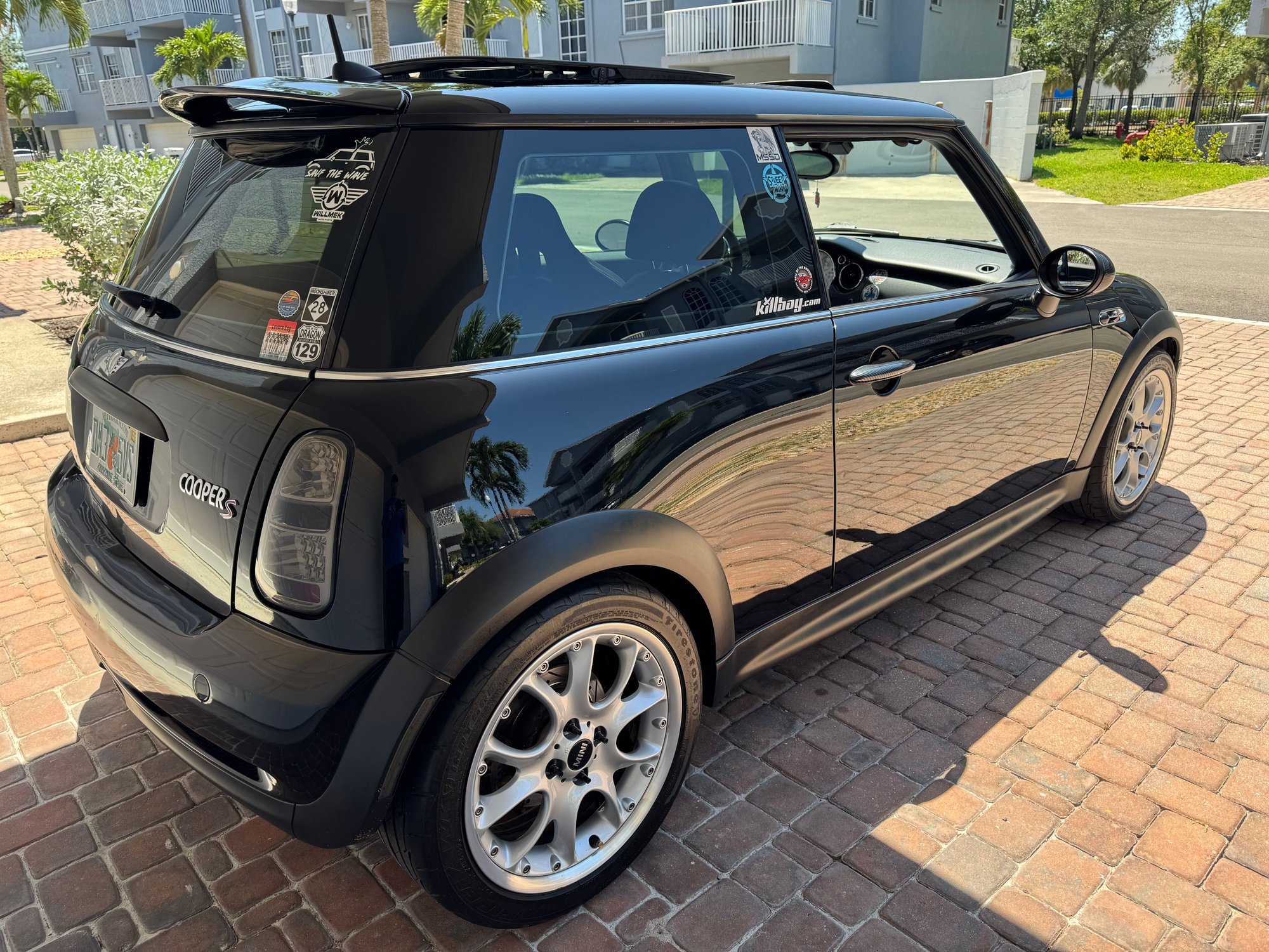

Little update, other than keeping her clean, getting her some Florida plates (which was a pricey adventure), I scored a milltek cat off FB. All this concrete and overpasses, the raspiness finally got to me. Now she’s back to whining like she should.
All cleaned up, wife’s luggage packed in, ready to take her to the airport.
No more snow bird status
$505 for that plate 😳🤯😱🤬
