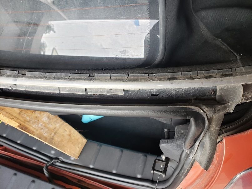

Replaced the molding at the back of the convertible top and likely raised the value of our R52S by 25%, too - just on the cost of the parts, alone!
Holy cow were these in bad shape! Likely the original parts.
My daughter gave me a hand.
The new ones looks SO much nicer!
And a view of the other side!

Very important piece of trim for the R52....they help to keep water out of the boot and a electronic module in the back dry....$$$$.

Which is the electronic module that is at risk? I wish I had known earlier...I would have scavenged it as a spare from the R52 that was in our local junkyard (it's now been scrapped, though).

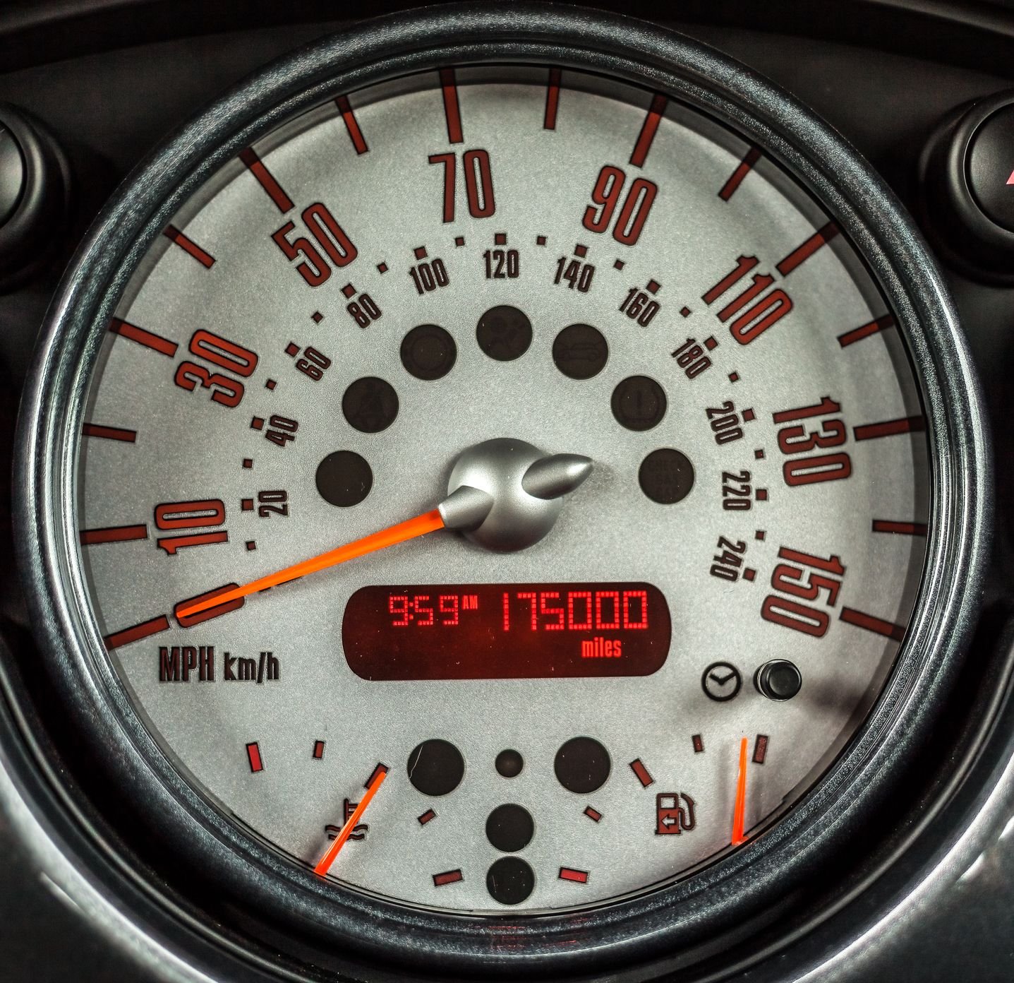

MINI Milestone-2005 R50

2005 R50 w/ 165,000 miles
Congrats! Need to update your .sig, now

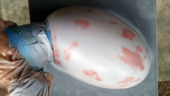

A Wing (mirror) and a "prayer"...
Painted my Sideview mirror housings today. They were looking pretty tired over the years.
Try as I might I had a heck of a time trying to release the inner plastic tabs in effort to remove the mirror housings.
The one thing I've learned about a 18y/o Mini is that the "plastic" tabs will break 9/10. So I left the caps in place and just masked.
Although, this shouldn't be mistaken as a "How To" guide...Maybe a "How NOT To"?.
For what it's worth - Here's what I did and the lessons I learned....
Initially I dry & wet hand sanded the oxidized, plastic mirror housing with 400 grit and scotchbrite (red).
I should first say that the factory mirror housings are NOT painted. The gloss finish you see on the factory housing(s) is the actual "plastic" itself.
It has always been my practice to use a good primer to "seal" a surface regardless of how perfect the (original) surface may "appear".
In this case, at attempt to short cut - I went against my better judgement and did not use primer....

After !@#%-ing up my first mirror housing, I decided not to give up and re-sanded the mess I had made.
This time I used a primer. Not having much of a choice ($$), I took a chance using an off the shelf brand of primer.
I've used Rustoleum aerosol paint products in the past but never their "sandable" primer.
Reluctantly at first; considering using anything with the word "Oleum" in the name or as an active component; makes me extremely dubious about it's quality as an automotive paint product..
I have to admit; I was totally surprised how quickly Rustoleum Filler & Sandable Primer flashed off and how nicely it dry sanded and easily dusted with 400 grit, after only 20mins time.
In my former career in design & fabrication; when it came to sandable primer; we had an adage - "If it doesn't dust, don't trust".
The red oxide glazing putty is Bondo brand (ugh!). I prefer 3M Acryl-Green or Evercoat but it is not always readily available OTC.
The results were a nice smooth dry dusted finish followed by a little wet sanding. Afterwards pre-paint cleaned with a tack cloth.
I switched from the brand of paint (Rustoleum) that initially bucked. I laid down a few nice coats of VHT/ gloss black in succession. Finished off with lacquer clear.
I purchased Rustoleum Filler & Sandable primer @ my local Advance Auto crap store for an obscene $18/can. Well worth it, in this case.
