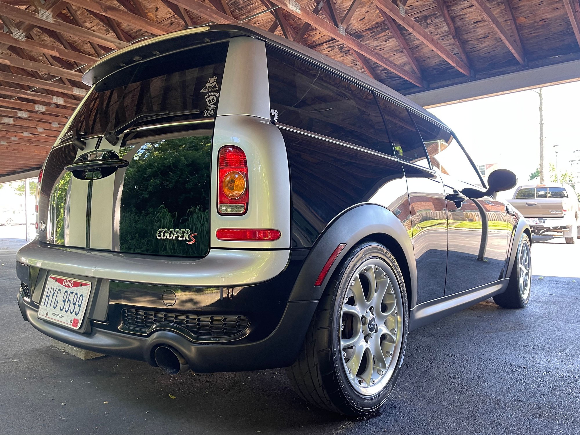

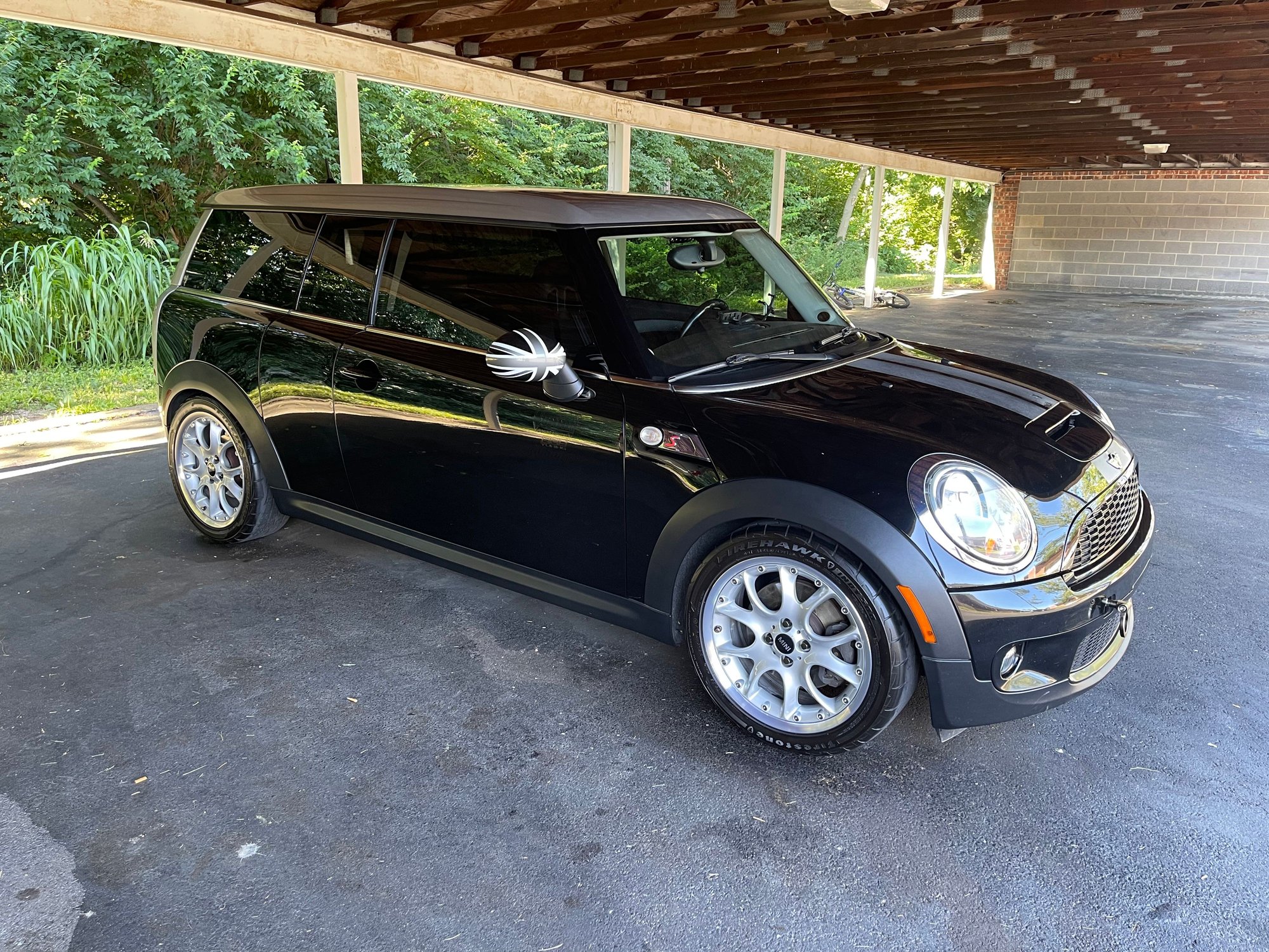

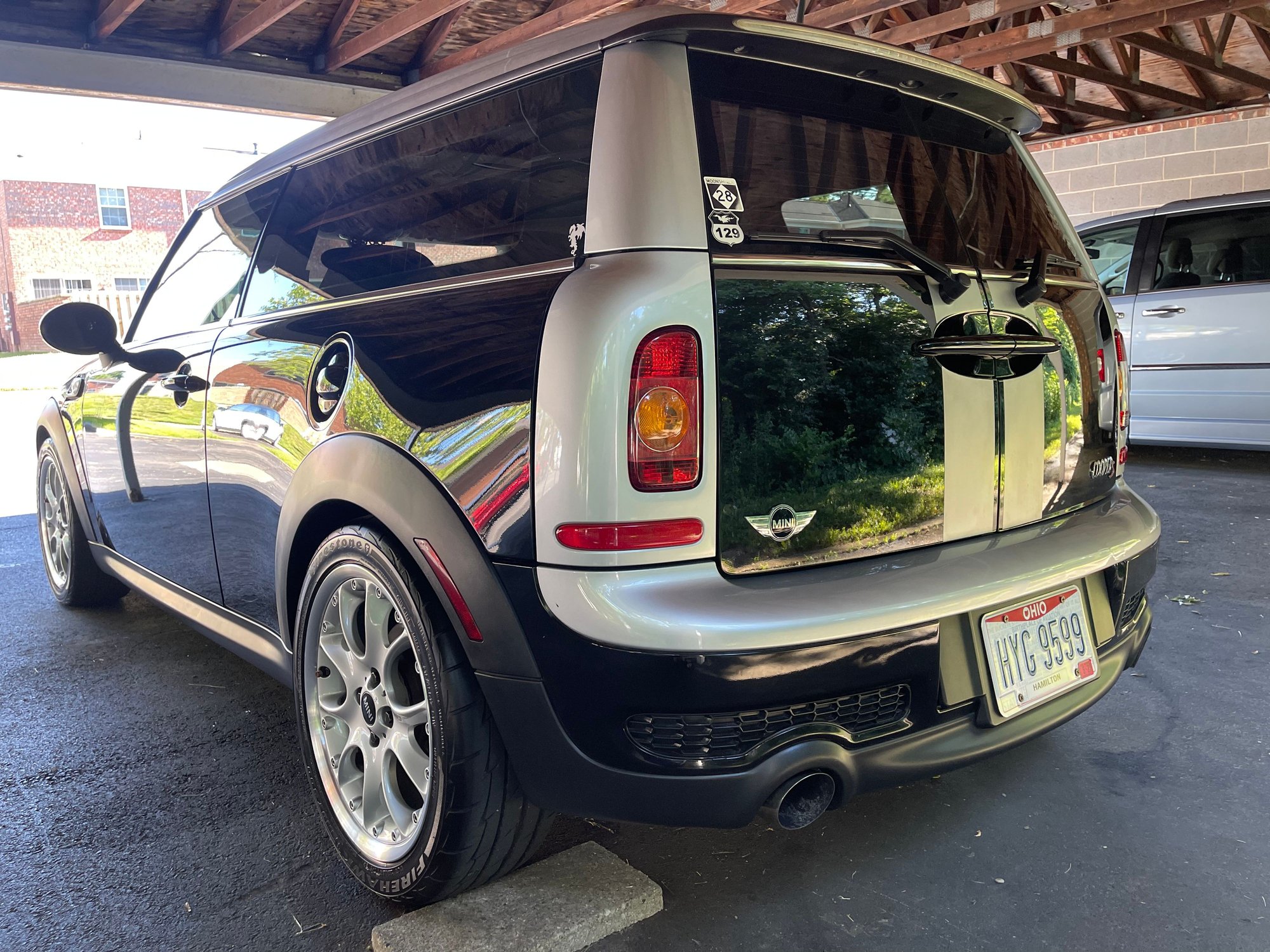

I washed, clayed, compound, polished, waxed and ceramic coated Ceelo for our trip to Vermont for MTTS on Friday. Not bad for a 5 year old, 4 season daily driven baby hauler. Still love it as much as I did when I got it, maybe a little more after the mods. Just need to finish cleaning the vinyl and wheels…ran out of time today.

I didn't realize the Clubman moved the gas filler over to the right side 5 years ago! Nice shine, btw👍
