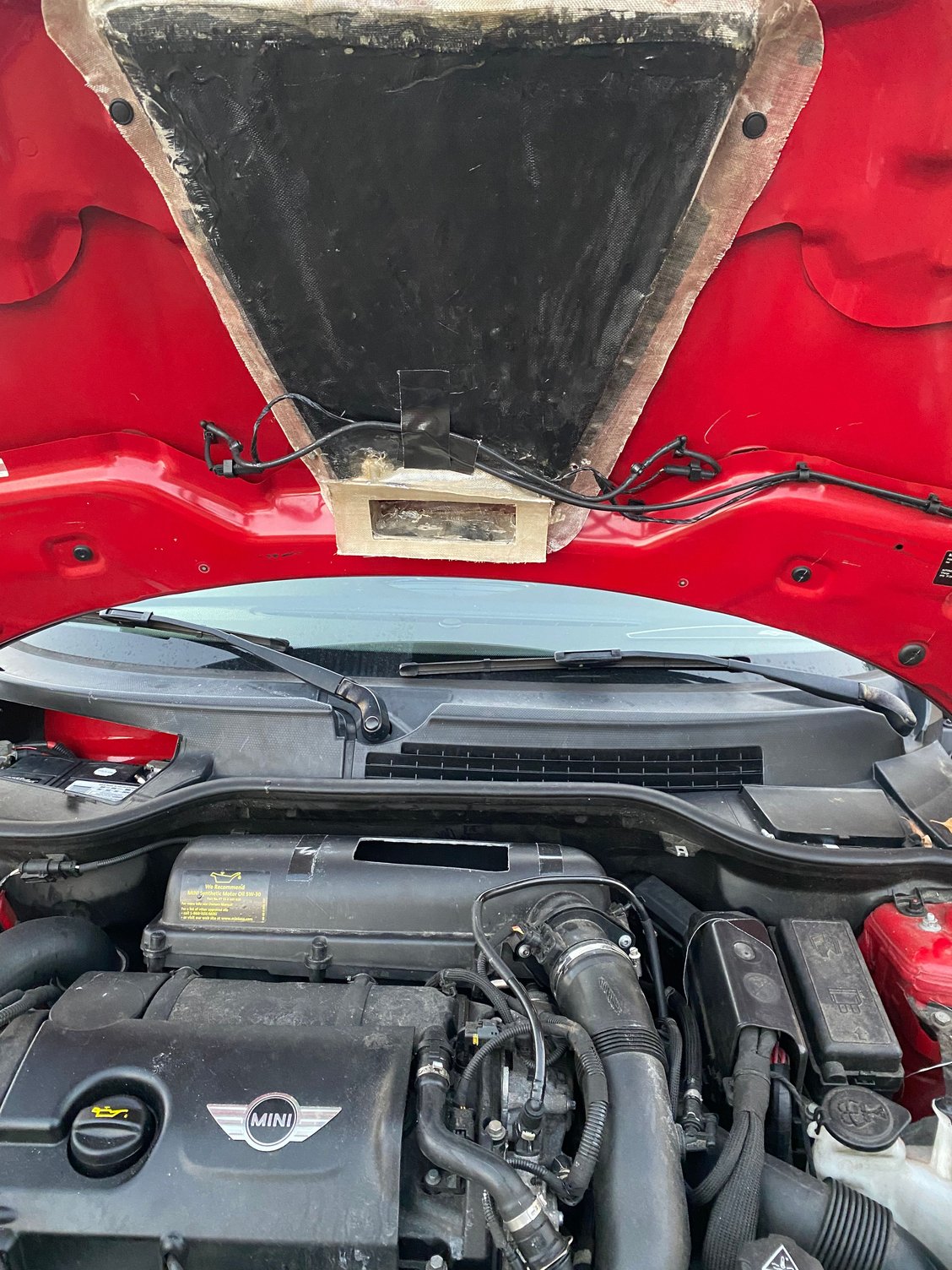

Cold intake
I made a fiberglass cold air intake I have to put a pod filter and some heat tape

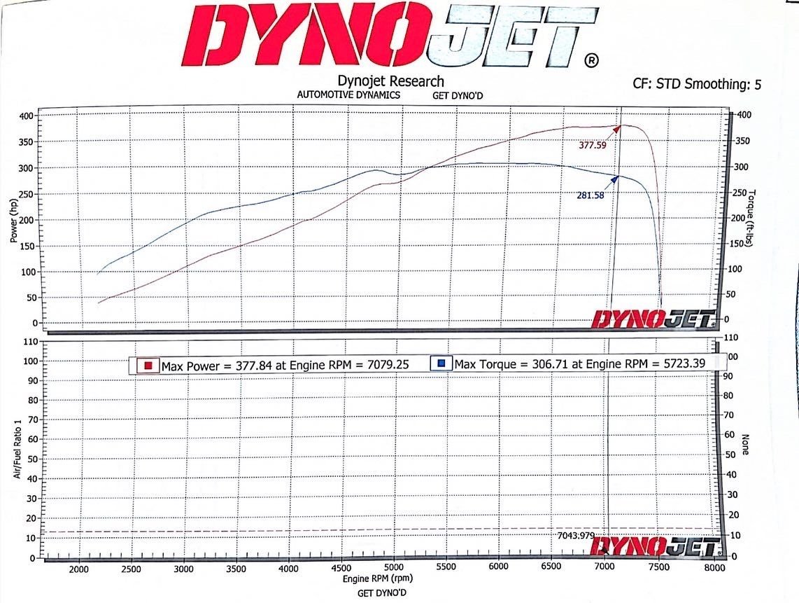

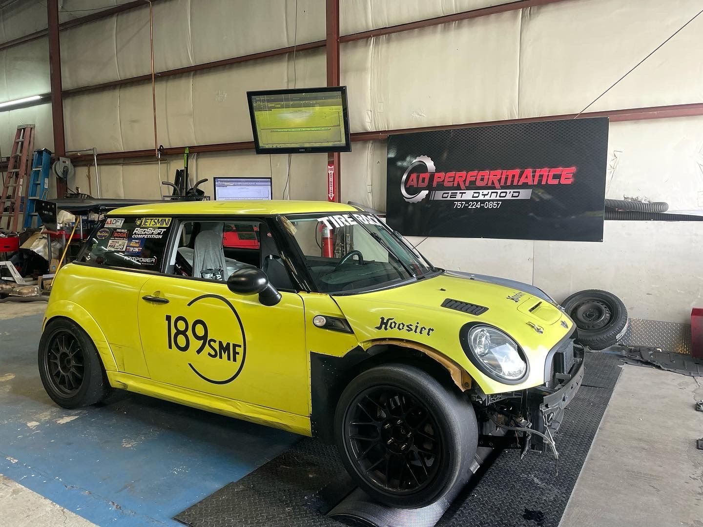

Added bigger port injectors so we could up the boost. Now 377WHP at 25psi boost

A long and flat torque curve and usable power right up to 7000+ rpm. I would guess a well thought out design and tune. Nicely done.
