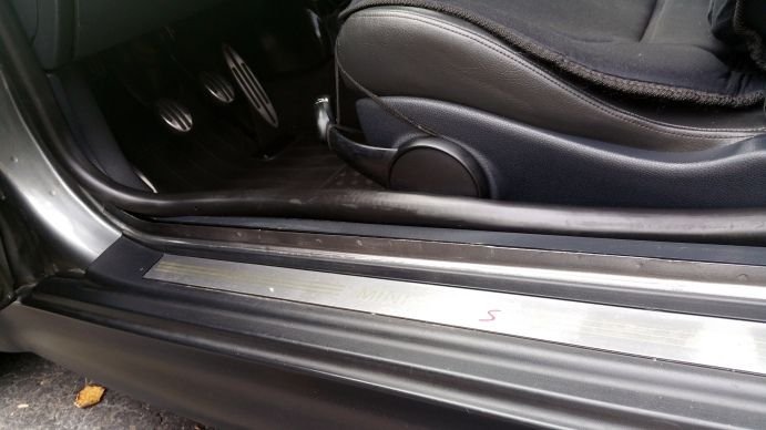

Rust Never Sleeps
Disclaimer: The flowing is not a paid advertisement. I am not a professional body shop technician. I only play one on TV....
Back in 2010 after washing and detailing my Mini, I pulled up the rubber door sill seal to dry up some residual water. To my surprise I found a 1.5" area of rust under each of the lower door seals.
Being accustom to bodywork; I took the proactive approach and went to work on rust mitigation and repair.
I used an angle grinder to gently remove the abscess rust, treated with Ospho, Apoxie'd/filled and re-formed the offending area(s), primed and painted. My work was done! So I thought. Until today - 12 years later.....
I actually started this process last week and finally finished up today...You'll see why if you read to the end.
With the exception to my previous repair.- Rust had spread everywhere along the sills! The driver side was worse than the passenger's.
Unfortunately; I had used up my last few oz of Ospho on my Mini wheel refurbishing, so I ended up finding a "similar" rust neutralizing product 'Evapo-Rust' from my local Advance Auto crap store.
I gathered up a few items: Small spray bottle, 40grit sanding disc, wire brush, a couple of small brushes and a 2" high powered magnet.
After 40grit grinding on the affected areas, I treated the steel and I ran the circular magnet in the inner canal between the sill and the plastic interior to pick up any vestige metal (rust).
The magnet did a fine job picking up all fragments in lieu of a vacuum.
I applied more coats of Evapo-Rust by spray and by brush.
*on a side note: I find Evapo to be less viscid than Ospho. Had I had some cabosil on hand, I would have mixed in a little with the Evapo to give it more body/clinging character. I have used Navel jelly in other situations with little to no results.
So I decided to improvise by emulsifying the Evapo with baking soda. It couldn't hurt.
I replaced the rubber seal to keep the product from evaporating and let it sit overnight.
After allowing Evapo do it's thing- the rust barely turned black. Even after several applications and over a period of 96 ridiculously long hours. Fed up - I reground the sills to bare metal and applied an additional coat. AND again, let it sit overnight.
The next day (yesterday), I prepped the surface and began the cosmetic/structural repairs on the sills.
I reformed affected sills with Apoxie sculpting medium. Although, I would have preferred to use aluminum fortified epoxy (JB weld would work too). Apoxie Sculpt is impervious and cures rock hard.
It is by far my favorite and most versatile product in my fabrication arsenal.
Cured, sanded, primed and painted.
As much as a perfectionist as I like to be - at this point OEM color matching wasn't as important as dealing with the problem at hand.
I will sum up by saying that Evapo-Rust sucks and doesn't even come close to the rust inhibiting/destroying performance of Ospho. Accept no substitute - Use Ospho.
I even took the time to freshen up the paint on my hood scooptoday...

I do use EvapoRust to treat small parts that can soak in it. Yeah, I have to leave it sit there for days, but it does clean up these parts well.
But, for your situation on the door sill, I can see how it wouldn't perform as needed.

Yes - you are right. To be fair - I definitely figured out and could see how Evapo was more conducive for soaking parts.
I haven't yet used it in that manner, yet I imagine it would be a fine product for that application.
However - I will say; Ospho works in minutes. Not days

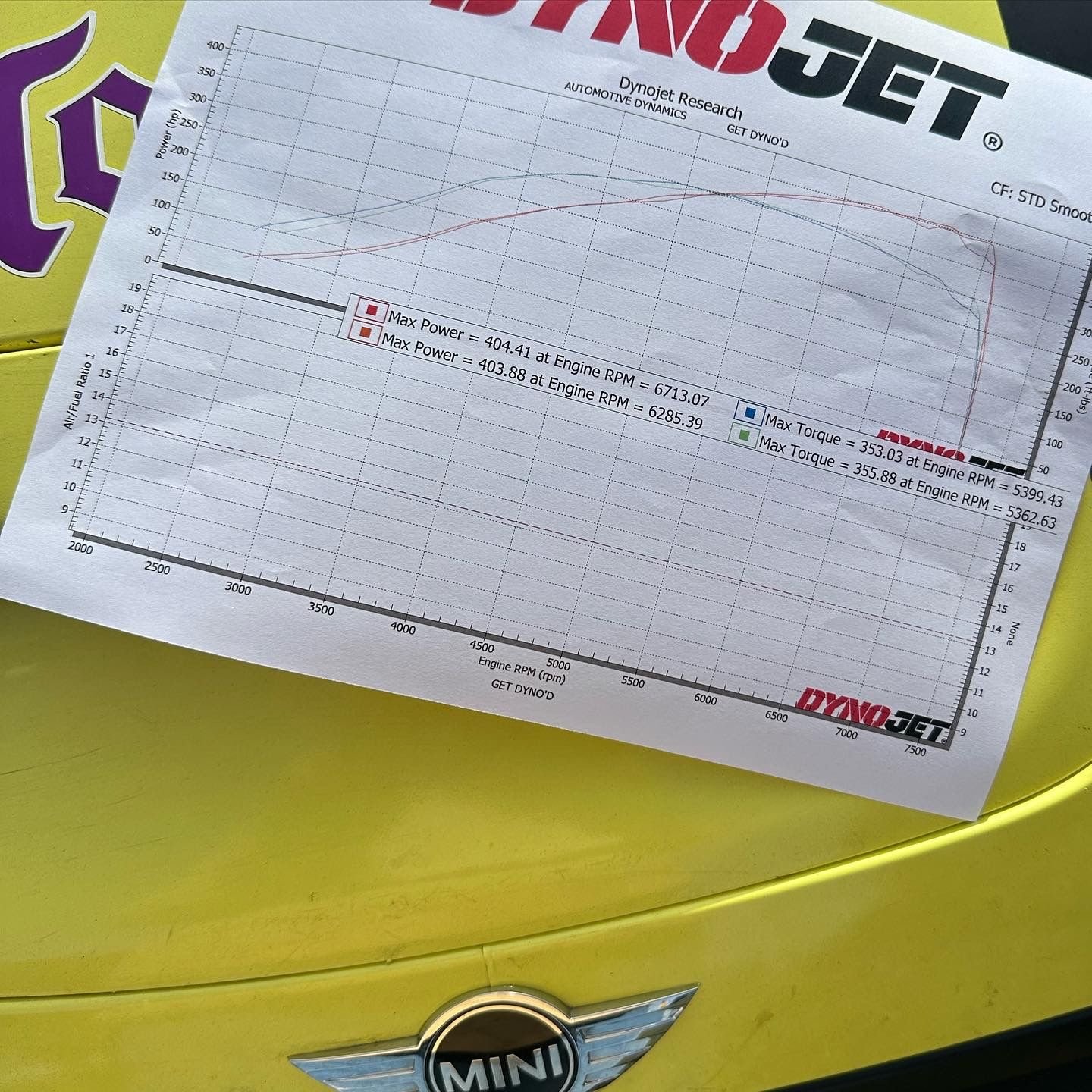

404whp
Possibly the highest horsepower through the OEM untouched head ports?
404whp
