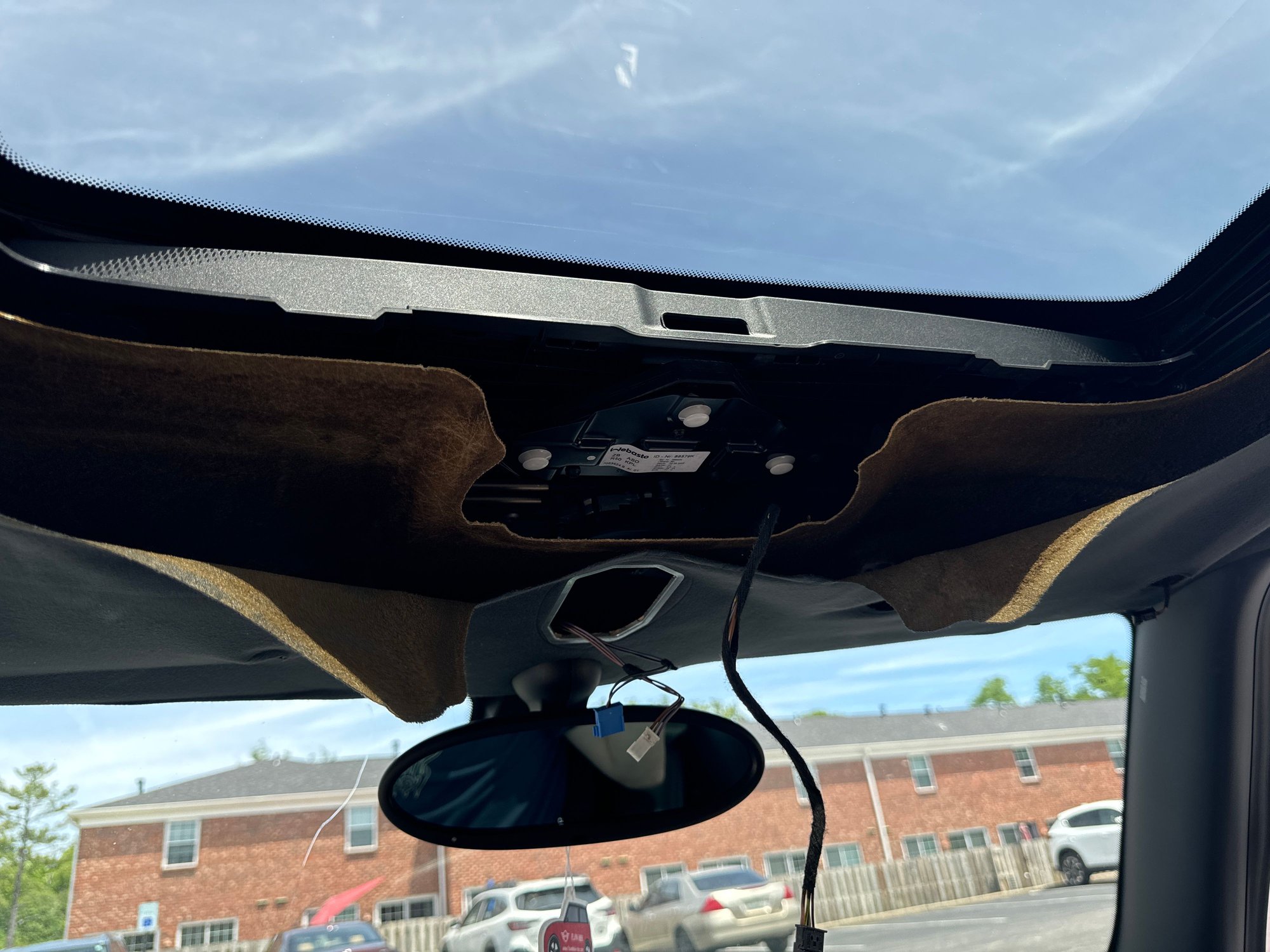

For a while I had noticed the front leading corners of my sunroof seal looked as if they had dipped.
I never had any water ingress. When I re-covered my headliner a few years ago, I made a conscience decision to cable tie the drain tubes to avoid any problems in the future nonetheless.
Today, I decided to retract the sunroof to have a closer look.
Although I neglected to snap a photo - indeed the front left and right corners of the sunroof seal had sagged a bit.
In addition to the sagging seal; was compounded by a profuse amount of "natures droppings" which had collected between the sunroof seals and channel.
I began by chasing the dirt from the channel in the seal with a small stiff bristle artist brush and a tooth brush.
Initially, I only saw some moderate debris. But then noticed the drooping seal (circled: top right).
However noticeably, more-so, the complete blockage of my drain tube(s) (circled: center).
^^^ Dammed up drain tube ^^^ - It clearly seemed obvious that here was more accumulated debris lodged in there than meets the eye.
I pulled back the entire seal. There was so much decomposed crap in there (pic doesn't show), so I fired up my vac and air compressor.
After a couple of hours of scrubbing, vacuuming, hosing, air pressure, pulling the headliner down enough to see that the drain tubes weren't leaking -
I ran the seal back in place nice and snug with the aid of a plastic panel tool.
Super clean...
...and back as new.

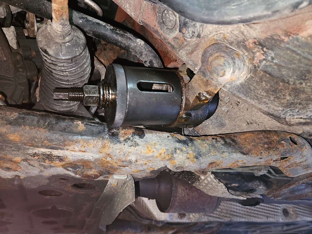

Today I changed out/installed a new, upper right side engine, vibration mount.
I hadn't noticed (until today), a small split in the old one when I replaced the main engine mount last week.
A few days after replacing the main engine mount, the SES light came on while I was driving. I pulled over and did a quick scan with my Foxwell and got a 0171 fault - "DME Mixture control (bank 1) - System too lean".
'Could be a number of things. But I figured it was most likely a vacuum leak. I saw no evidence and the car ran fine. The code never came back.
While changing out the upper vibration mount today; I discovered the vacuum leak. A small crack in a plastic Dorman connector that I had used to connect the out - vent side hose from my catch can.

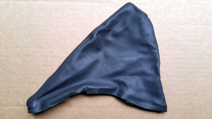

I had planned to do more extensive work on the Mini today - like, replacing the shift weight bushings top side of the transmission.
But the forecast had other plans.
Instead, I decided to do something simple and a adjust/tighten any slack from my E brake handle.
But again, my Mini had other plans for me....
Preparing to remove the E brake boot to gain access to the cable adjustment nut; I discovered this fairy significant tear/hole...
Upon further investigation: It appeared to be worse than I'd thought....
Someone please explain to me how a rust free car could possibly have a rusty E brake handle? - In the interior no less?!!
No worries. A little Ospho should do the trick..
No need to go overboard. Ospho works fairly quickly at neutralizing/converting rust. In just under an hour I could resume with the task at hand...
After making a slight adjustment to the E brake cable; It was time for the new brake handle boot.
Done.

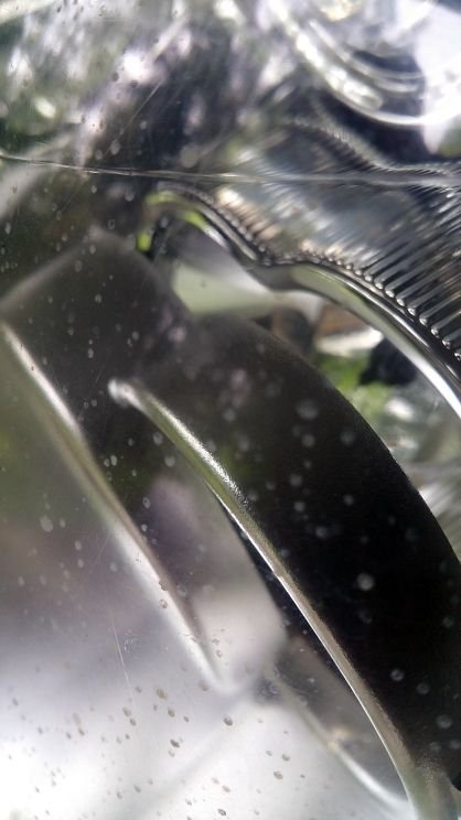

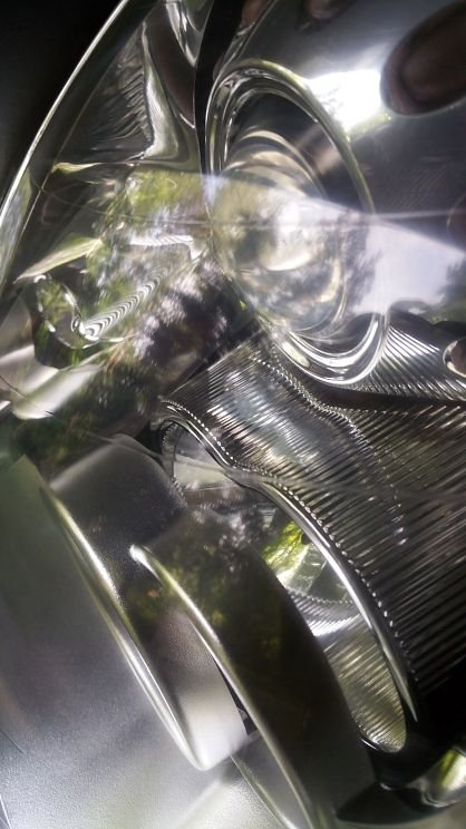

Believe me when I say; I really didn't want to do another headlight restoration post - but seriously?
This is more or less a rant rather than "what did I do to my Mini today"
About 3months ago (while still living in the city) I had a guy pullout in front of me in a pickup truck that was leaking paint out of the bed.
I didn't realize it was oil base paint until the next morning only to find it peppered across the hood of my Mini. Upset but not a problem, 'I thought'; as the oil base paint easily wiped off the polymer treated hood and windshield.
However, the solvent in the paint had misted and etched its way into the plastic headlight lenses. I could not remove the spots of paint without completely refinishing the lenses starting from scratch = 800,1200,2000 grit and final polish.
The other day, ironically, nearly the same thing happened again!
While driving behind a truck (pacing a 40' distance), I soon found myself driving into a vortex of atomized swirling mist.
No big deal. I assumed it was just dust or drizzle.
Started washing the Mini this morning. By the time I got to wiping down the headlights...
I was hoping the little white speckles were just hard water spots
Nope - After some ambitious rubbing and buffing to no avail...I then remembered driving through that mist behind that truck -
Really? - paint? again???
Today,
I spent the time on my Mini completely refinishing both headlights in order to to remove the etched in solvent/paint from the headlight lenses..
Here's how the left driver side turned out. The passenger side turned out just as well - if not better.
