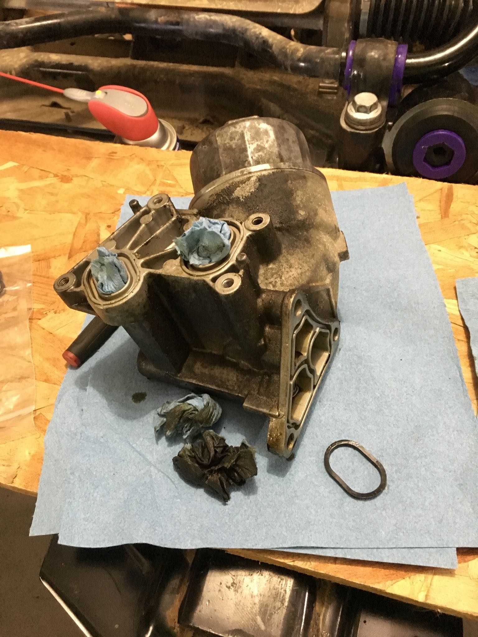

Made some steady progress this afternoon on Egan by replacing the oil filter housing gasket, which originally I wasn't going to, but considering I had to replace the oil cooler gaskets, and I just so happened to have a spare filter housing gasket lying around (seriously, I do not remember when or where I got it ), I figured it was a good time to do it.
...and I'm glad I did because that gasket was certainly leaking as evidenced from the bolts that I removed that were covered in oil, and it definitely hardened over time as if felt more like a bendable plastic than a rubber seal. No wonder it was leaking.
I also removed the two bolts holding the starter motor in place to get ready to remove the transmission, and those two blasted bolts on the top f the transmission where all the wires and hoses are. Didn't have to remove the entire intake, which was nice, but damn was it tight. All that should be left is the remaining bell housing bolts, plus the clutch slave cylinder, and on Friday after work, I should be ready to remove the transmission, and see what the innards look like after 162k miles. Seriously, the clutch has never been touched since the car was built, so I'm extremely excited to see how well it has held up.
