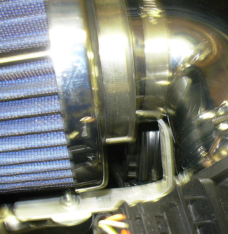

That isn't metal. Could not find a silcone 90 deg elbow anywhere so. . .they had these parts in the performance intake section. The elbow is some hard plastic material which has its own clamp. It fit perfectly over the MAF and the green O ring. It has a nice snug fit and I can say that its working fine. I was worried in the beginning about heat but these things are made for making custom intakes and it does not get hot or leak. It was like $10 and the filter was about $40, filter oil and cleaning kit $10 plus tax about $70 total. The bracket I bought a long peice of aluminum from Home Depot, cut it with a hack saw and bent it and twisted it with two wrenches. Drilled a hole with a titanium drill bit slowly and attached it with a machine bolt and locking nut.
For the scoop I used some expanded metal screening material from home depot about $10 for a 2x3 sheet and cut it with tin snips.
where does the bracket mount on the car side? the stock airbox is only held on by 1 screw which is far from where the maf sensor is...
i want to remove the loser half of the oem airbox but im stuck thinking of ways to mount the bracket with the airbox removed.

tedbone... correct me if im wrong...
i believe its mounted on the intake manifold... the alta unit mounts their air box on it as well, you can always look at alta's cai instructions. Alta did a cool thing though, they put rubber around the screw between the intake manifold and the air box to give it some cushion.

I just used one of the holes for the posts on the bottom of the box. I used an allen bolt, two washers and a nut. The only threaded hole is on the other side of the manifold and not very usable.

when i made my bracket for my cai in used the 2 holes on the intake closest to the maf. i used a .125 x 1.25 x 6 pcs of Al that i drilled 2 5/6-18 holes in. i used the rubber gromts that the stock box used with 2 fender washer on the other side. that way when you tighten it up it would squwish the rubber and hold the hole thing tight. from there i made a braket that i welded to the one on the intake to hold the flitter. i will get some picks as soon as i can
