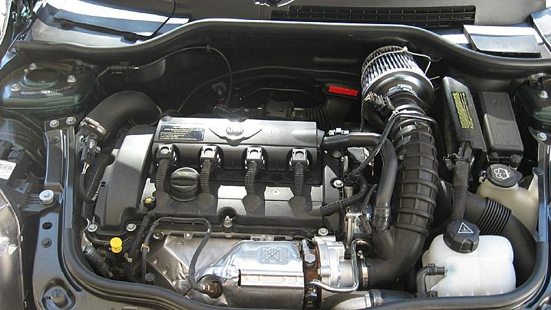

I have taken the plunge and made up my own version. I tried a few versions from the very simple set up that started this marathon thread to a more elaborate set up that I have now. Consists of a large dual cone K&N pod filter, some polished 3" alloy pipe, a 3" blue silicon elbow pipe, 2 metal mounts and some heat shielding for it to sit on. I will post pics as soon as I can.
The result has been good, feels like more power, especially at rolling accelerations. The sound is awesome, no mistaking it is a turbo now!
I also opened up the dummy scoop so cold air is more available. Just to be sure, I have made my own intercooler spray if I feel it lag in stop start traffic.
Overall, very pleased, did all this for less that an after market CAI would have cost and I swear this is the way my JCW kit should have come.

Here are the pics, more development in store when I get time. i am planning a polished airbox with stock intake as well as an intake at the top to utilise the hood scoop (not sure if it will be ducted). I will post more pix as it develops.

looks great! is the filter bolted down somehow to prevent it from rattling around?

It has two metal filter mounts clamped under the hose clamps, one near the filter and one at the joint of the stock pipe and the silicon pipe. Both these mounts bolt to the engine so movement of the engine is not a problem.
Holds pretty well with only minor flex in the mounts, no viabrating or rubbing on other components.

It seems you may be blocking the airflow by having the metal sheet as ALTA mentioned that with the hood sccop open and the OEM airbox removed you get a much higher airflow over the engine and down the back between engine and firewall

As I briefly said in my previous post, the performance does feel better. Not much change on initial take off, maybe a little more torque but it is in rolling acceleration that there is a definite improvement. Stomp on it coming out of a corner and you have to be ready for some torque steer and traction control cuts in if you happen to be in the meat of the torque curve.
I have noticed that with general driving the inlet pipe near the the throttle body does not get as hot so it is obviously running a bit cooler which is a big problem for us in Australia when the car is fitted with such a small FMIC.
As mine is a JCW the difference is not huge, but it is an improvement that can be felt. Besides that it sounds like a high performance turbo now which is what I really wanted.
As for the heat shield, it does leave a considerable gap to the firewall which can not be seen in the pics. There will still be good airflow over the back of the motor. Like I said earlier, still a work in progress and as I develop it more I will remember to retain that air flow over the inlet side of the motor.
Thanks everyone for the comments, it makes it a bit more fun to come up with your own design when people give ideas and opinions on your work.
