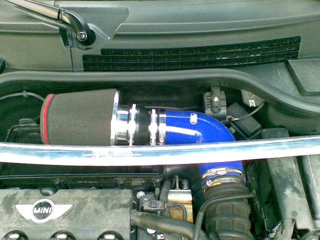

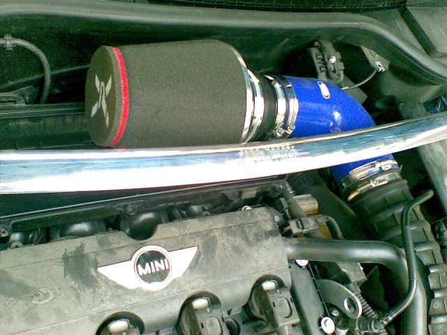

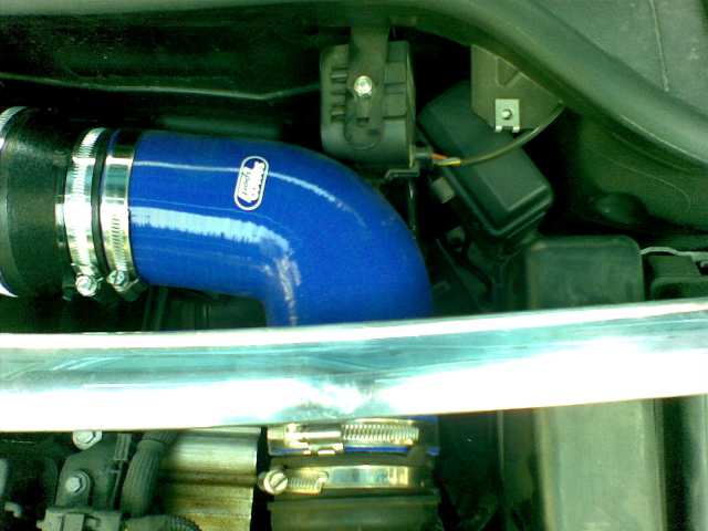

my home made CAI...

Originally Posted by papadimitriou
my home made CAI...
What filter are you using?

Joined: Sep 2007
Posts: 107
Pipercross...

Posts: 214
where'd you get that mount from? I've been looking everywhere for something to hold down the fiter.

Posts: 107
The package of the filter contains the filter and the black part that connects it with the silicone hose.
In order to connect them I used a 70mm metal ring from a guy that makes exhausts and there it is....
Cost in Greece....210$
Cost of Alta or similar...430$

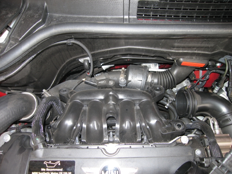

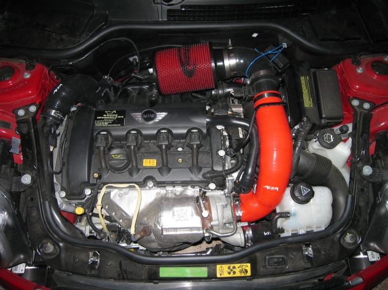

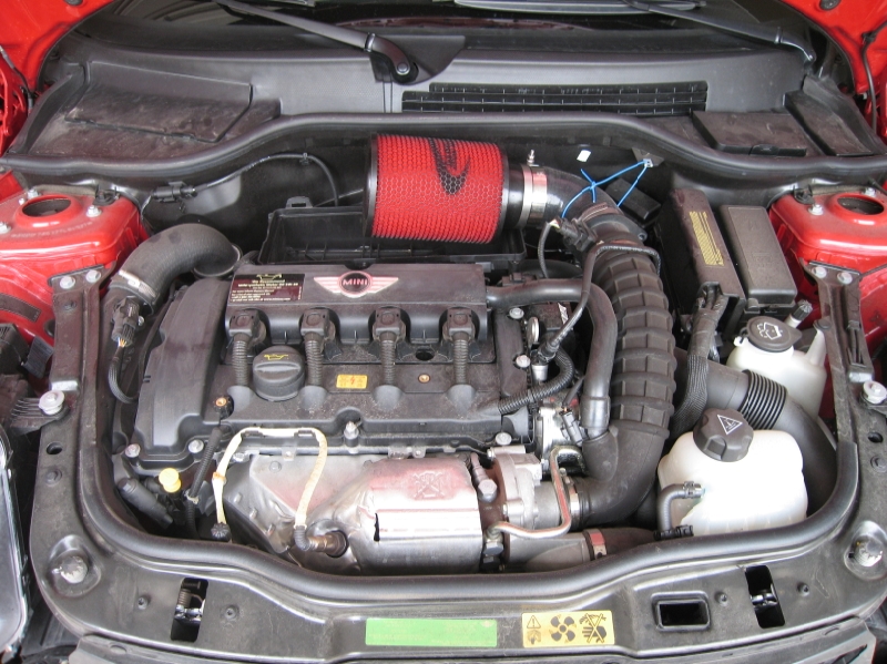

In the meantime I just tooks some pics of mine which I installed last week and added boost tubes this weekend.
First pic is with the lower part of OEM box still in place.
Second pic shows it after removing the box and all the "noise maker" pipes behind it.
Third pic shows the "noise maker" pipes I was refering to which when removed allows better airflow through the engine compartment.
