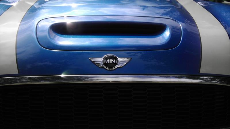

Old Sep 19, 2011 | 08:36 AM
  #718
uhhmoney's Avatar
uhhmoney
Posts: 30
From: Hampton, Virginia
Here is my setup, freshly installed this morning. Sounds and looks great, my butt-dyno wants to tell me that I've got a little more pep but I'm guessing it's just my perception coupled with the WAY more aggressive sound. I found myself revving at stoplights just to hear the "pssSSSHHH!"
Tips for those interested:
- I got my AEM Dryflow 3" filter at Advance Auto for just under $60. Seems to be a regularly stocked item so shouldn't be hard to find. Carquest and Autozone only stocked pre-oiled filters.
- It is way easier to remove the MAF from the airbox if you take the entire box off first. Undo the hose clamp behind the MAF, then take off the top of the airbox (with the MAF connected to it) and remove the filter. Then, look on the front left corner (from your perspective looking into the engine bay) for a torx screw to remove. Then, pull the airbox bottom section up and you'll feel it "pop" loose from the little pegs that hold it in. To remove the intake tubing connected to the bottom of it, you twist it counterclockwise then you can just pull it out.
- To remove the grille, you MUST remove the hood scoop. This is a little more complicated if you have the tin heat shield that dealers often install to prevent hood scoop warping. Just remove that heat shield, then look at the underside of the hood and find the little plastic phillips head screw and remove that. Then, gently push up on the corners of the scoop from the bottom and then remove the entire scoop from the TOP. I know it looks like it should slide off, but it just pops up, held by 5 or so peg fasteners. There are 4 small phillips head screws to remove and then the grille just comes right off.
- Make sure to remove and save the rubber o-ring gasket that will probably still be on the MAF when you remove it from the breather box
- When you mount the filter to the MAF, you will want to push it all the way up over the 2nd lip, but don't. It will feel loose at first, but once you tighten that hose clamp down, everything will be nice and tight.
Overall, it took me 30 mins to figure everything out and will only take 15 minutes or so once you're comfortable with how everything goes in and out. Remember, NO PRE-OILED FILTERS! I know finding dry filters is a task, but don't mess up your precious because you got impatient.
Attached Thumbnails CAI for R56 (home made)-imag0251.jpg   CAI for R56 (home made)-imag0252.jpg   CAI for R56 (home made)-imag0253.jpg
Old Sep 20, 2011 | 04:55 PM
  #719
fast2ghl's Avatar
fast2ghl
Joined: Jan 2008
Posts: 63
From: London, Ontario, Canada
Nice!
Honestly thou its just you perception of the sound making you think you have more power, if anything you just lost a bit of torque and power. The stock box is slightly better in this respect due to the outside air it draws in through the tube connected to the driver side front grill. All your doing now is sucking in hot engine air, effectively making a HAI (Hot Air Intake)
I've done the mod too, it sounds sweet, don't get me wrong, but you def aren't making any more power!
