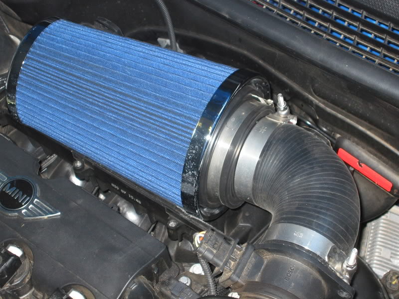

Originally Posted by th3118
You may remember I did this mod a few months back:
So I bought a elbow and clamps and a joiner at www.siliconeintakes.com
1 xStainless Steel Joiner, 3.0"$7.991 xSilicone Reducer, 90° bend - 3.0" to 2.75" - Black$19.991 xT-Bolt Clamp for 3.0" Silicone Parts$2.601 xT-Bolt Clamp for 2.75" Silicone Parts $2.60
and I brought a new 9" filter at Pep Boys for $40.
Seems to fit better with no rubbing.
Does the Joiner go between the filter and the 3" end of the reducer? I am not seeing where you are using the joiner.
Thanks! Great Job!

Your correct, the joiner does go inbetween the filter and 3'' end.

So the filter(s) will have a silicone end to go over one end of the Joiner? I am only seeing one clamp at that connection.

There is a clamp on the filter(it's really big, it comes with the filter. It's the silver thing right after the chrome part) and a clamp on the silicon.

Here's better picture of the clamps:

Cool! Nice setup. Are you going to try and isolate the airflow to the filter to make it a truer "Cold Air Intake"? Maybe a duct system from the hood scoop to the base of the old box?

th3118 --- I can't find that filter anywhere. I think it is an AFE "universal bolt-on" filter, but can't find it specifically anywhere. When I search most sites, they require a make and model which doesn't work for a do-it-yourself CAI. I can find the AEM filter:
http://www.aempower.com/ViewProduct.aspx?ProductID=320
but don't want to pay that much.
Love the grille insert. I plan to dremel out the rest of the closed holes in my stock insert and them paint it red to match my pinstripes and mirror caps.

Got mine brand new in box on e-bay! 3"x9" long, it's dry flow so no possibility of messing up your MAF meter!

There are tons of dry filters available with a shorter length than the 9" long cone filter th3118 is using (and at much less cost). Would there be a significant decrease in breathability with a shorter cone filter? If not, then I am ready to order the parts.

The filter I got from PepBoys is the same as this one:
http://store.summitracing.com/partde...5&autoview=sku
Summit only show it in red, you could call and I'm sure that could get blue, if that what you want.

Thanks! I would still like some input on my question. Any studies on flow rates of various sized filters to see if there is a negligible improvement going from, say, 5" to 9"?

I read a good study by a guy who tested various filters and measured their pressure drop with a manometer. K&N was the least restrictive, but the others were not far behind (paper, foam). More importantly, the design of the inlet piping system had a much more profound effect on the over-all pressure drop and you may find that locating the filter closer to the turbo inlet will have a significant benefit. If you are only interested in the filter, the pressure drop is directly proportional to the area, so a 9" filter will flow nearly twice the air of a 5" at the same pressure drop. The equation is Q = A (dP), where Q is the flow in cfm, A is filter area in square inches and dP is the driving force or differential pressure across the filter.
