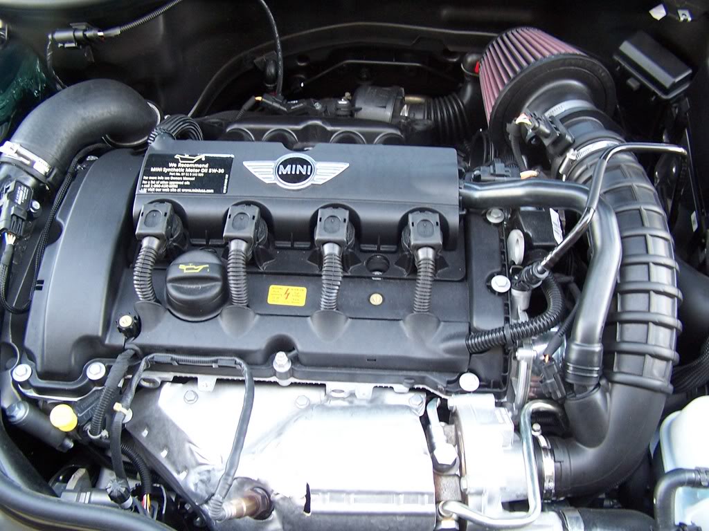

i would like to show you and mine custom intake(still working on it)
i have made a custom air box and made a hole on the bottom where i connected the pipe that provides air from the front..
Here is a picture:
I would like to say that my mini doesnt have the maf sensor on the intake.
i dont know where is it but sure its not on the intake
Last edited by XaLia; May 8, 2007 at 12:25 AM. Reason: forgot to mention something

I wouldn't mind adding an elbow and moving it so it runs even with the stock air inlet.
Here is a picture:
I like the elbow and heat shield, but hold on a second....NO MAF!? Is the car running OK?

I like the heat shield but the MAF not being present there is a new one. When was your car produced, maybe it was a change.
When i read for the first time at this topic something about the maf i didnt believe it but when i saw a photo i realised that there is for sure a maf..
I dont know if my mini dont has a maf or it has somewhere else but i dont see it..The car is working properly and it hasnt any problem..
Its january production.
The only thing comes to my mind is that the european minis have differences than the american minis??

I just ordered my RX-4990. Hopefully it'll be here in a few days and I can do some datalogging this weekend!
--->XaLia: What country are you in? It's fascinating to know the R56 can operate in Speed Density mode. ....just one more piece to the puzzle, thank you!
I live in Greece..
I will send a better picture so you can see better!!
