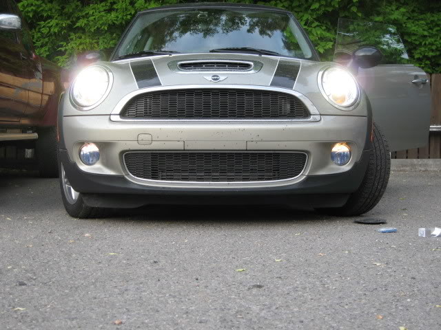

I painted the SS grille matte black. Much better, and tons of fresh air getting in now.
