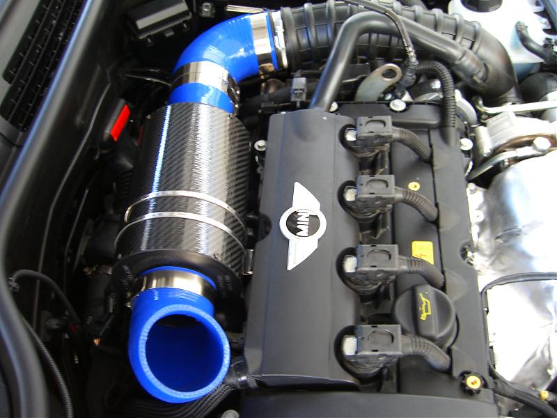

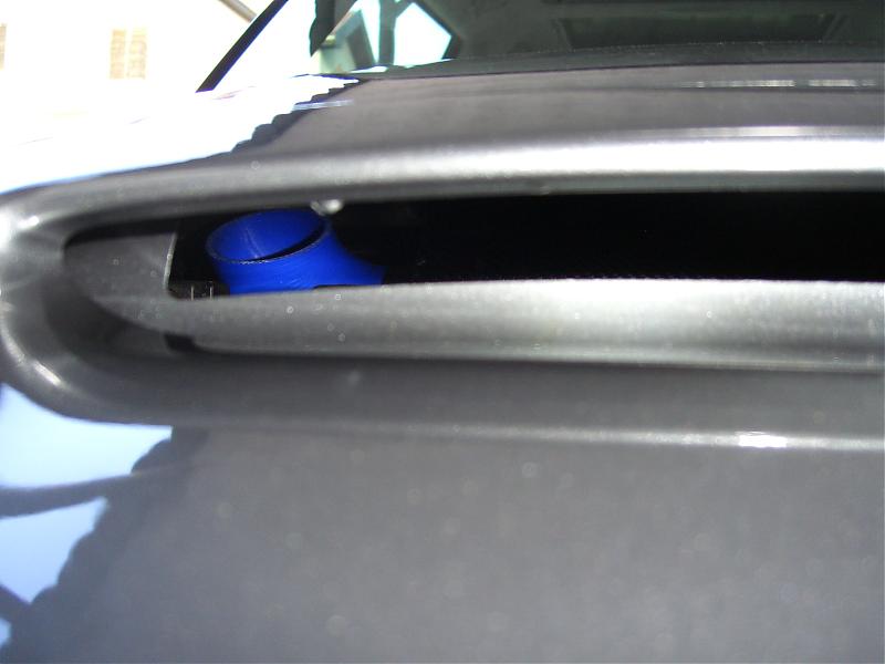

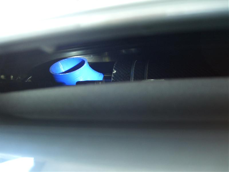

Here is my set up. I ordered couple of hoses in different variations to be able to make many configurations. The best configuration was this one which can breath cold air efficiently. I`m planning to take the entrance of the hose to the scoop as close as possible but this set up seems to be ok.

does the carbon fiber cylinder on Hattat's design have a filter in it, or is he running filterless?
Old May 22, 2007 | 12:33 PM
  #150
benfica09's Avatar
benfica09
Joined: Feb 2007
Posts: 221
From: NJ
pretty sure he's got a filter in there. would be crazy not to.
not sure what brand his is but it looks like the BMC-CDA CF box/filter.
