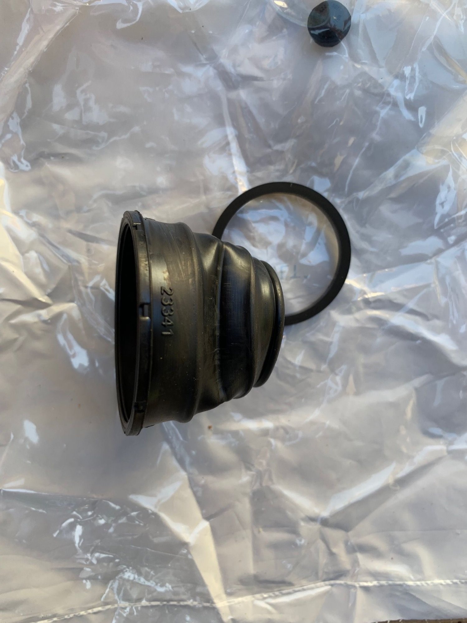

this is the rebuilding kit
consists of three things
the slider pins are in excellent shape and so are the rubber bushings
I actually bought a set of replacement rubber bushings but seeing the OE ones are in good shape I didn't bother to change them.
the dust boots are the only thing that became brittle and dried

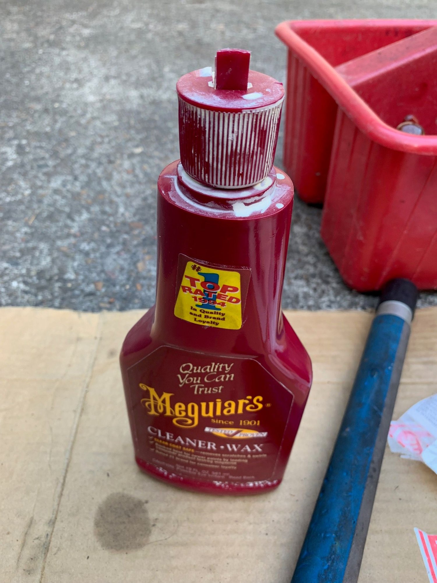

this piston has rubber residue that needed removing
I used this cleaning wax to remove the rubber residue; this only good for jobs like this
nice and clean and no rust

extracted the old piston seal; the new one is more supple and slightly larger
the just boot seats on the inner groove
I had a hard time seating the boot on this first side
this is the right way; fold the boot back until you retract the piston all the way before seating the big end

Thanks for the rear brake caliper rebuild. I have never done that.
Your piston is different from the R56 and the R56 doesn’t have the double groove on the end. The dust boot comes right up the end fo the piston.
Pardon my ignorance, but what does the broom handle do for you?
I do love the Wilwoods for rebuilding.
