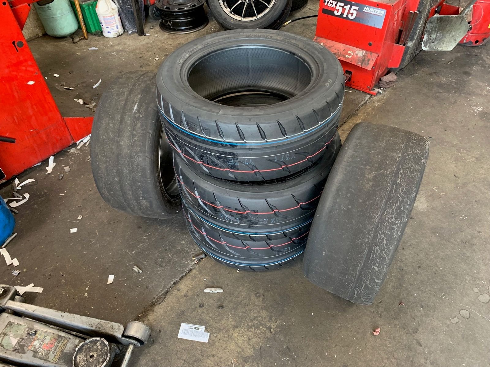

I just remembered that the race tire guy I bought my R888s from said that they can be run in either direction, no problems. Only the tread is directional. I would think that would be the same for the R888Rs.
Old Aug 11, 2019 | 07:56 PM
  #1929
pnwR53S's Avatar
pnwR53S
6th Gear - NAM Hall of Fame
Joined: Apr 2017
Posts: 3,967
Likes: 393
From: soggy pnw
Yes. That is the reason I like them. You just need to make sure to install the outside on the outside, and inside on the inside tire to wheel that is. I dislike directional tires as you cannot flip left side wheels to right side without remounting and rebalancing them.

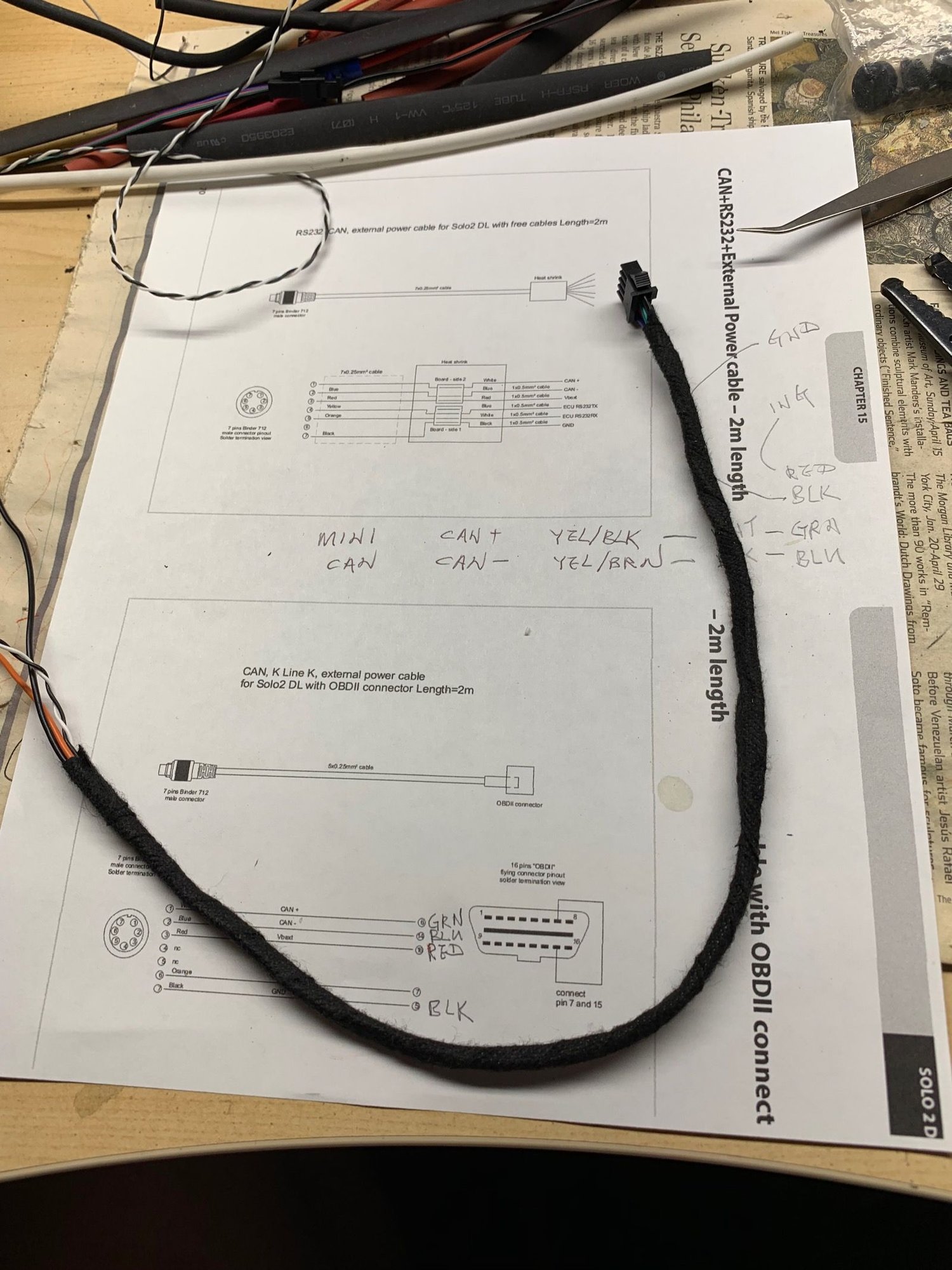

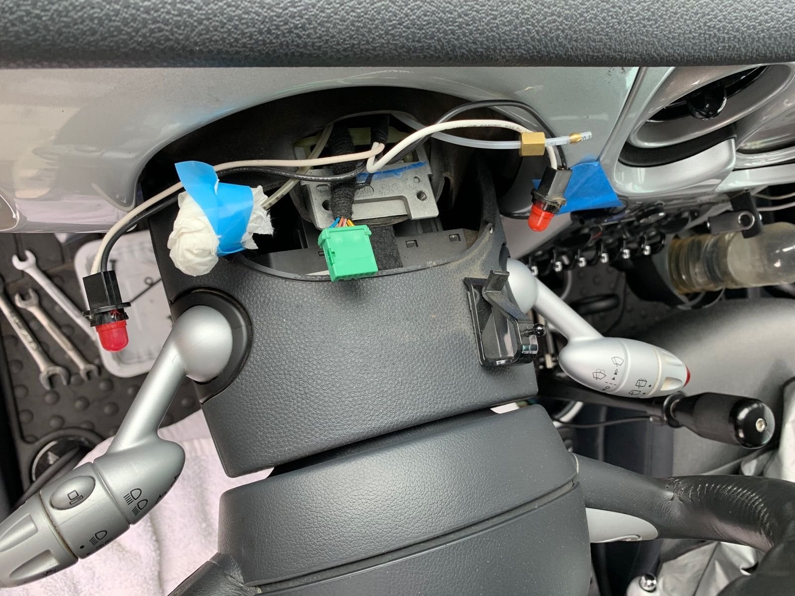

AiM Solo 2 DL and SmartyCam prep
As I have Desire and her sidekick GT4 as track cars I need to be able to quickly move the Solo 2 DL data logger and the SmartyCam between the two. I want the least pain way of doing this but without buying 2 sets of cables from AiM as they cost way too much. Also a long cable hanging around when not being use is a mess. Instead I fabricate my homemade interconnect pigtails to be installed in both cars. With a 4-pin connectors I can effortless move them between two cars. The interface for both cars are via the CAN bus so making them really simple. It can easily tucked away out off sight when not being used.
As CAN bus is higher speed differential bus with controlled impedance I made some effort to not cause signal integrity problem. I was going to keep the pig tail as short a possible but decided having a few inches hanging out a the back of the tachometer is too messy. I decided to place the interconnect pigtail in the European parcel shelf instead. For the Mini the CAN bus signal is easiest to access at the tachometer connector. But with the mechanical oil pressure and vacuum/boost gauges it is quite an involving job and requires extreme care so not to have engine oil over the cockpit. Failure is not an option.
first removing the tachometer and the mechanical gauge pod assembly
these two pressure lines requires handle with care
the green connector contains the CAN bus
I stripped back a segment of the fiber tape
the CAN bus is the twisted pair
I made a twisted pair cable out of teflon jacket MIL-spec wire which I happen to have laying around and spliced it with the short off the shelf pigtail cable
I covered the now longer pigtail cable with fiber tape so it looks factory; the power and ground were tapped from the center console which is a major PITA to get to them
the oil pressure line is one that failure is not an option so handle with extreme care
pressure tested the mechanical lines and no leak
Next is to modify the Solo 2 DL's cable by adding the mating pigtail connector.
I staggered the four splice joints
insulated the solder joints with heat shrink tubings
again the fiber tape gives a professional appearance
All the prep work for the Mini is done. Next is to configure the data logger for the Mini using a Windows PC.

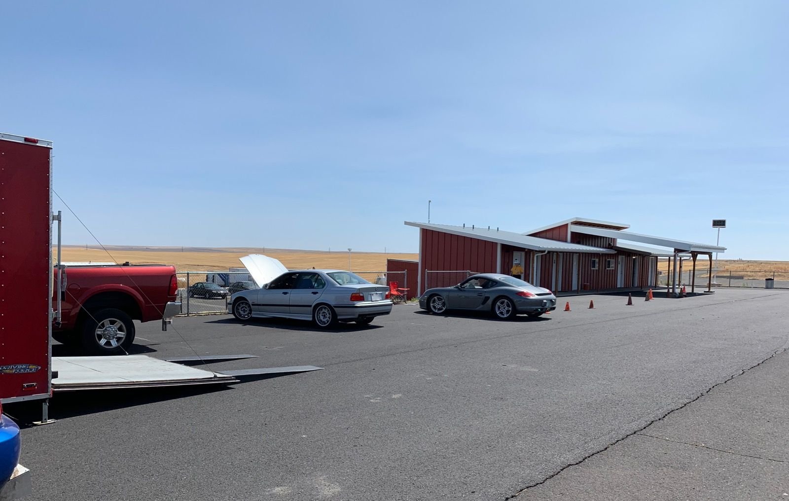

Our track team made it to the Little Brown Hell (die kleine braune Hölle).
Desire didn't fall off the wagon on the Oregon Trail; we have jet stream (Gorge's strong tailwind) to cut our travel time and cut the diesel bill
it is a sea of brown this time of the year at ORP; it is surrounded by farmlands with grain crops
Breezy and quite hot and dry. The breeze is nice to reduce solar gain of the motorhome.
