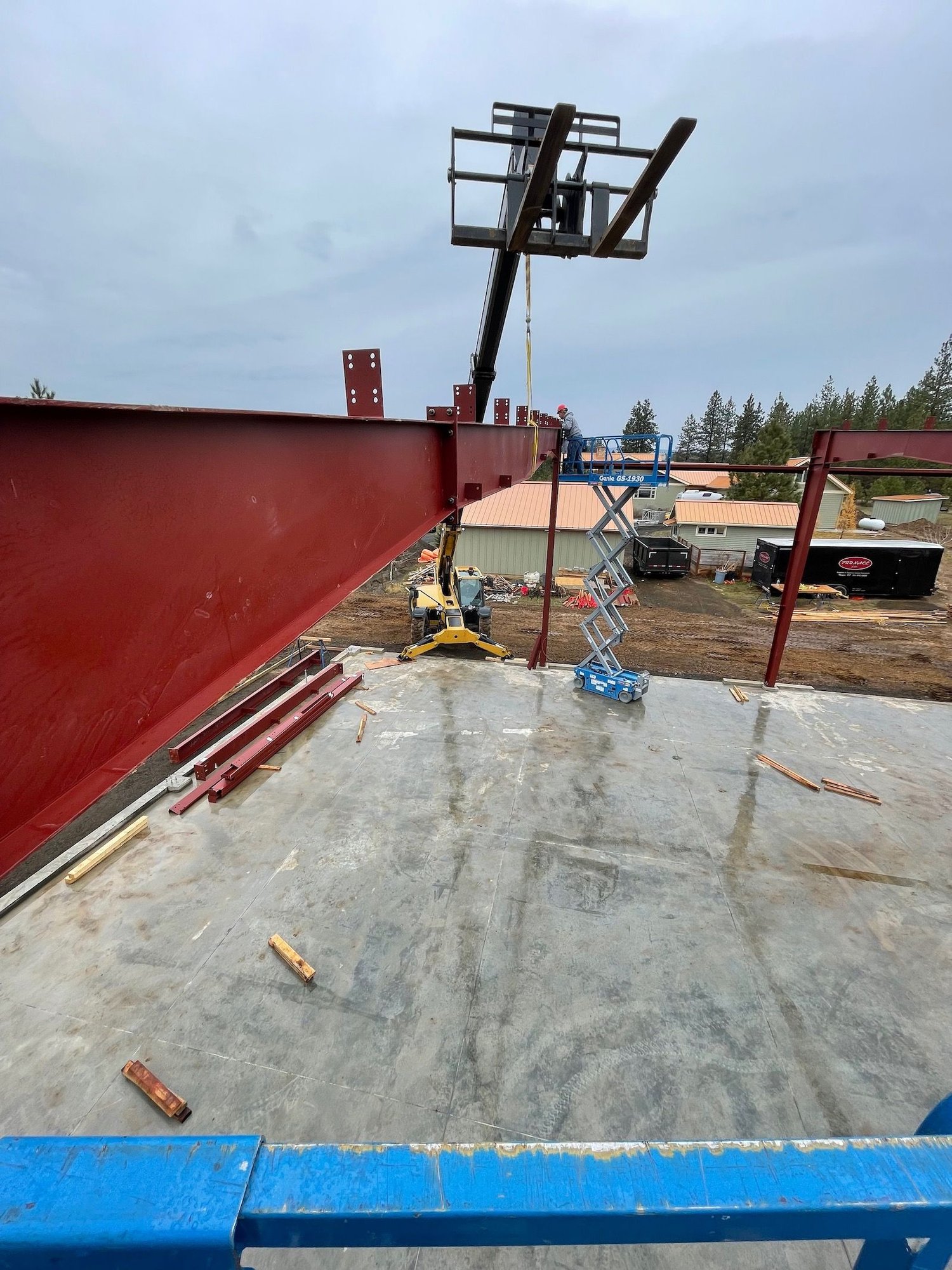

the barn progress
We are racing against the onset of foul weather seasons now, but the biggest relief is we able to avoid rain and freezing for the pouring of the big slab and stem walls all at once. Here is where we are at. The steel company folk'ed up on the anchor bolt holes WRT the drawing we relied on. Because of that I ran out and bought a plasma cutter since I plan to get one as soon as the barn is built.
while I have the excavators we dug many extra trenches for more yard hydrants and most exciting, bringing water and fiber optic to the cabin that is 630 ft away; I also prep it for a add on bath with running toilet and shower
this is the main trench that serves all the utilities to the barn and branch to the cabin for water and fiber optic cable; the junction box allows the three way fiber optic cable runs
the boom lift is a must and we don't yet want any heavy equipment on the slab
this is where we are at last night; there is a man door on the closest bay
my shiny new HF plasma cutter to cut new holes on 3/8" steel plates
instead of 4" on center they made the holes 3" on center; fixing them so to fit the studs already on the footing requires hogging out the holes to oval shape and cannot be done with drilling
We are at 110 cu yards of concrete now and there are still the apron on all three sides plus an expansive concrete pad on the front side of the building to pour.

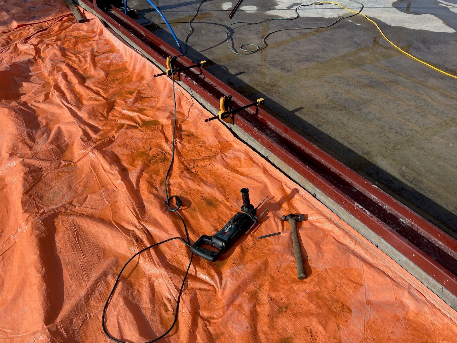

I want insulation around the perimeter of the stem walls to keep the heat in since I prep'ed for hydronic heat. The pipe insulation warped stub is the grounding rod to protect it from the apron's concrete soon to be poured.
I tasked myself to cope the base channel around all the posts and door openings, as I want them to be neat and tidy.
I used shallow cut and managed to use one thin cutting disc for all these cuts.

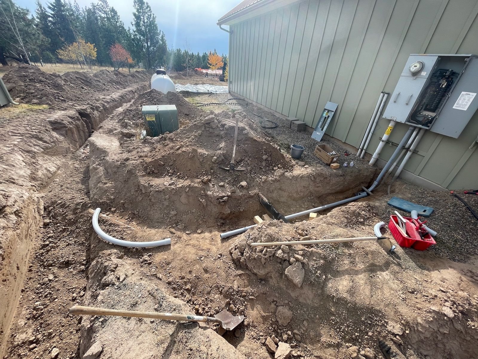

I cut a new hole for the 2" conduct at the 200A main breaker behind the three car garage. It can send up to 125A service to the barn.
I managed to keep the 2" conduit bends at 360 degrees total
I also mapped out how to run a generator feed to the house while also feeding to this panel using existing conduit the PO provisioned for other purpose.

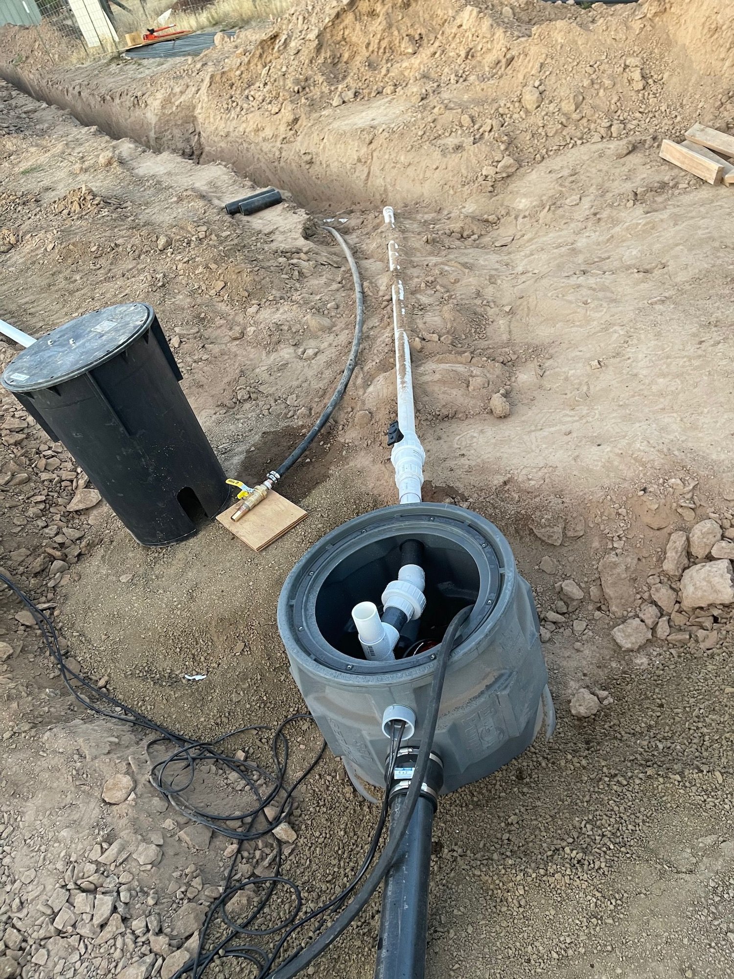

this is a pump sewer basic for the barn which pumps the sewer uphill to the septic waste pipe at the main house
the pump basin with the riser cover removed
you can see the 2" pump sewer line going uphill towards the main house

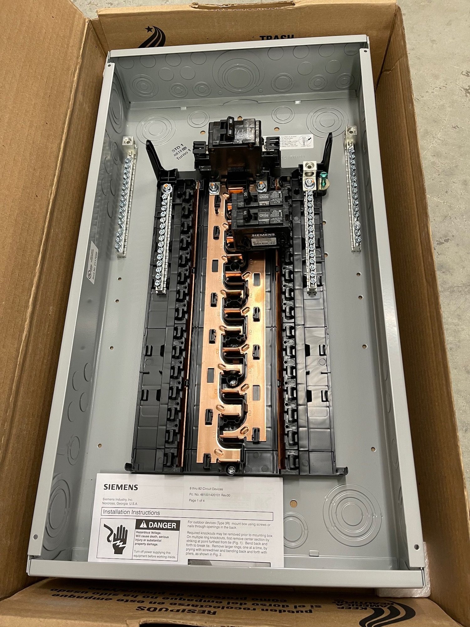

this 100A sub panel may be upgraded to 125A

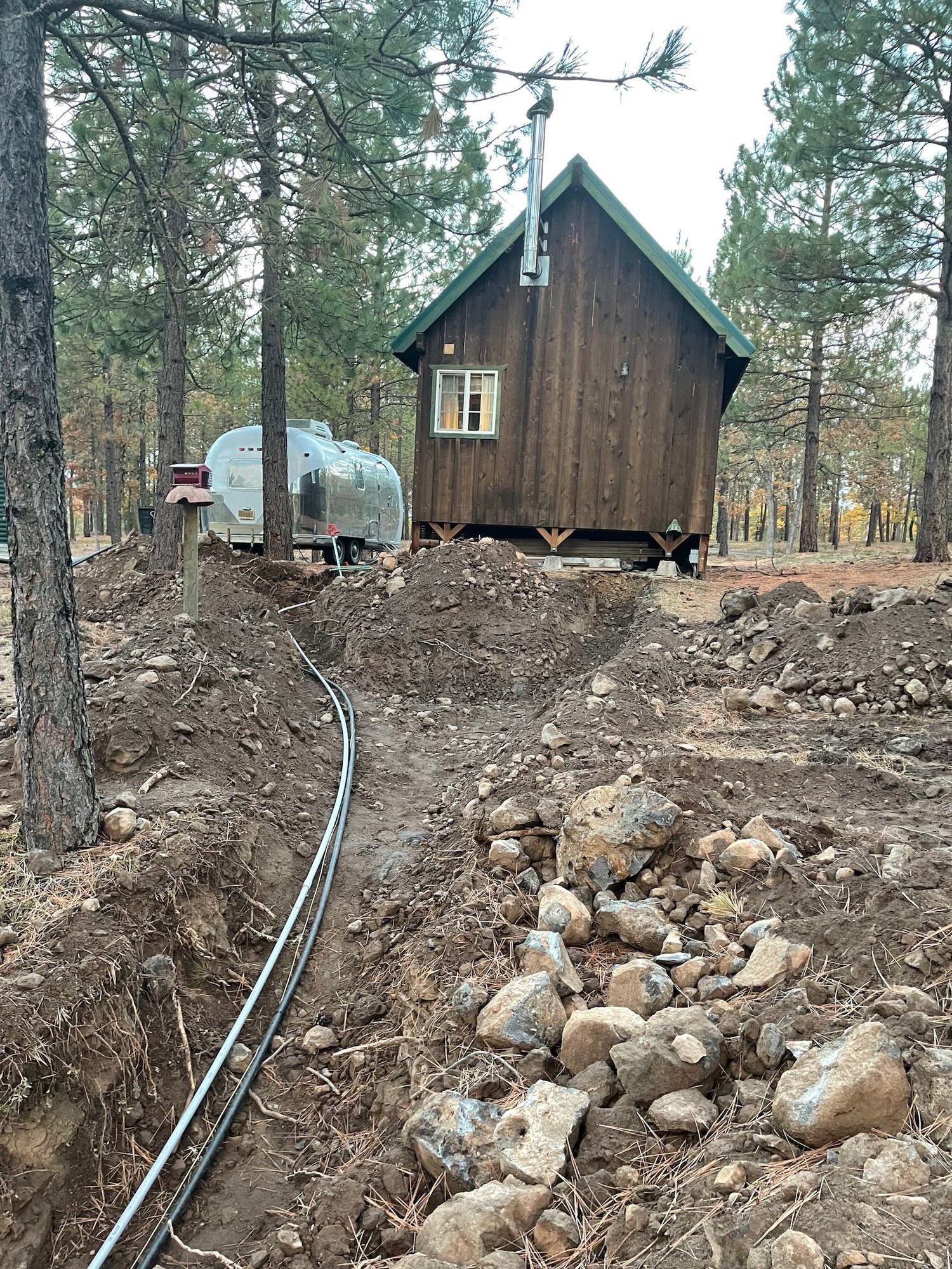

this T junction for the water line to the cabin that is 630 ft away down hill. I later install a shut off valve at this junction in case the cabin branch is compromised.
