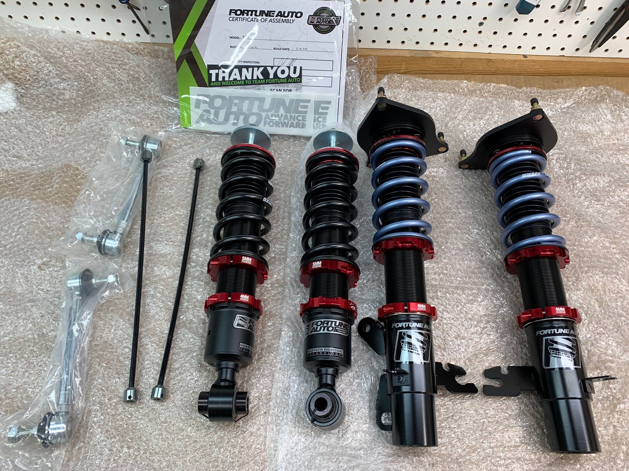

Fortune Auto
Big white truck showed up today.
r53 Fortune Auto 500 series
Ordered these on Black Friday, yes November, and they just arrived. Evidently Fortune Auto gets a lot of orders on Black Friday!
You are probably saying why the blue springs??... turns out the 6K springs for the front are only available in blue. Rear I was able to get black.
So I'm thinking of starting a Fortune Auto Thread in the Suspension folder??
There doesn't seem to be much info out there for the r53 and for the price point and value... Fortune Auto seems like a viable option for the r53 that is slooooooowly becoming more of a track car.
Front 500 Coil overs with Adjustable Camber plates and 6K Swift springs.
Rear 500 Coil overs with 6K Swift Springs
Front adjustable end-links come with the package.
Rear Adjustment Extenders
Black Friday Discount... just a hair over $2K

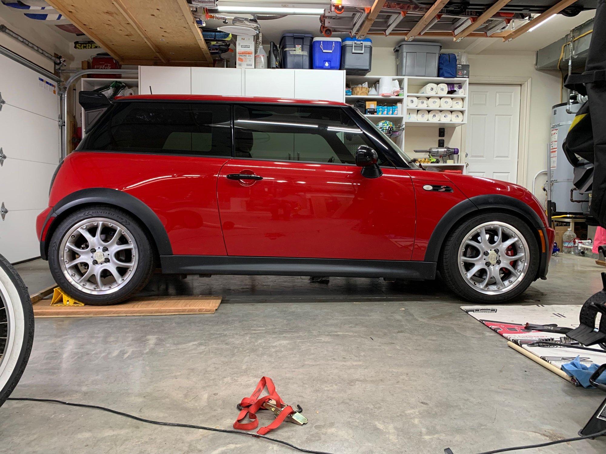

Took me 6 days but I finally got the Coilovers installed. I'm doing a full write-up with all the pictures and details here:
https://www.northamericanmotoring.co...nd-review.html
After about 4 adjustments this is roughly the ride height I ended up at.
3/4 of inch down in the front and 1 inch down in the rear. *plywood is to level the floor of my garage.

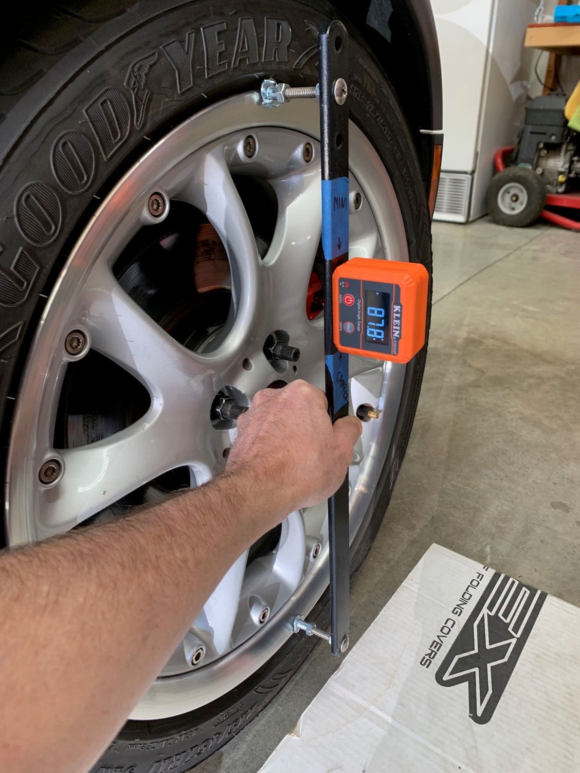

Made a handy contraption to set my camber up. I think the bar is from a garage door kit. 1/4 bolts with some wood insert nuts.... I can adjust them in and out, then lock them with the nut.
Klien digital angle finder has a magnet on the bottom so snaps right to the steel bar. Works great.

Hey! That’s my idea!
Nicely done!
I used my an app on my iPhone, but it was a bit finicky…

I probably saw your version at one point and tucked it away in my brain somewhere.... Popped into my head this last time I did my own alignment.

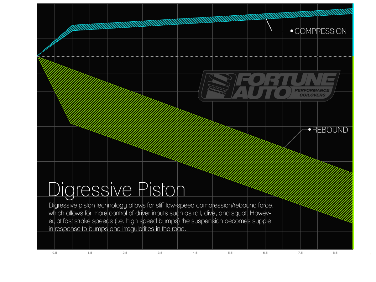

I think our disconnect is in the difference between compression damping and rebound damping. Maybe someone else with more knowledge can set us both straight.
The entry level coilovers from BC, KW, Fortune, ST etc...... the adj dial controls rebound with very very little affect on compression.
Excerpt from the second article above.
Finally, we are getting on the subject of damping adjustment, many people don’t realize that adjusting the damping isn’t making the suspension itself softer or harder. This is not how damping works. Damping is something that delays weight transfer and or slows down the suspension’s movement, this can be perceived as stiffness or softness but it doesn’t actually change the spring rate of the suspension or the suspension’s steady state characteristics. Most decent single adjustable shocks have the adjustment affect the rebound damping.
This is the concept that I'm tackling now. Rebound damping. In addition this article says the adj **** on these coilovers primarily control the low speed rebound damping. Which in the picture above from Fortune shows that it affects all the way out to high speed. Still researching this.
This is where these 6 rear rebound adj come from in the article.
In thinking about the adj for low speed rebound, I feel like I need to look at places on the track that the F & R suspension is unloading (rebound) and controlling the rate at which it unloads, or pushes back. For example, more rear damping on hard braking would slow the rear of the car from lifting which the Mini does with the light rear end and thus reduce brake dive. But eventually the spring (I'm assuming this would include sway bar in L to R applications) pushes through damping and the rear of the car comes up.... but controlling that rate is where my mind is at.
I'm still trying to wrap my head around this and the whole article from above......I'm sure it's going to take some time.

Actually only half right; the first sentence.
In your quote from Fortune about shock:
The “perceived” is what the car is reacting to in a dynamic situation. There is a physical stiffening of the suspension when the rebound is stiffened. That is, the spring has compressed and the shock is now preventing the spring from releasing at a particular instant. Therefore any further compression has to overcome any current compression. For example, if the spring has compressed an inch, it has a 600# load in it. If it is asked to compress another inch it would take another 600#. So, in effect at the first inch the spring rate is 1200#/in. That is what the car sees at that instant in time. This is why the “perceived” stiffness is stiffer or softer with changes to the rebound, and this is why, in a fashion, dampening can be used to control the roll stiffness of one or other end of the car.
This is also why “stiffening” the rear shocks will not help with preventing the inside rear wheel from being lifted.
In a dynamic situation, think of “changes” to the car in relation to what it would take statically to achieve the same result. In a right turn the front left of the car will dive. It happens as if weight has been added to that corner. However, there is a finite amount of total weight to be had and it can neither increase or decrease. So that weight has to come from somewhere. It comes from the rear, diagonally across the car. That is, the inside rear wheel and unsprung part of the suspension. As that wheel loses “weight”, the available traction from that tire also decreases.
The more quickly that happens, the more quickly the rear of the car looses traction. A stiffer rear sway bar, the quicker the roll of the car will lift that tire. Same with increased rear rebound dampening. The spring is prevented from pushing that wheel down and keeping it on the pavement. Hence a tendency towards oversteer.
That inside rear wheel can be prevent from lifting by increasing the roll stiffness of the front of the car, either by a larger/stiffer front sway bar and/or stiffer front springs. And/or softening the rear shocks. The net effect is to reduce traction in the front of the car and increase it in the rear. Hence a tendency towards understeer. Adjusting the front shock will have little affect on the rear of the car as it does little to reduce compression.
This is also why it is important to balance the roll stiffness of front to the rear of the car with the sway bars* first, and then fine tune the balance of the car with the shocks. That is, there is only so much “stiffness” that can be removed from the rear of the car using the shocks adjustment to balance an overly larger RSB to a “small” front sway bar. Which is also why I advocate use of the smaller bar in the rear to balance the front stock bar.
*I will add that some people like to control the roll stiffness of the front of the car with stiff springs in the front vs a large sway bar. A sway bar reduces the side to side independence of the suspension and the stiffer springs tend to better retain that independence and they prefer the indecency of the front.
Hope this makes sense.
And I think this contradicts item #1. But not sure. It all depends on how Fortune defines the terms they are using. Feel free to let me know what you think. But this is what I have learned from setting up my R56 MINI and helping others with theirs.
